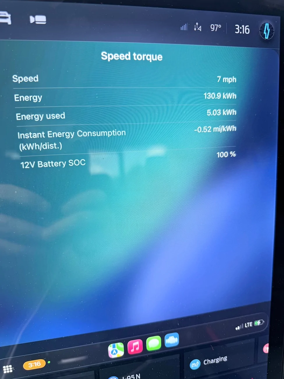

I decided to use the Car Scanner app to see if I could gauge how much bonus juice you get when you charge to complete 100%. I’m sure everyone has had this experience of starting out at 100% and you’re driving for what feels like 20-30 minutes and it’s still at 100%.
Full charge SOC reading:
131.07 kWh
Energy used/driven until it finally started to dip below 131.07 / 100% SOC on the dash
~5 kWh
So in reality, it seems the extended range starting point is actually closer to 136kwh. Is this pretty much what others are seeing?
I took a pic of the energy used during the drive as it just started to dip below 131.07 (which it held for about 12 miles).
Ford F-150 Lightning Bonus KWh when fully charged to 100% IMG_6001

So here's my theory, and fair warning, it complicates that clean 136 number a little.
The 131.07 the truck shows you is the usable nameplate figure, not a live readout of what's actually in the pack — gross capacity on the ER is somewhere around 144–145 kWh, with roughly 13–14 kWh of buffer split top and bottom. So that ~5 kWh you burned while it sat pinned at 100% is coming out of the top reserve that normally lives above the displayed ceiling. You're not starting at 136 in any way you can plan around; you're catching a peek at the buffer because the gauge holds at 100% coming off a full balance charge. (FWIW there's a thread on here where someone ran the same test and calculated ~134.5, so you're right in the expected band — nothing weird going on.)
The more interesting part: I think Ford progressively releases that hidden reserve as the pack ages, so the reported capacity and range stay high even as the cells quietly lose a bit underneath. That's a theory, not confirmed by Ford, but it lines up neatly with the 3-year range tests showing negligible loss.
There's also genuine SOC drift in play. Coulomb counting accumulates error over partial cycles, then the BMS recalibrates whenever you take it to a true 100%. So if you mostly charge to 80–90%, a little drift creeps in, and the next full charge snaps it back.
And underneath all of it is the Mr. Scott methodology: "A good engineer is always a wee bit conservative, at least on paper." The truck says 100% when the battery says it's still got room for more. 😉
This is good info thanks. At the end of the day I’m glad Ford built such a huge buffer on this battery pack and went with the Mr. Scott methodology. It does seem like this could be a way to hide age related degradation over time (on the battery, not myself unfortunately).

So here's why I disagree that Ford is releasing capacity as time goes on.
Yes, my Lightning battery is close to 100% after 4 years and 23,000 miles. On 3/20 it was 100% at around 22,000 miles.
But, my 4 year old Mach-E was 96.5% last I checked, but has been down to 94.5%. If Ford was releasing capacity, why is it also not at 100%?
@Aminorjourney, Ford's former VP of EVs, Darren Palmer, said a lot of things that Ford never did, including releasing more capacity based on usage (take good care of battery, you get more, take bad care, you don't), and changing charging curve for some and not others.
I believe that Ford may release capacity as a battery nears the end of its 8 year / 100,000 mile warranty if it is below or near 70%, to avoid a warranty claim.
But, I believe the reason all Lightnings have higher SOH than all Mach-Es boils down to:
- different battery packs
- different sensors, HVBJB, etc.
- different battery calibration methodology
On the Mach-E forum, Mach-Lee says "The SoC meter has hysteresis at the top end of the charge range. Has to do with the top buffer and the way the BMS estimates state of charge."

As the battery warms, it's internal resistance lowers and the capacity appears to change and the BMS displays that.
The SOC fluctuates with temperature. Colder a lower SOC reading, warming higher SOC reading.
A similar thing happens right after charging - as the battery cools, the SOC reading may drop a few percent.
The stated usable capacity, e.g., 131kWh, is measured/determined at a temperature of 77F (25C) degrees allowing for top and bottom buffers (included in the gross capacity).
