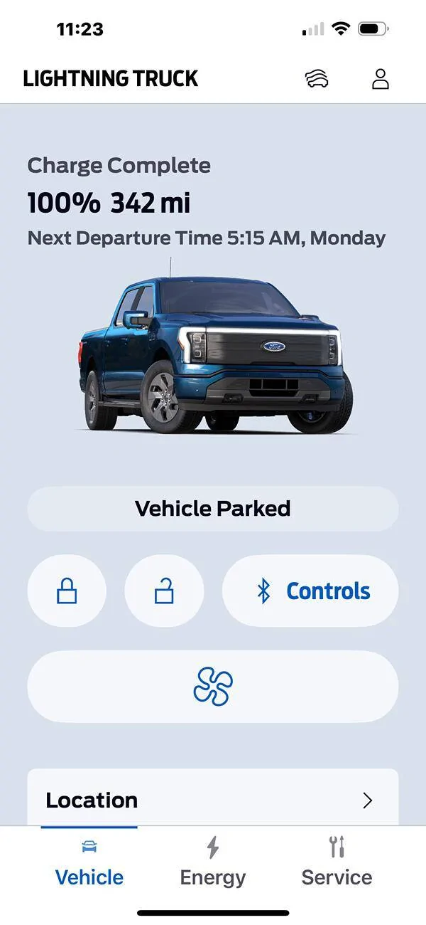

Today was the day to try again to duplicate the increased range at 100% while charging at home.
If you remember, I was the one who posted that my 3 year old Lightning charged to 345 miles of range at 72deg outside temp.
Today I had almost identical temps, 68deg, and the charge reached 342 miles.

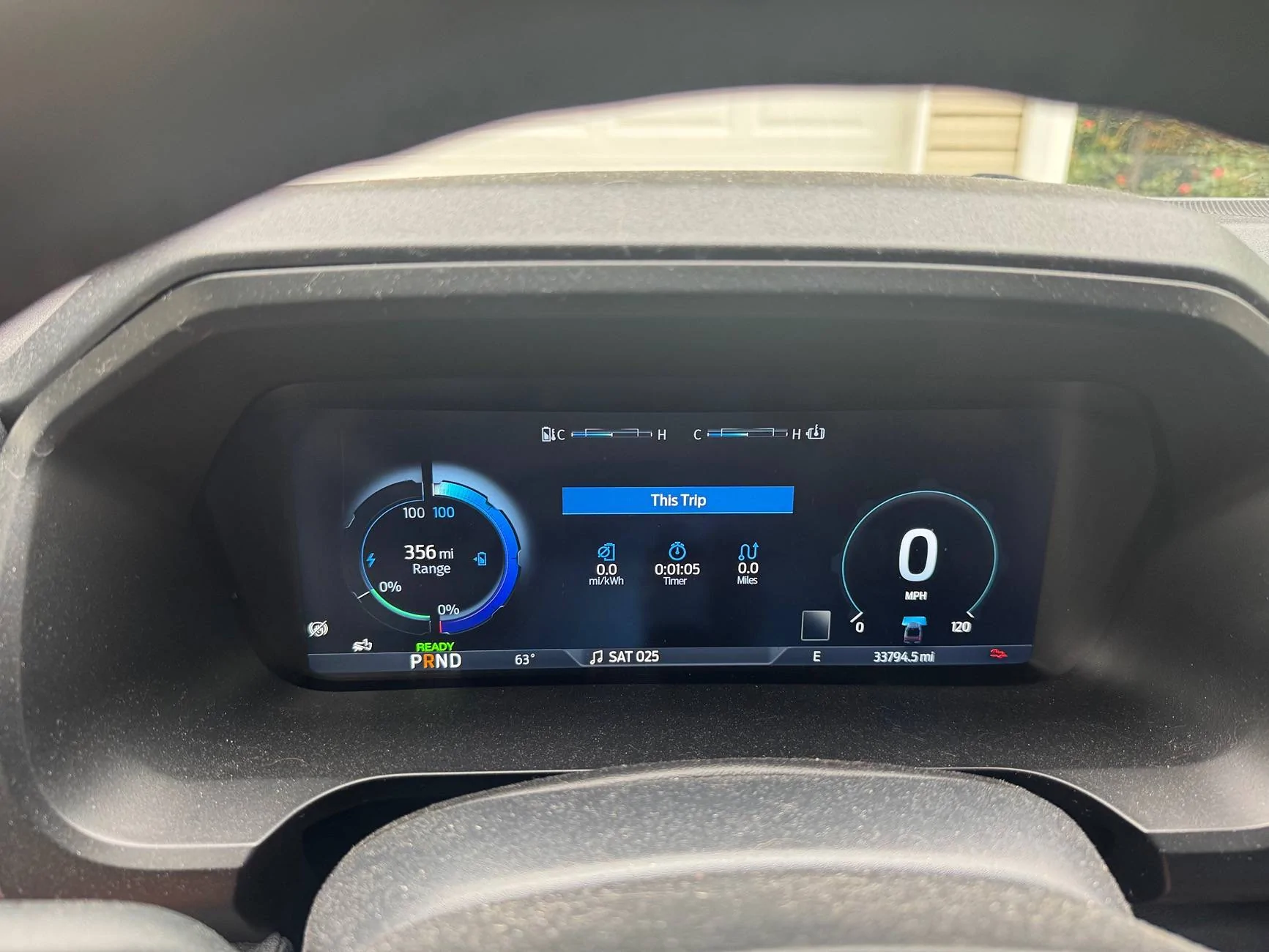

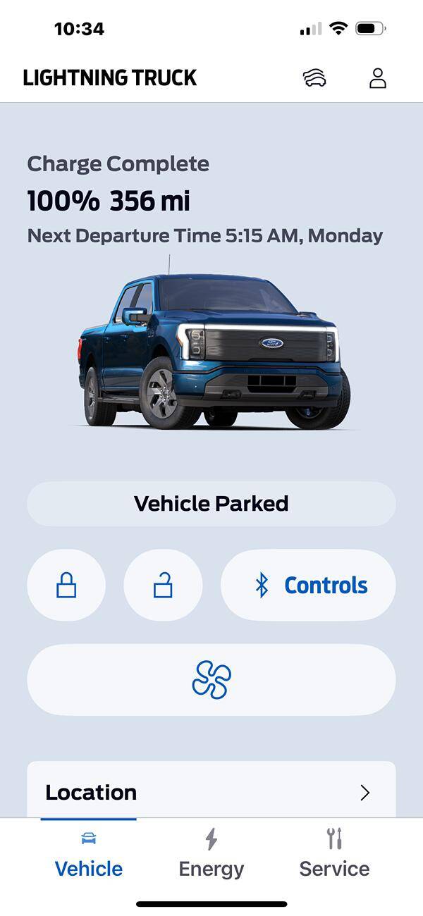

This is getting interesting. This morning I charged the Lightning to 100% to see what was going to be the range.
Outside temp was 63deg and at full scale I saw over 350 miles range.
356 miles to be correct.
The Lightning is 3 years old.
Either Ford released some of the reserved battery or they changed the algorithms.
