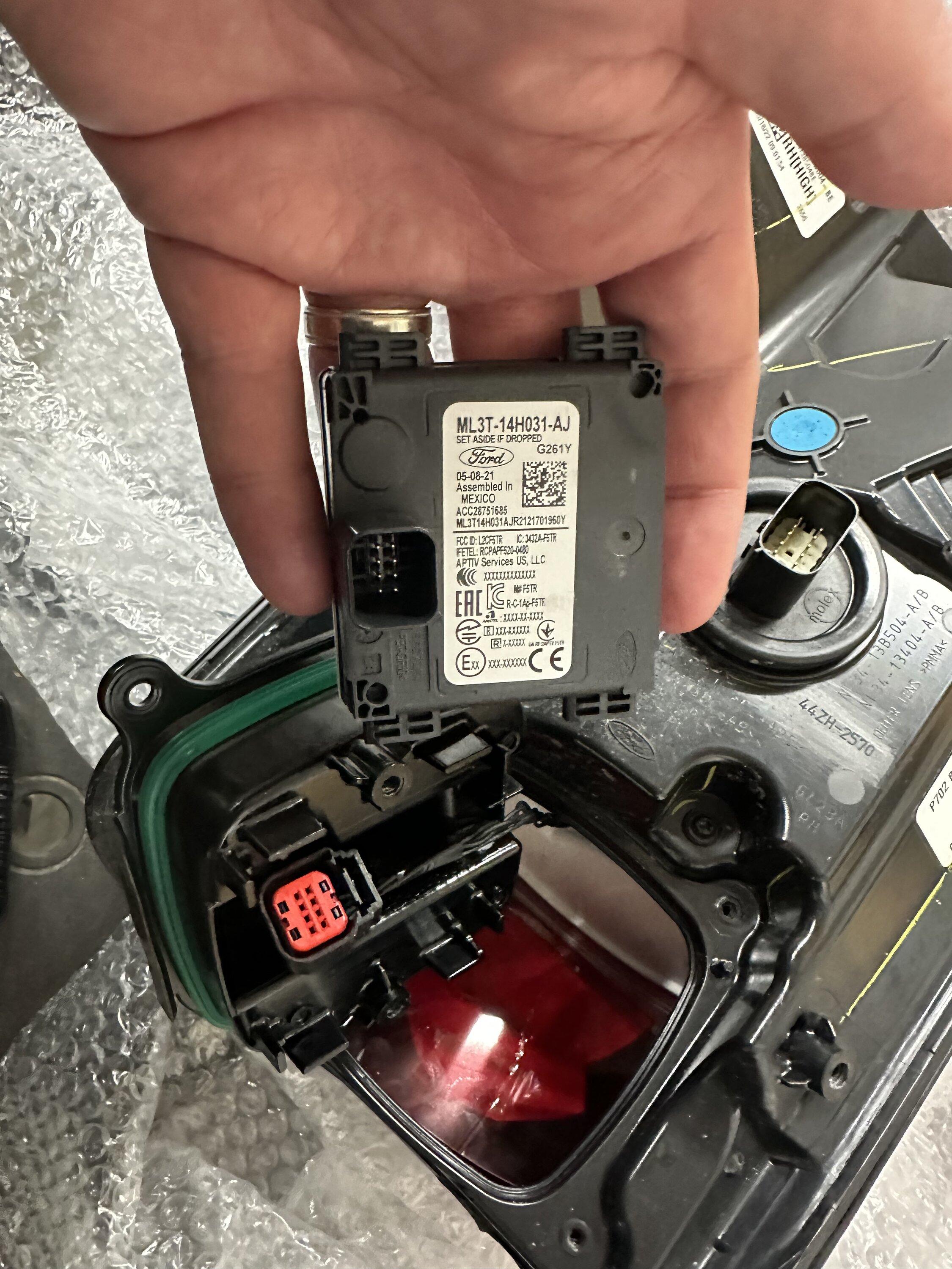

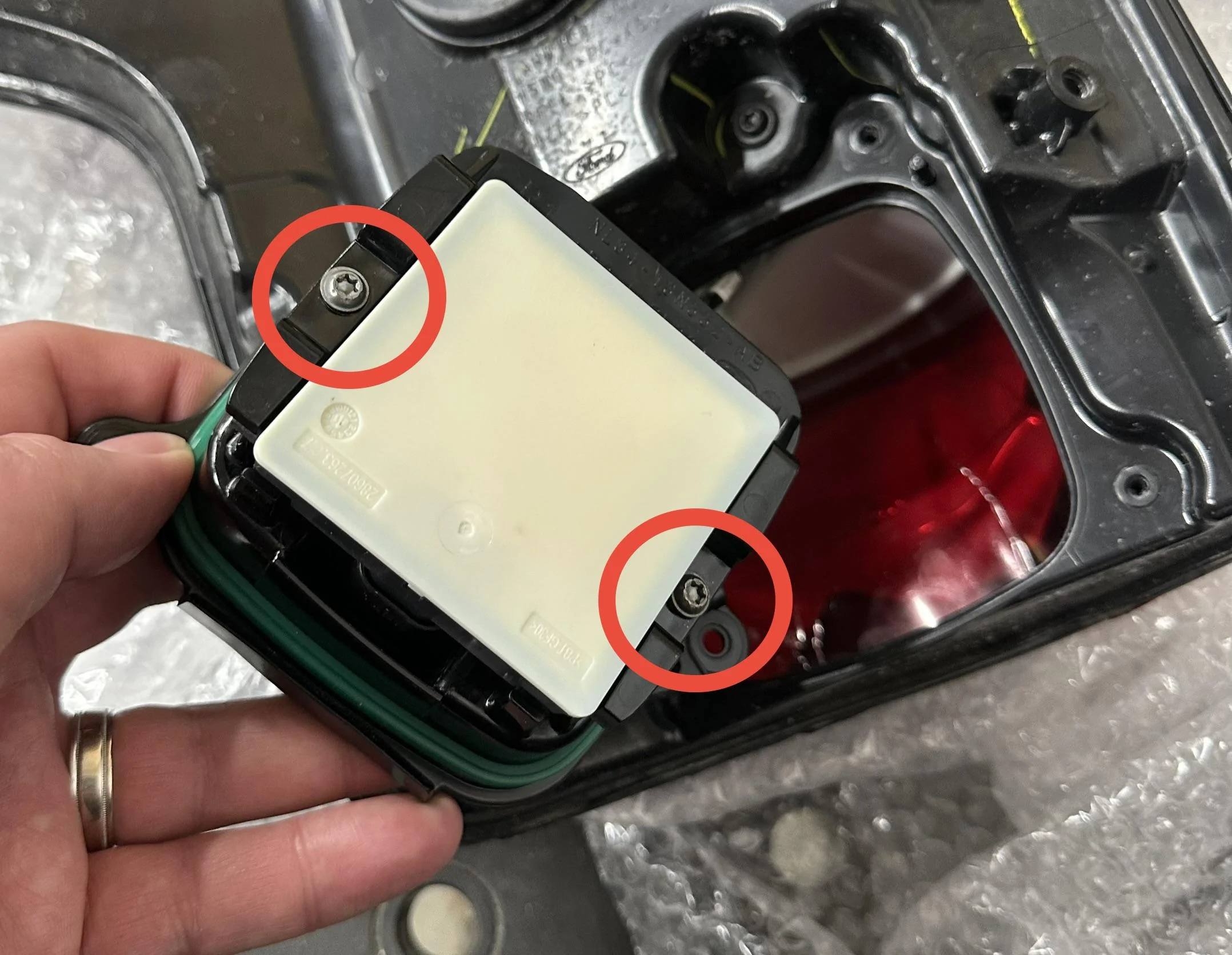

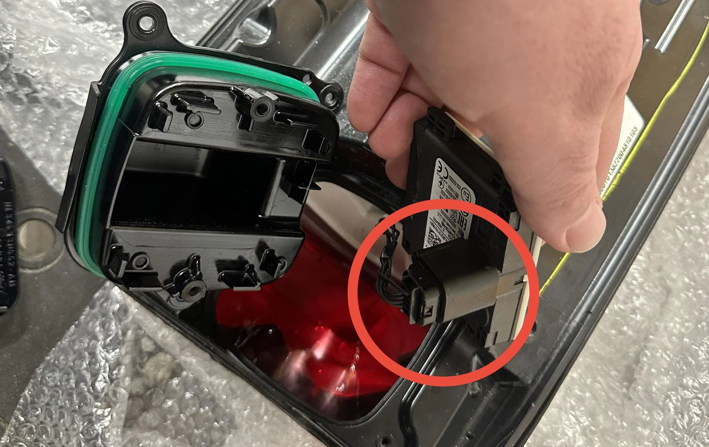

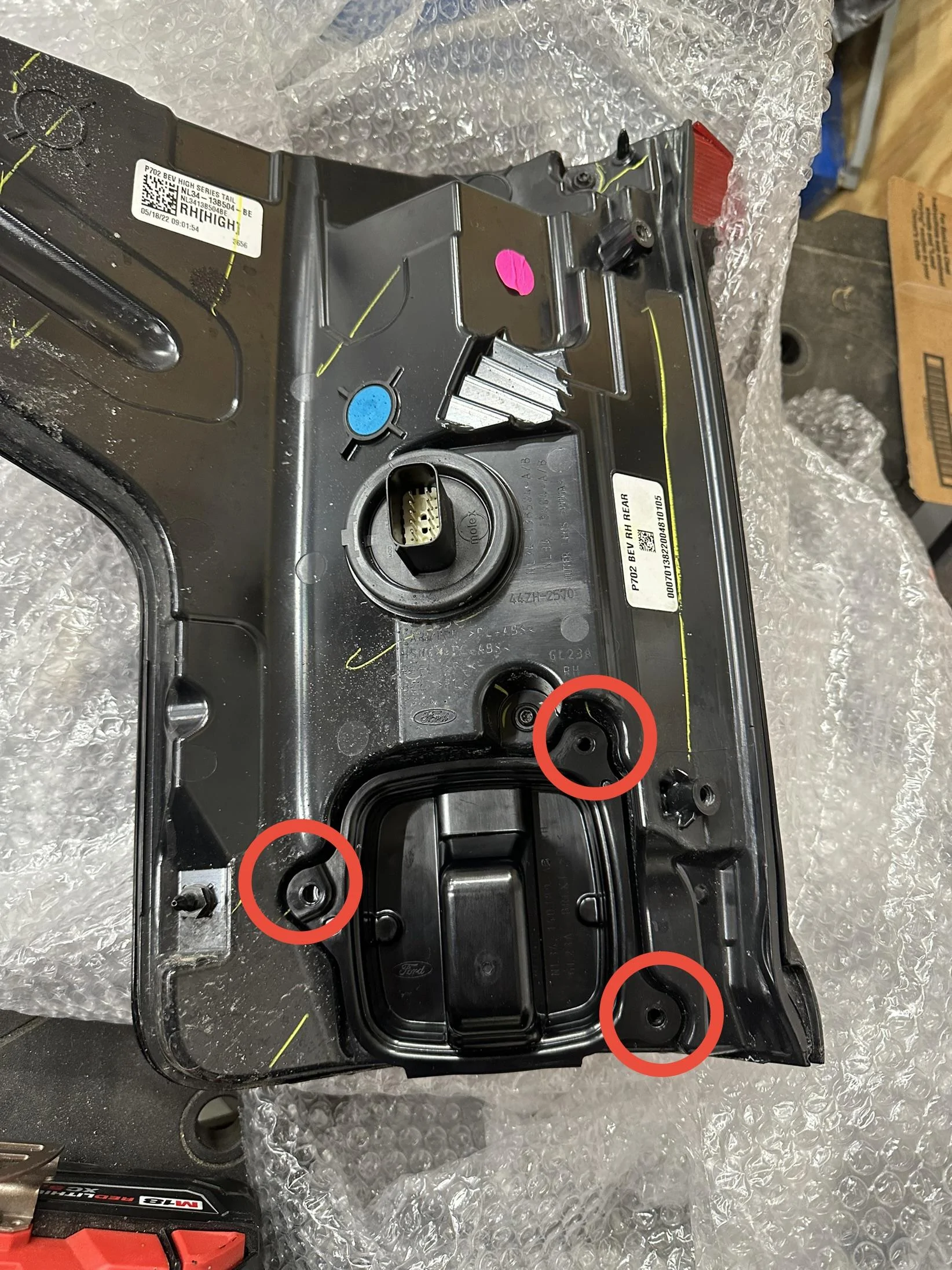

Finally found and got a new tail light from eBay and did the install today. I moved the blind spot from my broken tail light and everything works perfectly (no programming needed).
To move the BIS system:
  1. First you have to undo 3 t-25 screws on the back of the tail light
  2. Then pull out the module and then remove the 2 t-25 hold down screws that keep the module against the cover plate.
  3. Then you remove the plug.
  4. Once out, you just repeat the same process on the replacement light
