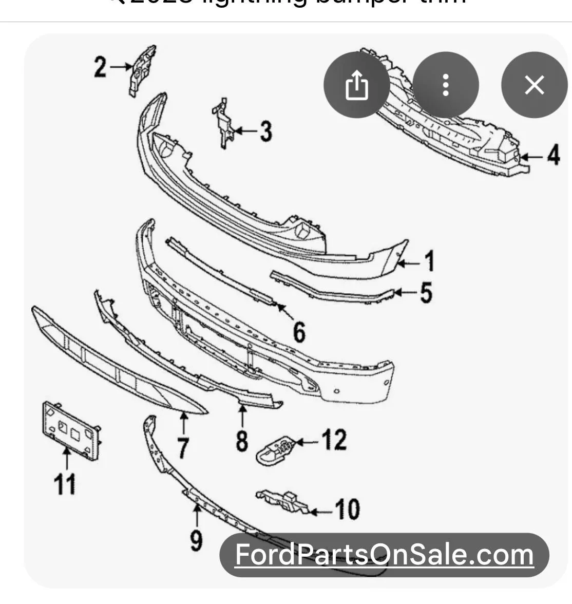

2023 Ford F-150 Lightning Lariat ER
Needing to replace this piece on my Lightning. #8 in the diagram. I can easily get to the top clips by removing #7. However, the bottom of #8 remains locked in place in between the metal bumper and the top of the air dam. There are no clips in the bottom of #8, only rectangular holes. Anyone ever had this apart that can assist?

Thank you - not wanting to take off the whole bumper though, I believe this trim should be removable without that.
3,256
4,737
In looking at the shop manual, almost everything starts with removing the bumper. I will send you some info via DM.

I had to replace part # 7 in your diagram after hitting a deer. I found a YouTube video on removing the bumper which is what now must do in order to access parts 7 or 8. I wasn’t able to find the link to the video when posting this.
