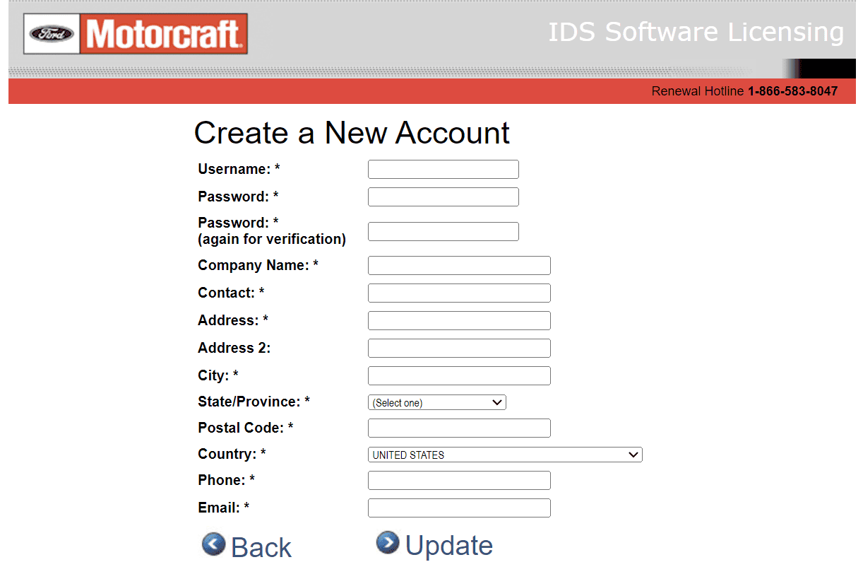

After I activated FDRS with the 20-character code, my initial problem when logging in was that a gray dialog box would pop up saying that the FDRS servers weren't available, but log in anyway to work offline with limited ability.
A Microsoft copilot search revealed that was a common problem encountered on Ford forums, saying some users had fixed the problem by reinstalling the software. Others also recommended turning Windows Defender off during the installation process. Since the installation files had been scanned with Windows Defender both in download and during the first installation attempt with no problems noted (except for restricting firewall access to publically configured networks), I reinstalled ("overinstalled") both the VCI and the FDRS software, doing the VCI overinstall BEFORE FDRS instead of after as the Helm, Inc. instructions suggest for the de novo install. Then, the login dialog for the Internet worked when I tried to log on as an "Independent Operator/Non-Dealer." But proceed at your own risk if you decide to follow my example. After I found my FDRS installation could connect to the Internet and furnish a Ford login page, I turned Windows Defender back on.
I then had (and still have) the problem that Helm, Inc. had allowed me to create account credentials that don't work with the FDRS login with Ford servers. It seemed that with Helm account creation, a Username can be a character ID and doesn't have to be an e-mail address. An e-mail address is only explicitly asked for as the last field entry in the Account Creation dialog:
Ford F-150 Lightning Can't log into FDRS 1720767801087-a9
But when you get to the FDRS login, an e-mail address is expected as the username. If you enter anything that's not an e-mail address, the web form complains about an invalid entry. I had decided that I didn't want to give Helm, Inc., my Ford account credentials. Things probably would have worked out better if I had. Ford has a "Single Sign-On Page," but it must be for dealers and Ford employees. I can't sign in to try to merge accounts with either my Helm, Inc. account info or my Ford account info. Since the Single Sign-On appears to be MS Azure-based, the laughable thing is the e-mail part of that portal recognizes my MS 365 e-mail address but won't let me sign in since that's not associated with any Ford-related account...
