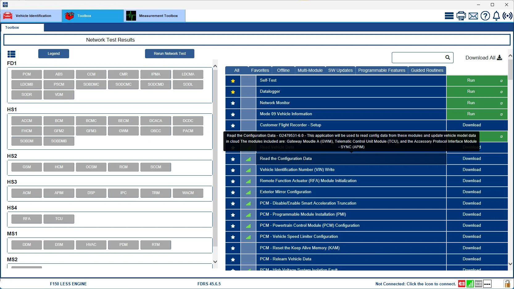

I never noticed that additional bit about it only reading the GWM, APIM, and TCU modules until I went back in and put my mouse over the tooltip. I thought it was reading everything. Ahh well....
Ford F-150 Lightning Can't update SCCM Read_Config_Data

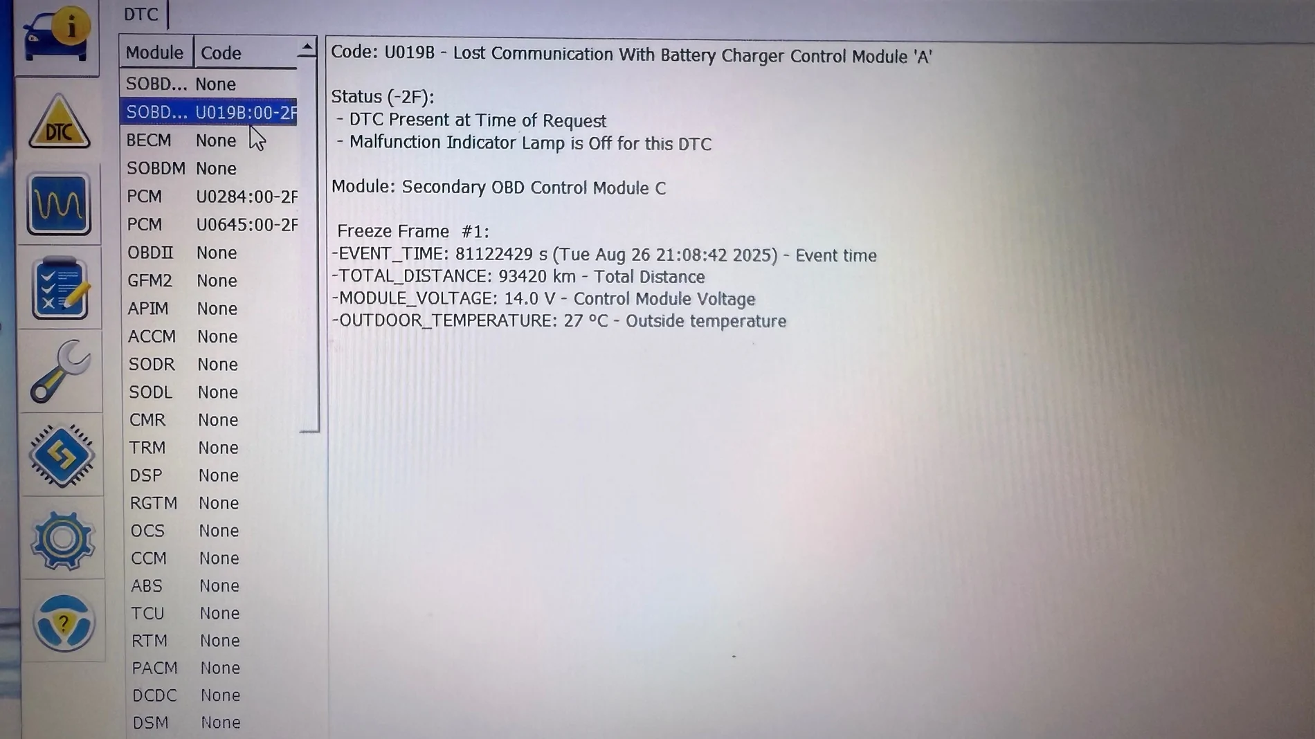

Hey @rugedraw and @Jesse-Infotainment you guys are great. I just finished configuring with forscan the IPMA and IPC to enable glare free (those two module I guess went back to the AS-Built), then cleared the DTCs and re-read them and the 2101 DTC in the SCCM module is gone! Thank you very much, with that I guess I can now updat the SCCM module. Hopefully I’ll buy a 2 day license over the weekend and update the module. All I’d be missing is the BCM module but I guess I will have to talk to the dealer for that.
Here is the screen shot of my DTC. I’m still getting the U023A in the SCCM Module but that shouldn’t be a problem to update right?
Again thanks for the help of everyone that chipped in!
Ford F-150 Lightning Can't update SCCM IMG_8669
Ford F-150 Lightning Can't update SCCM IMG_8668
rugedraw
Javier
Dec 14, 2021
1,920
2,364
Miami
Auto Sales
I would just try to update it to see what happens and take it from there.
