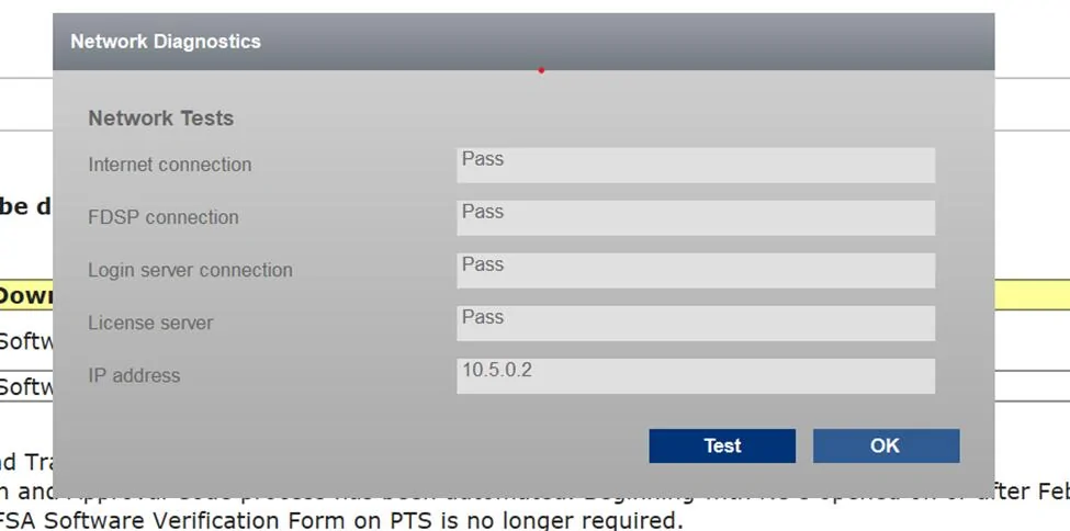

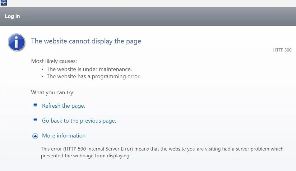

I have a 22 F150 Lightning platinum. I bought the Opus Mongoose latest version Ford adapter. I've downloaded FDRS and paid for a license. I've gotten FDRS to recognize the mongoose, show battery voltage and that it's connected to the car. I've also passed all the network diagnostics. When I login with my ford credentials via independent operator/non-dealer with my regular ford email/password I always get a website cannot be displayed error. Following other threads I logged into the ford account manager indepdently and left the browser open while attempting to login via FDRS. I have rebooted many times, uninstalled/re-installed the software and am currently running an older version of FDRS as some said that was better for first time logins. No dice.
Is there actually a server issue currently? Assuming there is not.. what else can I try? Thanks

It's working now. Either there was an actual server error or some randomness worked. I tried turning off windows defender, restarting, running the old version as an admin & then it gave me a different error than it normally would. From there I updated to the most recent version and tried again, it worked.
