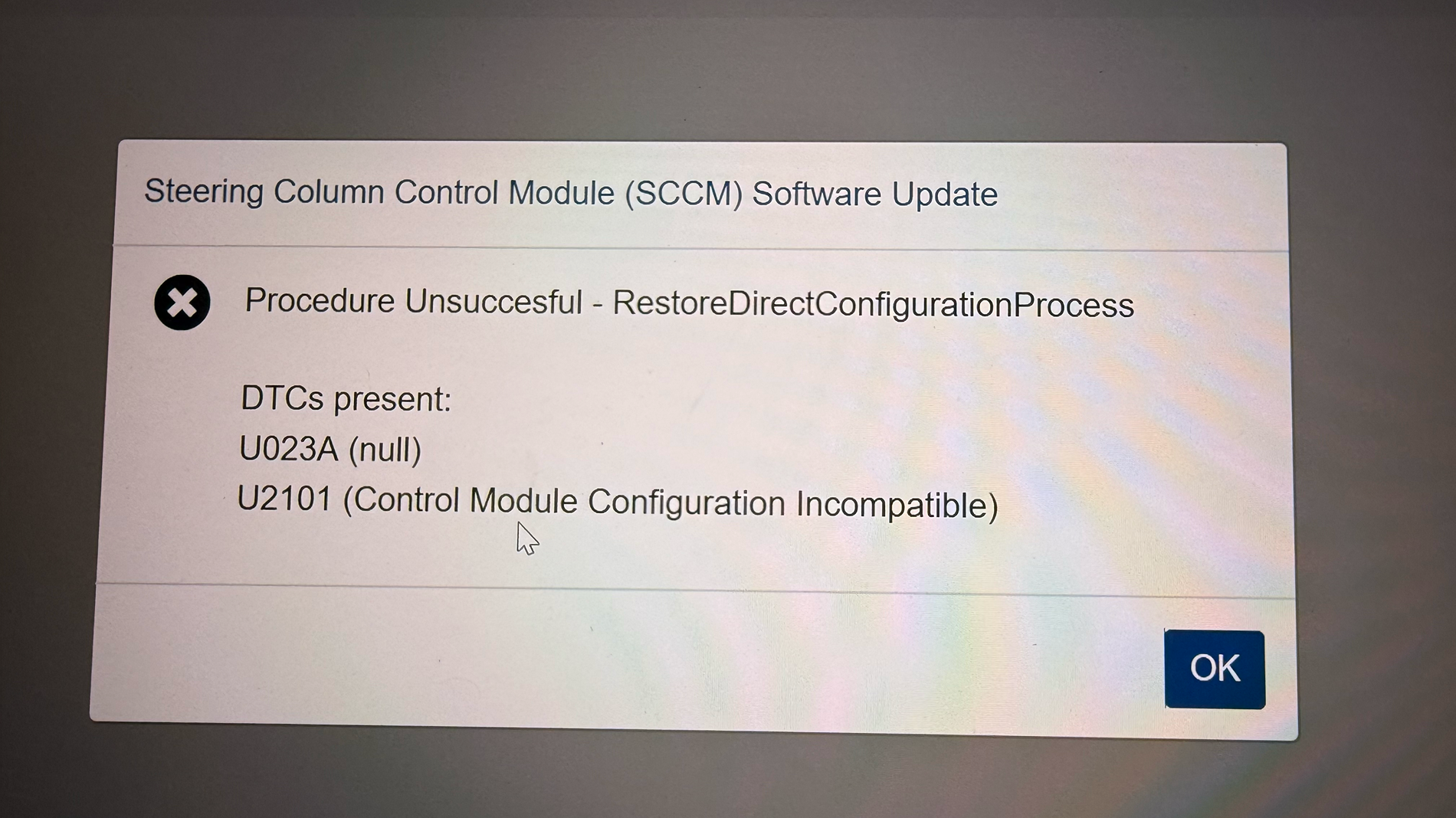

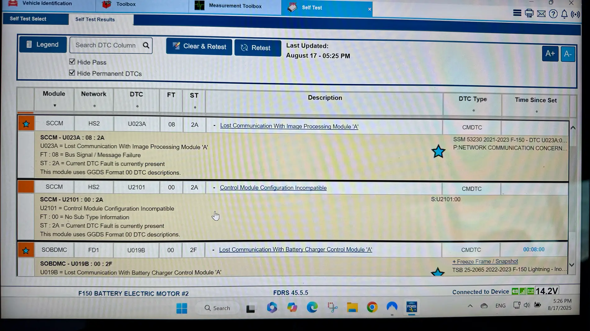

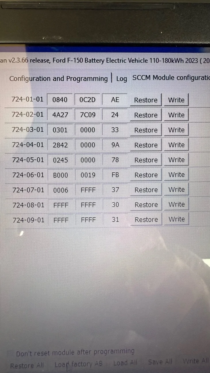

I had no luck, today I tried to update the SCCM but failed. The code U2101 came back after the update said resetting the module, then it read the DTCs and there it was. I went back to forscan and checked the GlareFree values and all where OK except the SCCM which changed back from 2844 (value for glare free) to 2842 (ABT value) in section 724-04-01.
it’s late and I’m tired, but I was thing in putting all the values in all the modules back to original and try again. Hope this works.

Done! I was able to update. I went ahead and just retuned to original the same section in each of the modules needed for the GlareFree function. After clearing the DTC it didn’t come back and the SCCM update was able to finish!
I still have a DTC in the SCCM but have no idea where to check, I’ll see what I can do. And also in the SOBDMC.
