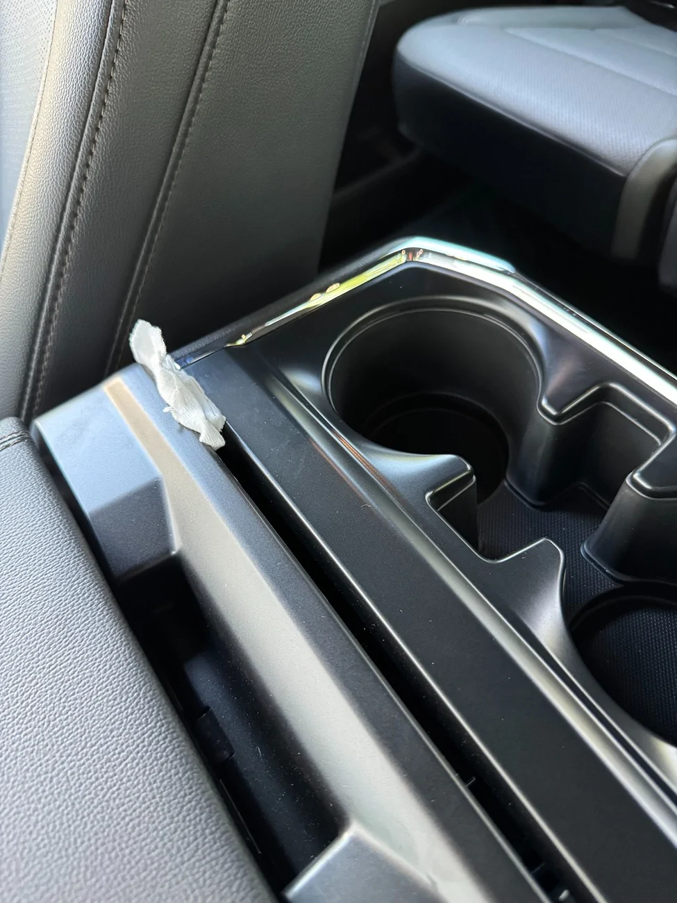

Old thread but I have this problem currently ongoing as well and it is driving me nuts.
I have been trying to trouble shooting this and based on my anecdotal testing only, I am 90% sure the rattle is from the button or the plastic catch used to open/secure the top part of the folding worktop.
I believe the plastic mechanisms are too light or there is too much play/looseness causing the rattle. If I rest my elbow/arm right over top of that spot, the rattle stops and opening the worktop slightly and disengaging the mechanism also solves the problem for me. I'm trying to find a clever way to 'snug up' the connection point to hopefully solve the issue.
I am open to suggestions or ideas.

I stuffed some foam down in this area and no more rattle, the paper towel was just used for testing.
