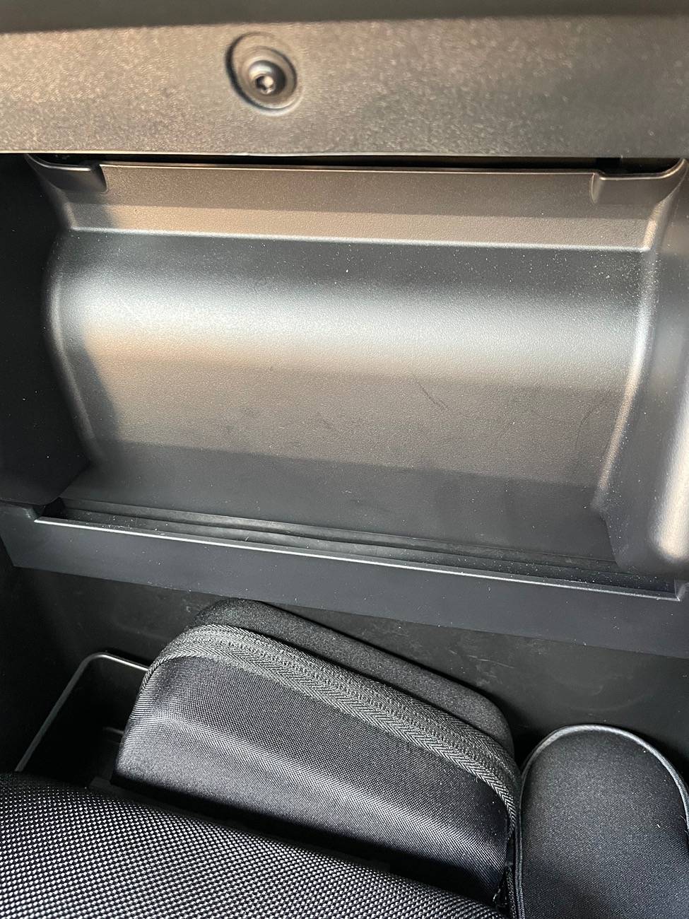

Oh my, I've not seen that much work for this on the other threads/posts. Most just place them under the front spring tabs only (nothing to take apart).

I will probably throw some nickels in there first, see if that helps. But the rest of my day is dedicated to the 442, have a small oil leak so changing the valve cover gaskets. It's one of those old school vehicles that make a lot of noise lol

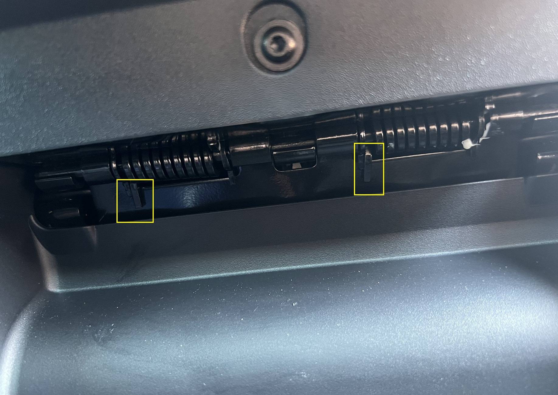

I don’t think those springs are visible without taking a piece of trim off the back panel to expose them. I haven’t looked in awhile so I could be wrong.
They are visible without removing anything. May be easier to get to with some removal, but should be able to do the 20 cent mod without removing anything. I have not done the mod yet, but it's on my ToDo list.
These are in the front by just opening the console lid and looking up in (at). The video that was posted earlier was the first time I saw anyone accessing the rear side (back cupholders) to access the rear/other side of the spring.
They are not visible in my 2022 Lariat without taking out at least one piece of trim.
Hmm, our trim pieces look the same but your picture is taken slightly from above looking down. The hinge is on the top, right under the opening lid. Down, looking up in that hole/slit.
See video, if yours is there too :) - I haven't done my nickel trick yet but am overdue as my lid falls down regularly.
