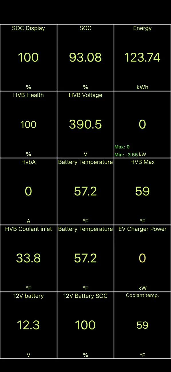

Charge Complete - 123kw
jobofly79
jobofly79
Joe
Feb 17, 2025
201
281
2024 Ford Lightning Flash 312A
I wouldn't worry. Your SOH is 100%. If you want to calibrate, charge to 100%, drive to about 15-20%, then charge to your normal SOC. That will calibrate the BMS based on current conditions, but as others have said, its cooler so you may not see any improvement and won't likely see the full 131kWh until it gets a bit warmer.
After 4 winters, I've developed a trust. It is quite predictable and spring always brings it back to where it should be.
You were right! I waited until it got warm and charged it to 100% and I had 131kw.
