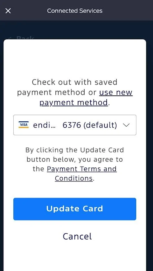

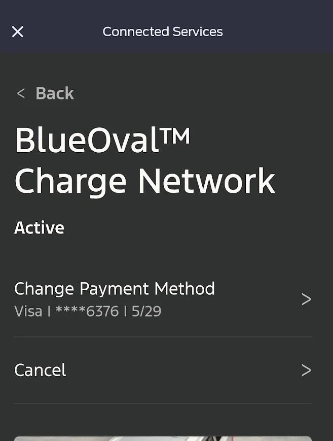

Welcome to the forum, double check the expiration date on the credit card you shared with Ford connected services.

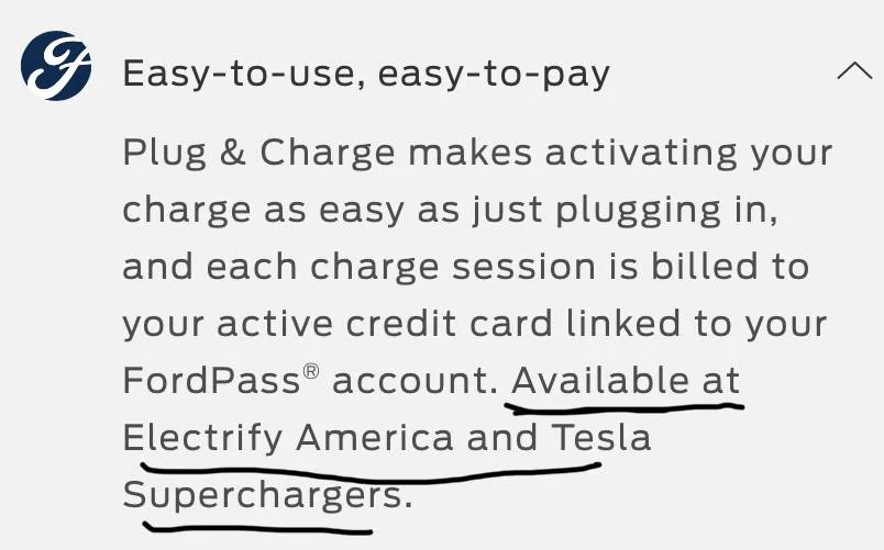

You do realize P&C only works with Electrify America and Tesla stations, correct?

I thought Plug and Charge would work with Blue Oval network stations.

Be sure you have a valid credit card stored on your Ford account.
exactly! My payment method got deleted by accident (my fault) and when I tried to charge last weekend my instrument cluster simply said "charging paused". Ford Pass simply said "unplug and plug in again". I got an email the next day (24 hours later) saying I needed to update my payment method. But while I was standing there the day before stranded I got no text or notification via Ford Pass that the problem was simply updating my credit card. once again very poor software design.
Not all, like Maquis pointed out. But the stations that aren't Plug and Charge ready can be activated through the Public Charging app in the truck or through FordPass.

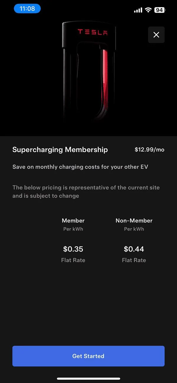

FYI - You can save money at Tesla Supercharging stations by purchasing a membership plan to get reduced rates.
Keep in mind you will need to use the Tesla app to start and stop your charging sessions.
You can read more about it using the below link.
I typically activate my membership when I begin my road-trip and cancel it right away so It doesn't auto renew. You will still retain your benefits until the end of your billing period.

true 'Plug N Charge' is only currently set for EA and Tesla, although the above option may make it seem very similar.
