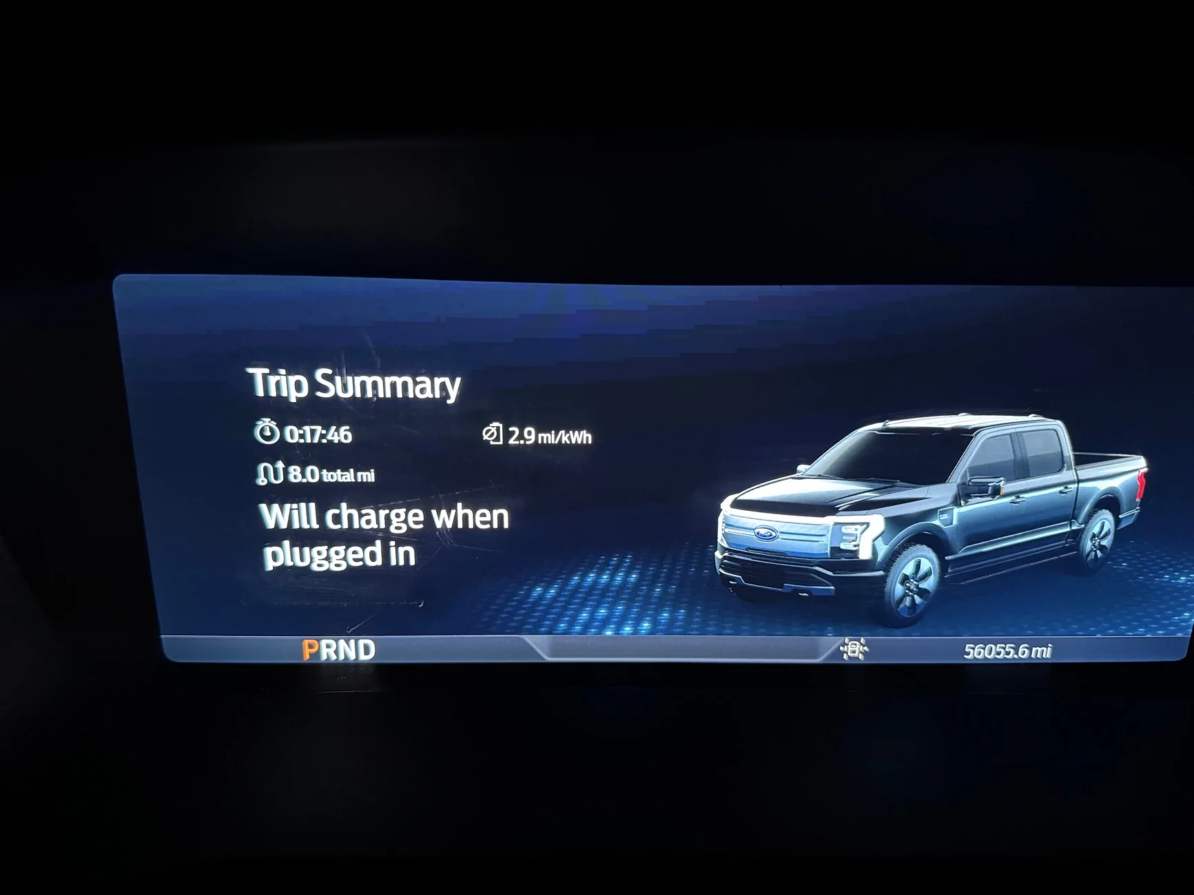

Mine does the same thing, primarily on cold nights. Charge to 90%, bumps up to 91% or sometimes 92% when I set departure times and it preconditions.
I don’t think it’s an issue. I always thought that as the battery gets to temp from being cold, the efficiency in the cells improves leading to the marginal improvement in battery percentage that is a few kWh in %/range. In my mind harmless. Due to the amount of driving I do, I charge to 100% 1x/wk and 90% 6x/wk without issue. 4 months of owning the Lightning like that, OBDScan shows cells still at 97% from a 2022 XLT SR at over 56000 miles.
