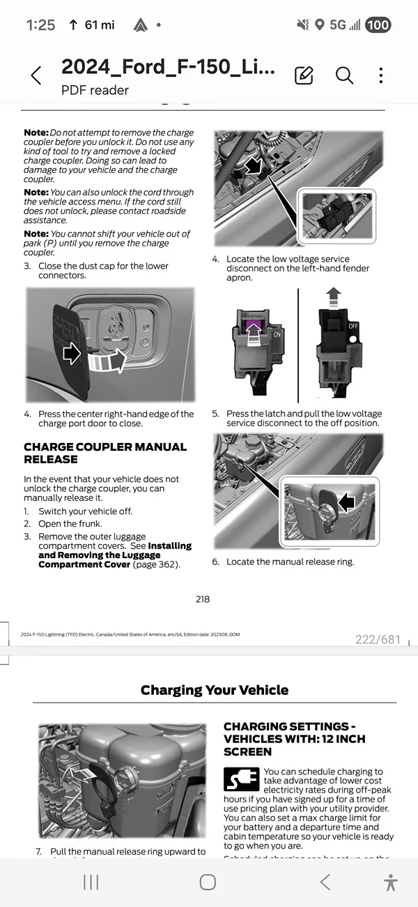

I am in the middle of a trip and have had issues with the DC charge port lock. Thought I might have to cancel the trip but have successfully been able to use the manual reset process in the owner's manual which then allows me to use the charger which caused the fault. Nothing seems consistent whether it's the type of charging station or the sequence of events. Sometimes it charges fine and sometimes it causes a fault but if a fault is caused, every time I'm able to do the reset process and then successfully charge afterwards. This is regardless of the charger type. Hopefully this helps somebody else out of a jam. Here is the picture of the part of the manual explaining the reset process.
Ford F-150 Lightning Charging Issues During/After Fast Charge Visits? * 2026 UPDATE* Screenshot_20251028_132507_Samsung Notes
