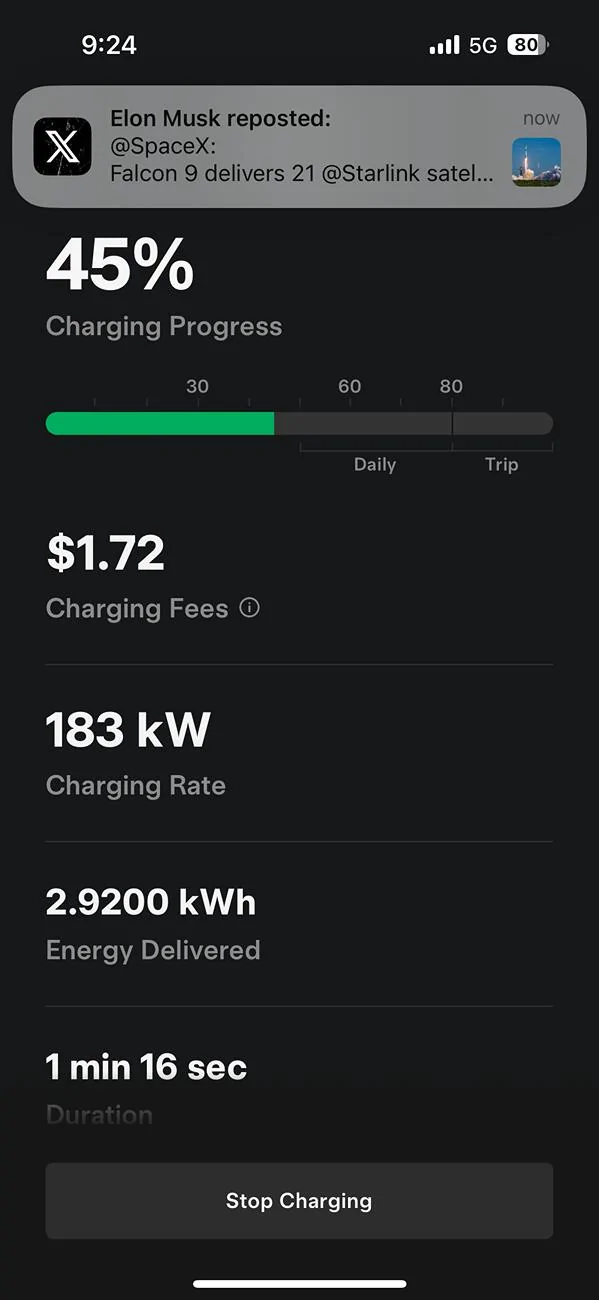

I was getting 183 kw at supercharger in August of last year. 2023 lariate er. I don’t know if I recieved this update or not. I was not monitoring on car scanner.
Ford F-150 Lightning New OTA Update Improves F-150 Lightning DC Fast Charging Times IMG_1565

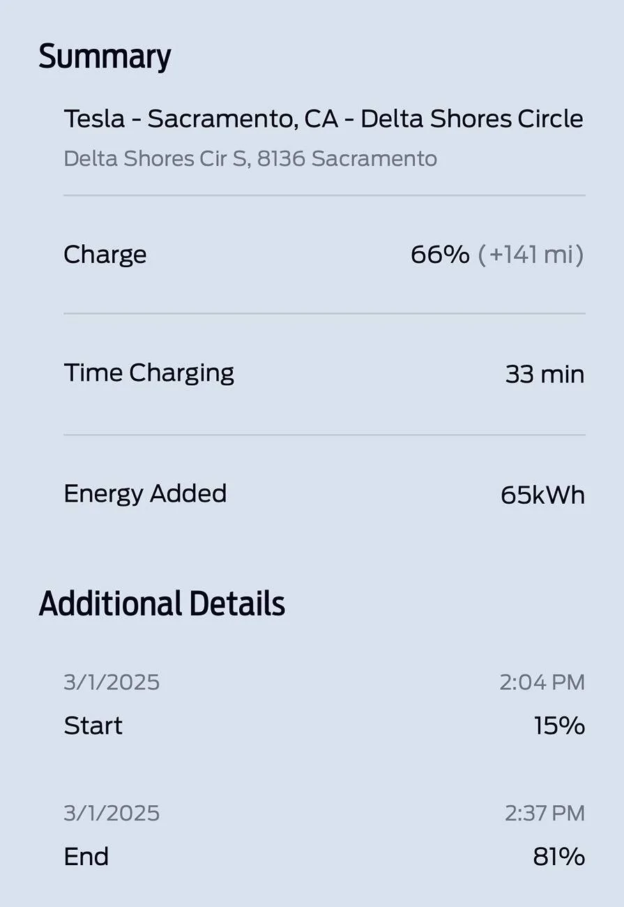

I don't know exactly why, unless the new charging curve is a bit different for the SR battery (I have a 23 SR XLT). I don't think Tom has recently tested the SR battery, as he has an ER Lariat.
I didn't think that I had received the charging update, but I just charged at a Tesla site last week, and went from 14-73% in 26min. That's pretty close to 32min for a 15-80 charge. In fact, I charged at another Tesla site a few days later, and went from 15-81 in 33min. So yeah, it seems that (a) the Ford documentation is correct regarding the changed charging curve, and (b) those who have '22 and '23 SR trucks either have already received the charging update, or will soon.
Ford F-150 Lightning New OTA Update Improves F-150 Lightning DC Fast Charging Times IMG_7373

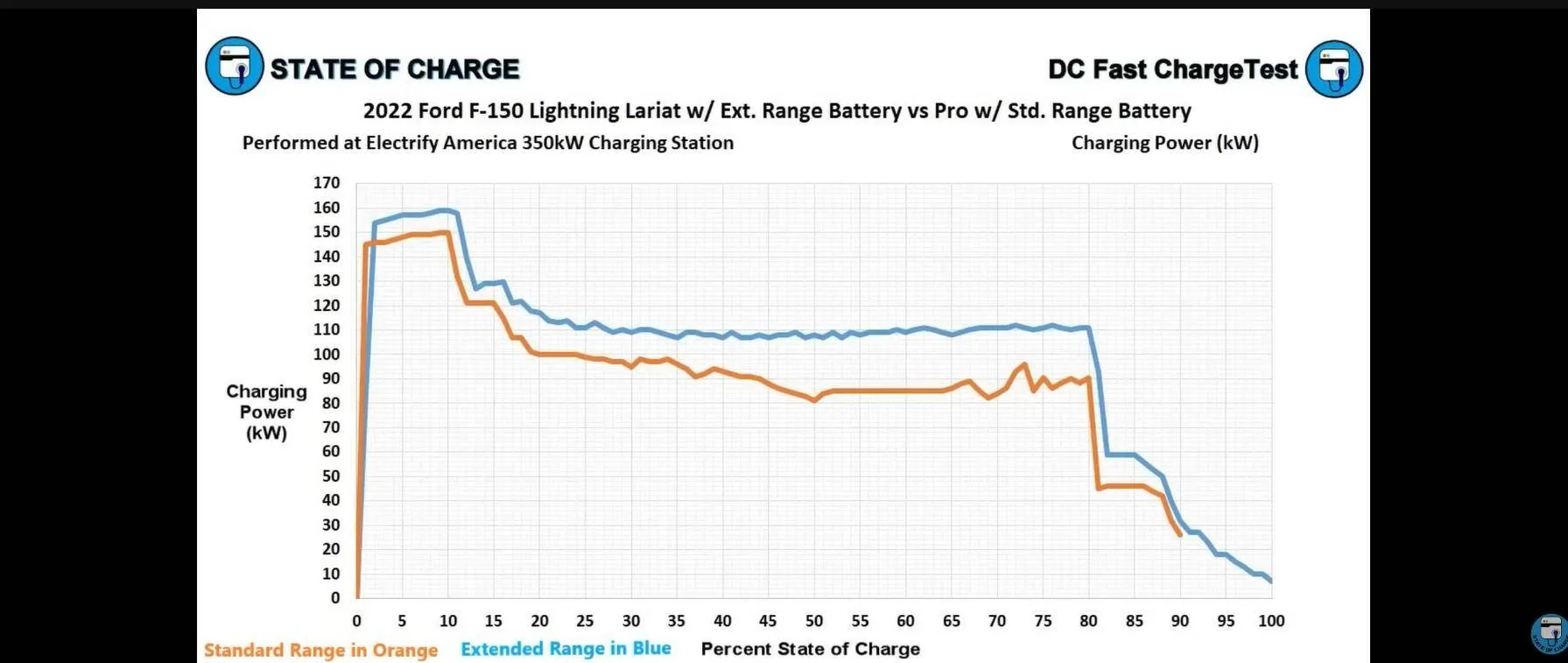

This was one Tom did on a Pro SR 2 years ago.
How Fast Does Ford F-150 Lightning Pro Standard Range Charge?
Ford F-150 Lightning New OTA Update Improves F-150 Lightning DC Fast Charging Times 1741377479652-oi

Right... I should have been more clear. I don't think Tom has RECENTLY tested the charging curve on the SR battery. He did do a comparison a few years ago. But that was the OLD charging curve. I was referring to him testing the new charging curve on the SR battery pack. :)

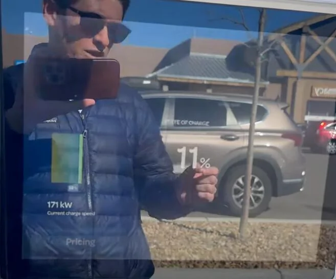

Just rewatched the 10% challenge from Out Of Spec last and looks like they were getting around 500 amps during the boost way back last April. Didn't show the entire charge but it peaked at 176kW v Tom's 182kW and finished with 39% (40.3kWh) after 15min v Tom's 42% (42.3kWh). 450 amps should've been in the 160's. Seems something was afoot way back and went mostly unnoticed besides the charging speed bragging threads.
Ford F-150 Lightning Charging / Highway Efficiency Logged In Our 10% EV Road Trip Challenge
Ford F-150 Lightning New OTA Update Improves F-150 Lightning DC Fast Charging Times 1741482685121-pr
Below voltages are based on Tom's video with theoretical max boost at 450 and 500 amps.
Battery %Voltage450 a500 a
10%338152.1169
15%356160.2178
20%362162.9181
25%364163.8182
30%365164.25182.5
35%367165.15183.5
40%370166.5185
45%370166.5185
50%372167.4186
Then again Branden Flasch did a 10% challenge back in Octoberish and managed to get up to 40% (~37kWh delivered) with 450 amps and maxing out at 162kW
