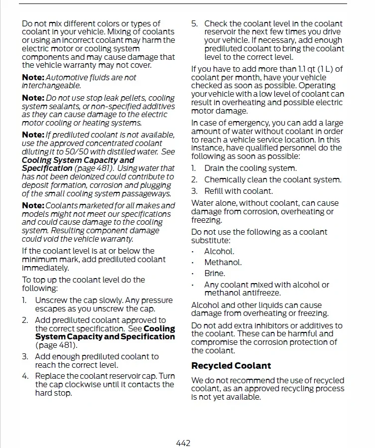

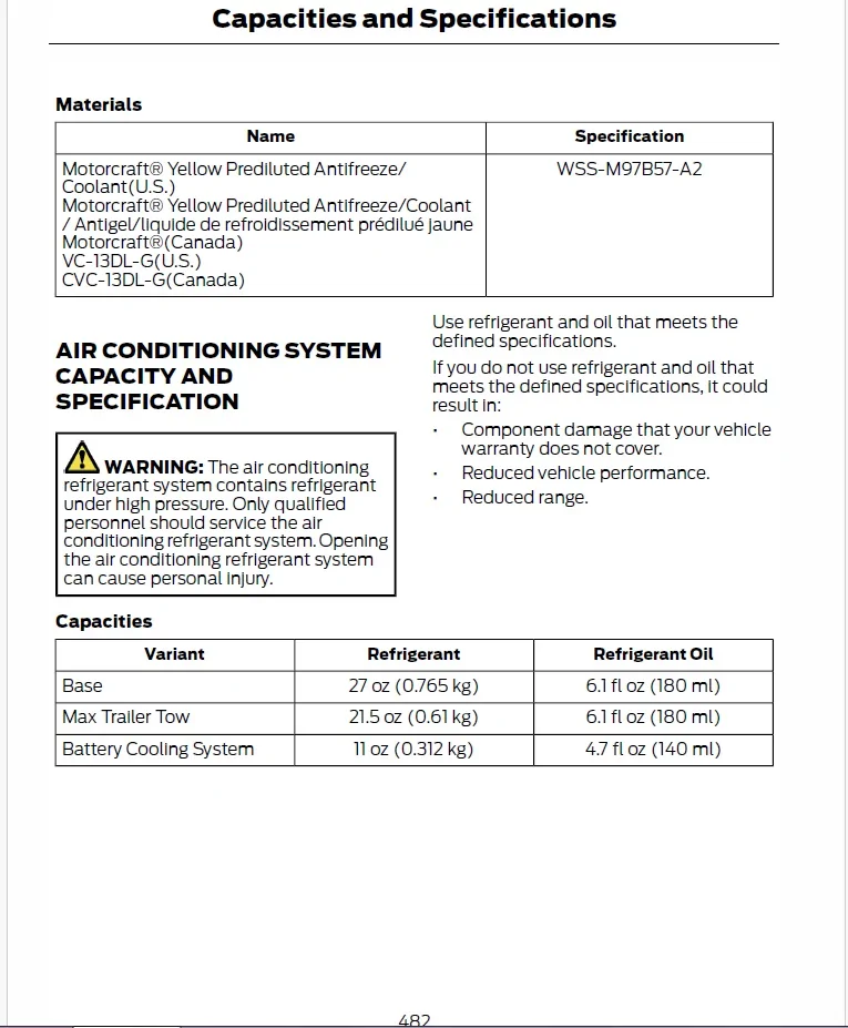

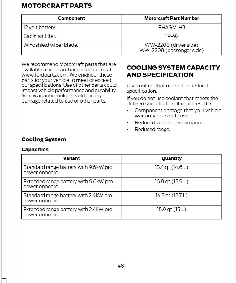

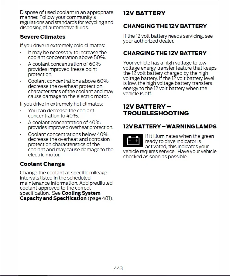

If you look at the manual (pages 441-443, 581 and 482) it notes that the dilution is 50%, but that you can lower it to 40% for extremely hot climates, and raise it to 60% in extremely cold climates (see page 443 below).
I bought 50% diluted to top off mine.
Obviously, you could estimate the amount needed to reach the max mark and using a measuring cup, mix 1/2 purified distilled water (I believe that is what is needed, at least it should be distilled) with your 100% concentrate to get the 50%.
Ford F-150 Lightning Check your coolant… now! Super low on ‘24 lightning. checking the coolant page 441

Ford F-150 Lightning Check your coolant… now! Super low on ‘24 lightning. checking the coolant page 443
Ford F-150 Lightning Check your coolant… now! Super low on ‘24 lightning. checking the coolant page 481
Ford F-150 Lightning Check your coolant… now! Super low on ‘24 lightning. checking the coolant page 482
