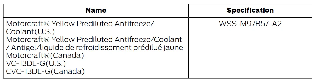

Bought mine new and it was a bit low after a few months so got this to keep on hand.
https://www.amazon.com/dp/B00BNVK1NQ
Hum, so which is it . . Orange pre-diluted, or Yellow pre-diluted? Web page with a picture of one, and the description of the other...I don't know why Amazon has such a hard time with documentation
