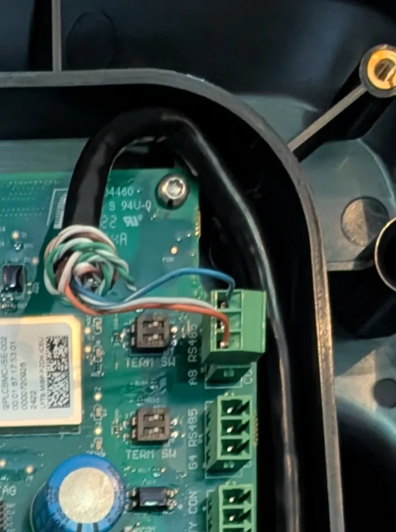

I need to make a new thread but I was able to get mine working after 70 plus emails with Ford engineering.
I would say that if your truck hasn't gotten updates you should pursue with Ford BEV hotline getting an appointment at a dealer to fix whatever is preventing that. In my case the gateway module was stuck in a state where updates were off no matter the setting shown on screen.
Confirm the inverter is up to date. There were some fixes in the newest version. I think it was version x.x.36
But most importantly and what fixed it for me was a hardware install issue. At some point they changed the installation and no longer connect the common/ground on the rs485 port. Old installs have orange landed there but this screws the transfer up and causes it to hang and eventually fail. Sunrun tech lifted this orange and it transferred properly immediately after for me.
If your having what looks like good transfer but then no power followed by failure after 1 to 2 minutes check if you have this orange communication line landed, it should not be.

I'll remove the cover tonight. Did they just push the orange pin connector back to isolate it or just cut the wire?

It's communications, they lifted the pin from the green connector. They left as much as they could but cut the exposed copper so it doesn't short with anything. I think they wrapped it up with the other unused conductors in the event it ever needed to be used in the future.
