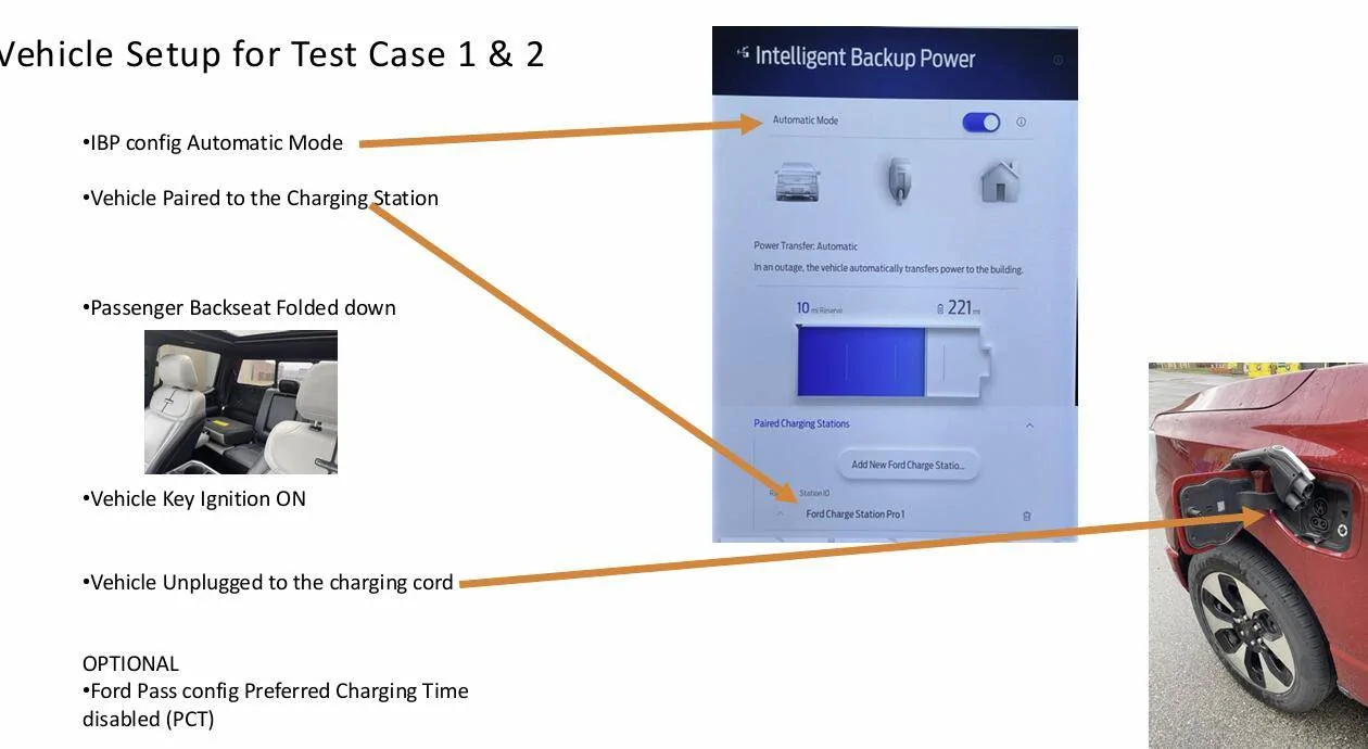

However, in the Home Integration tests that Ford asked some of us to perform around the beginning of October 2024, Ford seemed to tacitly acknowledge that vehicle activity might be connected with backup power transfer. Vehicle and grid cycling were part of the test parameters.

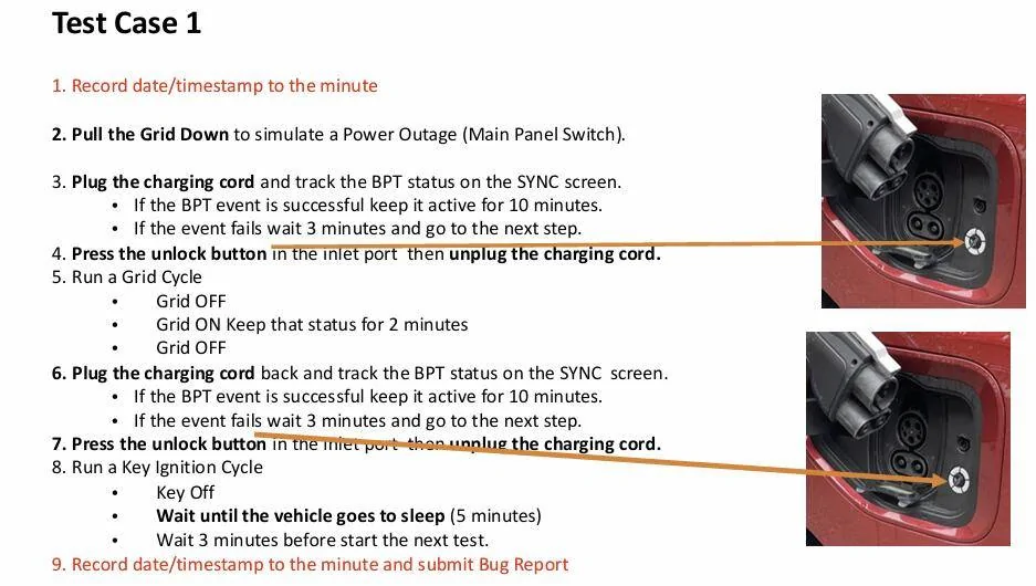

The setup for test cases 1 and 2 was the following (vehicle running at the start of each test):
Ford F-150 Lightning Home Integration System Issues Screenshot 2025-01-15 154159
The first test, with the vehicle on to start, failed for me in BPT at step #3 but succeeded at step #6:
Ford F-150 Lightning Home Integration System Issues Screenshot 2025-01-15 152012
My intuitive sense is that the instruction in step #4 to press the UNLOCK button and remove the charger head was what inspired me to subsequently try that sequence to rescue failed BPTs in subsequent systems tests - and it's worked every time since.

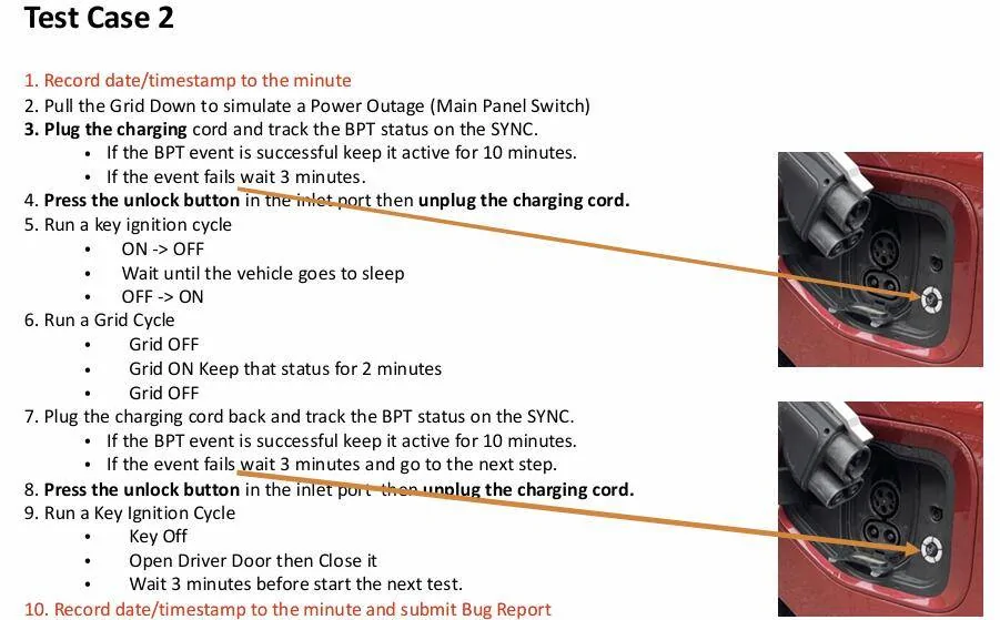

In test case 2, with the vehicle on to start, BPT worked at step #3 but failed at step #7 (but I disregarded instructions after the failure at that step, pressed the UNLOCK button on the charger port, removed and reinserted the charger head, and rescued BPT at step #7):
Ford F-150 Lightning Home Integration System Issues Screenshot 2025-01-15 152046
There were also test cases 3 and 4, but I'll omit those for now.

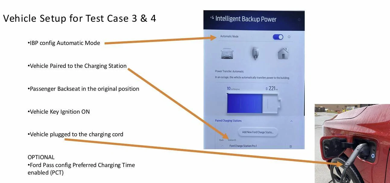

The setup instructions for test cases #3 and #4 given below state that these tests are to be started with the charger head plugged into the vehicle, but the specific instructions on how to proceed in test case #3 say it's to start with the vehicle UNPLUGGED.
The setup instructions for test cases #3 and #4 also say the right rear passenger seat is to be in its "original position." Translation: the right rear passenger seat is to be upright and snapped into the car frame.
Setup instructions for test cases #3 and #4 (see cautions above):
Ford F-150 Lightning Home Integration System Issues Setup Instructions for Test Cases 3 and 4

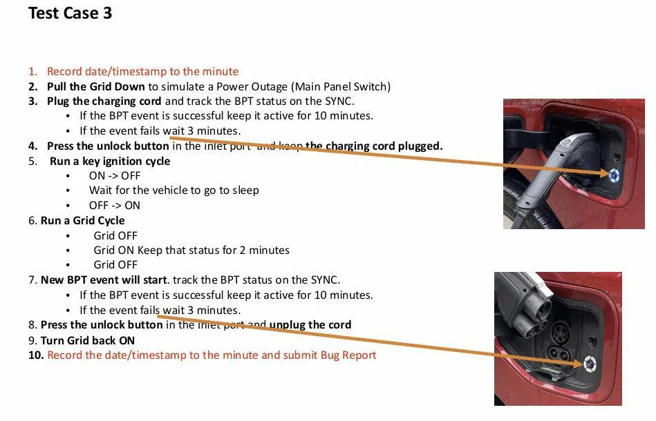

Test case #3 instructions (note charger head is to be unplugged from vehicle to start):
Ford F-150 Lightning Home Integration System Issues Backup Power Transfer Test Case 3
In step #3 of test case #3, BPT failed as my white LED truck port lights went out. Then, since I had the truck running >30 min from the previous test and wasn't thinking about the automatic shutdown timer, the vehicle shut down! I could initiate BPT via the UNLOCK button trick without powering the vehicle on again. At step #6, with the grid on again, the truck started charging since my vehicle had entered its charging time window! At step #7, with the grid off, the white LED port lights went out, and BPT failed to initiate automatically, but the UNLOCK button trick was able to trigger it.

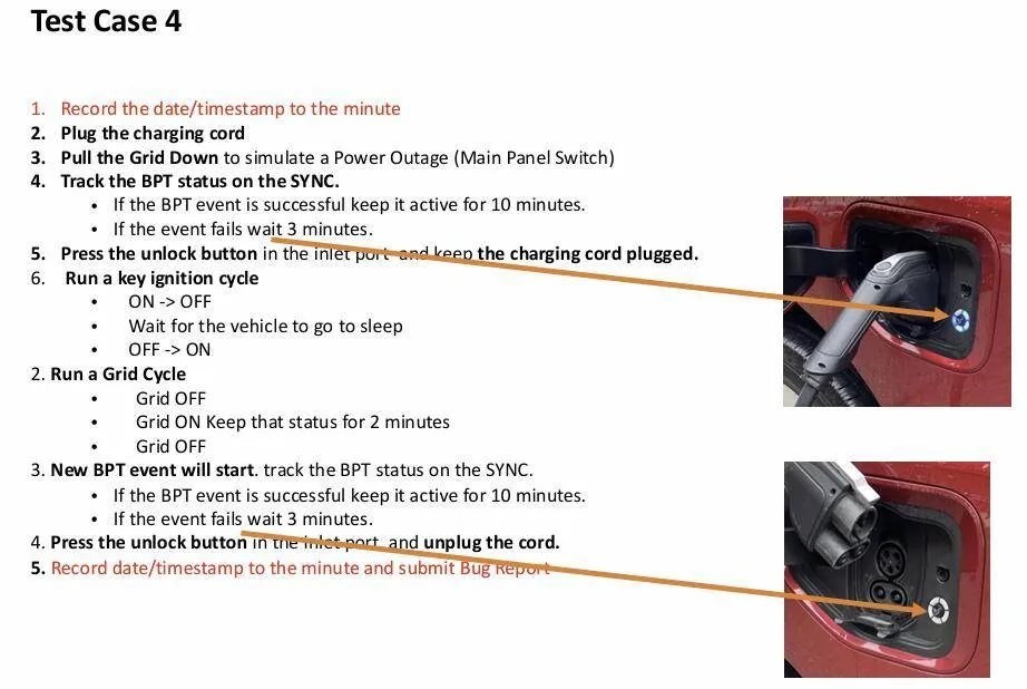

Test case #4 instructions(note charger head is to be plugged into the vehicle at the start; also, there is a screwup in numbering: the second sequence 2,3,4,5 should be 7,8,9,10):
Ford F-150 Lightning Home Integration System Issues Backup Power Transfer Test Case 4
For me, backup power transfer (BPT) was automatically initiated at step #4. BPT failed for me at step #8 (the 2nd #3); the white LED port lights went out, but the manual UNLOCK button trick then initiated BPT.
