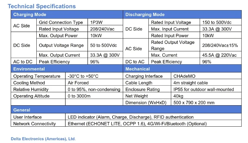

Well sort of...but not really.
The inverter will change the 400VDC to 240VAC and draw it at 40A for 9.6kW- that's about what the Ford authorized HIS through the FCSP with the DELTA inverter is (well max 10kW according to the specs):
Ford F-150 Lightning Class Action Lawsuit - Home Integration System Delta specs
This is not a 30 minute DC charging session with high voltage (400-800) and high current (up to 500A).
My utility service panel is rated for up to 200A at 240V, but I use a whole lot less.
It's less power than the 240V 80A FCSP max power (19.2kW).
That should put it into perspective, eh?
