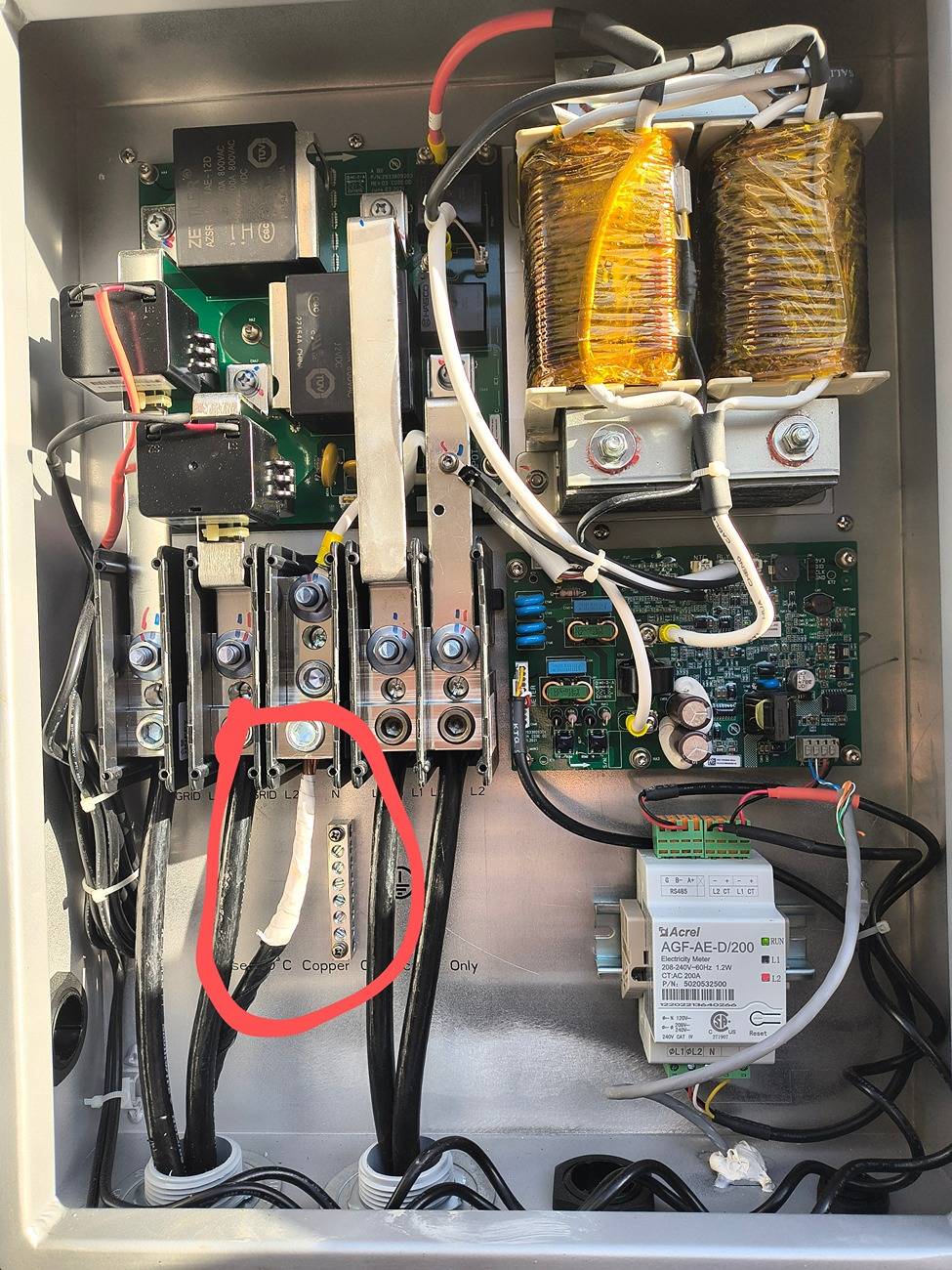

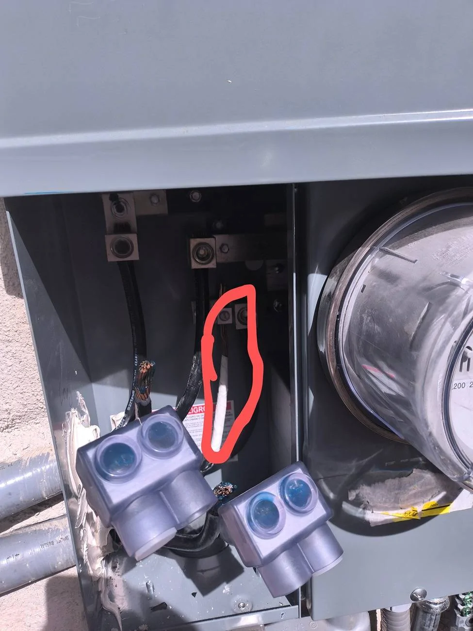

I see your problem clearly. You are missing the neutral wire on the load side of your WHB box. There are 2 lug connections for a reason. You need to run a neutral from the load side of the WHB to your panel board. This is exactly what I suspected was the issue. The neutral is formed by the WHB for your main panel to use, and it is completely missing.
I added in a white line below to show you where it should be here. The other end would be at your panel board connections neutral input.
So I need another neutral wire? I already have 1 going to the WHB, the one with white tape. I circled the neutral wire in the pictures.

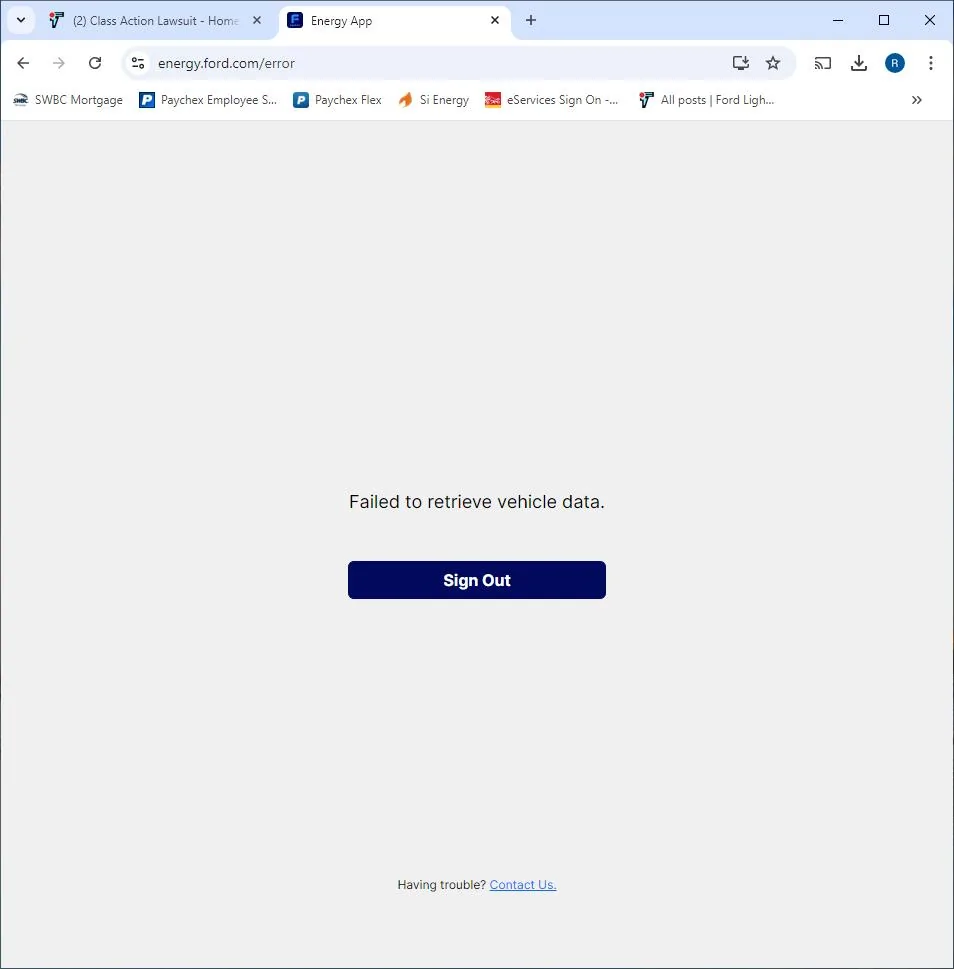

@tearitupsports, now that your HIS unit works great for you, how does the online Ford energy app work? I think you had trouble connecting before. It's still a work in progress as many would-be features have a pop-up that says that particular feature is not implemented yet. I am referring to energy.ford.com.
Interestingly, if I visit it now with my truck plugged in but no outage, I see a big START CHARGING button in the lower right. I haven't tried it yet to see if it starts my truck charging. I wonder if that START CHARGING button works, whether it's for everyday use or intended to recharge the truck during an outage that's an off and on and off again sort of outage.
I've listed the various ECG updates I've received in addition to 6.14 in the following post: https://www.f150lightningforum.com/...nt-backup-power-is-up-ahead.18856/post-429528. Maybe if your system is not working at all, it's because you still haven't received one of those updates? Mine has worked 11/11 tries since 10/2/24, with 6/11 requiring the unlock method and 5/11 working unassisted.
Nada. Just this.
You should have 1 neutral coming from the grid, and a another neutral leading to the panel board.

Thanks for the info, I will let the electrician know and hope that solves the issue. I really appreciate your help.
Again you have a wierd setup and I could be wrong. That being said the symptoms you are seeing were the same as mine when I have the breaker off between the whb and panelboard. Might just double check that the phases are correct as well. I wouldn’t think it should matter much but I don’t know everything the WHB is doing/checking.
this is what my electrician said when I text him,
"I don't think that's it. The neutral doesn't switch. It's just present. That wire goes into the block and does go to the panel board"

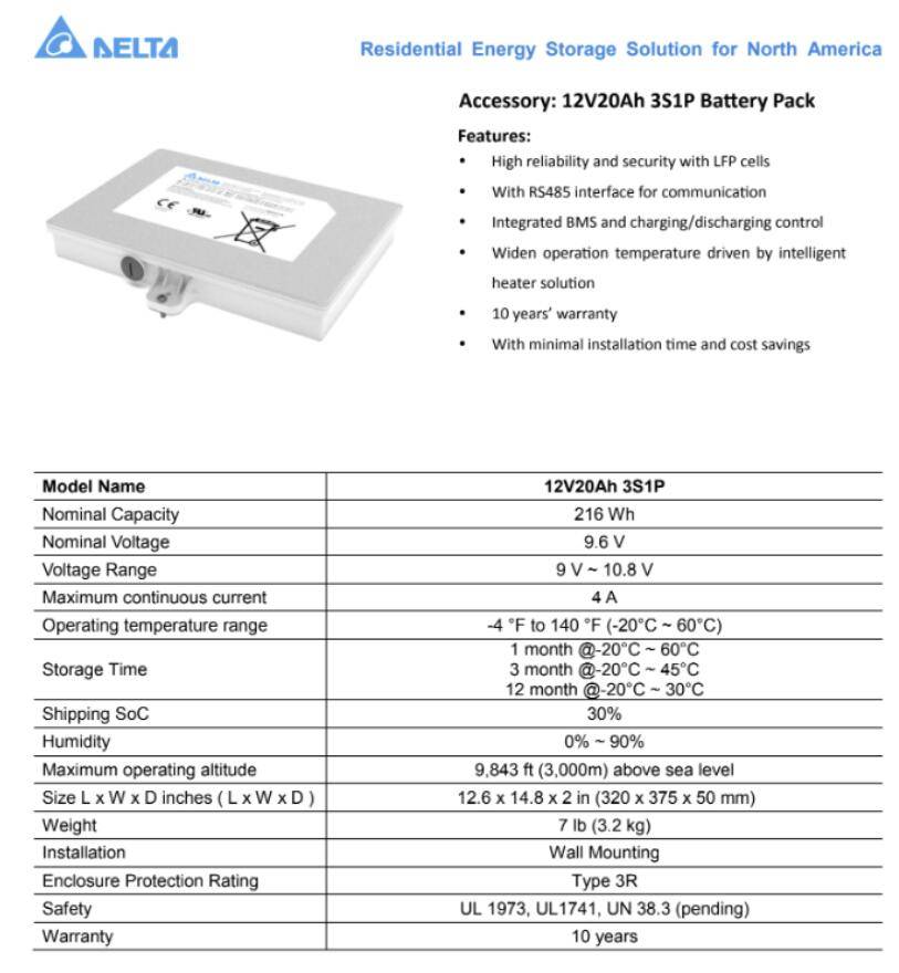

You can turn off all power to the HIS unit, including using the M Professional app to shut down the the Dark Start battery that powers the system when the grid goes out.
You're probably referring to the 3V battery in the upper right of the first picture included in the following post: https://www.f150lightningforum.com/...uit-home-integration-system.21562/post-429427.
I don't know about current-day computers, but my older computers had CR2032-like 3V batteries for the system clock that lasted five years or more. You don't have to replace them every year.

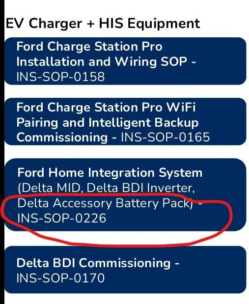

What I have wondered about is how long the Dark Start battery is going to last and whether it's easily owner-replaceable. From the Sunrun field website for the Home Integration System, the third spec sheet down appears to describe the Dark Start battery, a.k.a. as the Accessory Battery in the Home Integration System. Link to site: Field Website - Spec Sheets
The spec sheet says it's a 12V20Ah LFP battery, which should last hundreds of cycles and not mind so much being at 100% charge. The battery has a 10-year warranty.
Ford F-150 Lightning Class Action Lawsuit - Home Integration System 1729493287512-qs
Delta Accessory Battery Pack referenced in Sunrun's Delta BDI commissioning instructions:
https://docs.google.com/presentatio...4lYV3Z_u8/present?slide=id.g2b14eddfcee_0_799 (from the Installation Instruction section of Sunrun's
field website.
