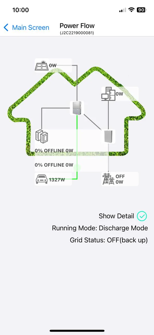

I have confirmed with my own system today, that excess solar charges the truck when in off grid mode.. Its slow as its only morning and my solar system faces south west. Even the Delta app shows power flowing to the truck with animation.
For reference my truck charge % has gone up since being on the home backup system. I have only a small 100W fan running so almost all of the solar is going into the truck.

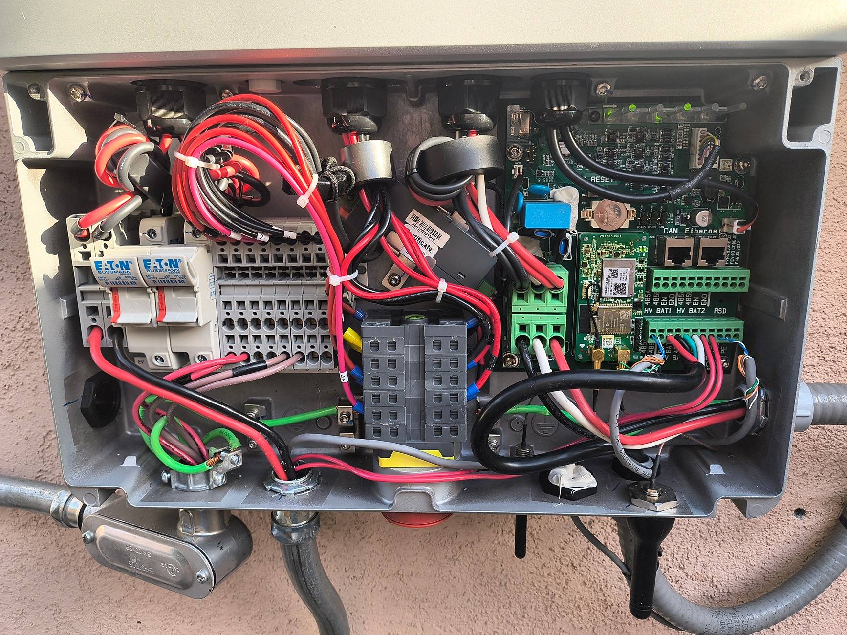

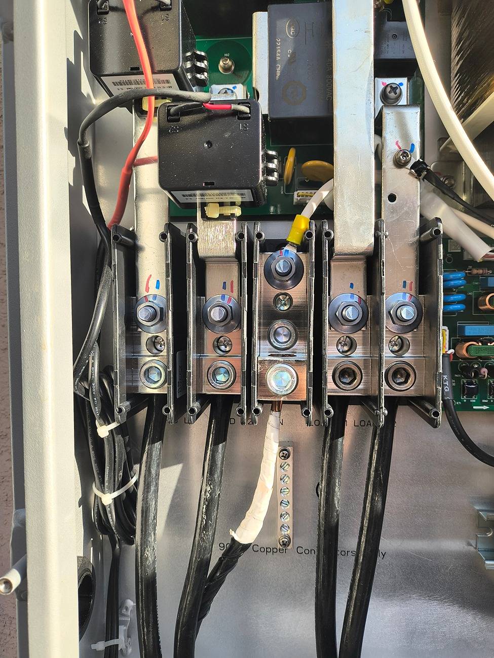

The WHB will not be powered. It actually disconnects the grid circuit when it goes offline. The power meter will shut off too. The critical part is that your E8-DBI inverter still has to be connected to the WHB in order to correctly form the neutral. That is what that big transformer in the WHB is doing. This is why you can't turn off your main breaker, because that breaks the connection between the 2 and the inverter will fault.
I know it is irritating to you right now, but your system is likely one small detail away from working properly. The hardest part to make work is working great for you.
I did a typo on my post.
"The meter shuts off, we do hear it click over, but power is NOT being sent to the WHB, I will try to take off the covers tomorrow and take pictures of everything."
Here are pictures of my setup. I have a red blinking light on L2 in the AGF-AE-D/200 MEETER

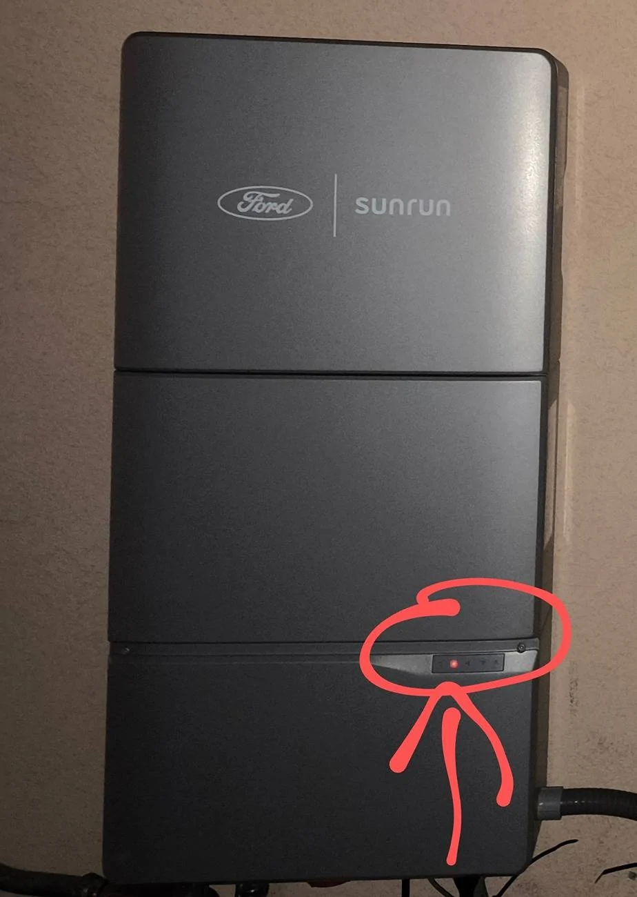

I now see a problem that may be at the root of some of this.
The M Professional app indicates “no device found” even when I’m holding my phone a few inches from the inverter.
Do you have the 3 lights blinking in your BDI as seen in the picture.

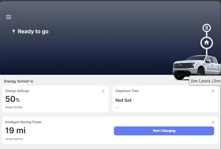

@tearitupsports, now that your HIS unit works great for you, how does the online Ford energy app work? I think you had trouble connecting before. It's still a work in progress as many would-be features have a pop-up that says that particular feature is not implemented yet. I am referring to energy.ford.com.
Interestingly, if I visit it now with my truck plugged in but no outage, I see a big START CHARGING button in the lower right. I haven't tried it yet to see if it starts my truck charging. I wonder if that START CHARGING button works, whether it's for everyday use or intended to recharge the truck during an outage that's an off and on and off again sort of outage.
Ford F-150 Lightning Class Action Lawsuit - Home Integration System 1729373882164-h5
I've listed the various ECG updates I've received in addition to 6.14 in the following post: https://www.f150lightningforum.com/...nt-backup-power-is-up-ahead.18856/post-429528. Maybe if your system is not working at all, it's because you still haven't received one of those updates? Mine has worked 11/11 tries since 10/2/24, with 6/11 requiring the unlock method and 5/11 working unassisted.

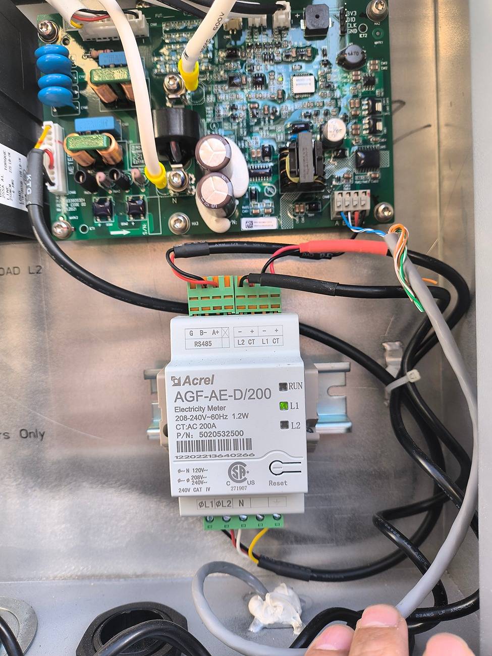

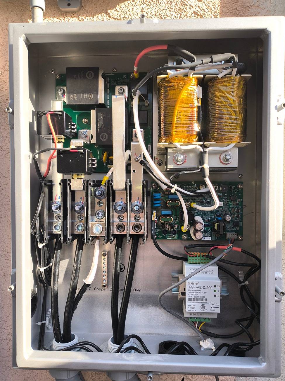

I see your problem clearly. You are missing the neutral wire on the load side of your WHB box. There are 2 lug connections for a reason. You need to run a neutral from the load side of the WHB to your panel board. This is exactly what I suspected was the issue. The neutral is formed by the WHB for your main panel to use, and it is completely missing.
I added in a white line below to show you where it should be here. The other end would be at your panel board connections neutral input.
Now I could be wrong because you have an unusual setup and maybe this already functions, but it is something that stands out to me.
You might also check to see if L1/L2 are swapped at all. It is hard to tell with all the wires being black.
