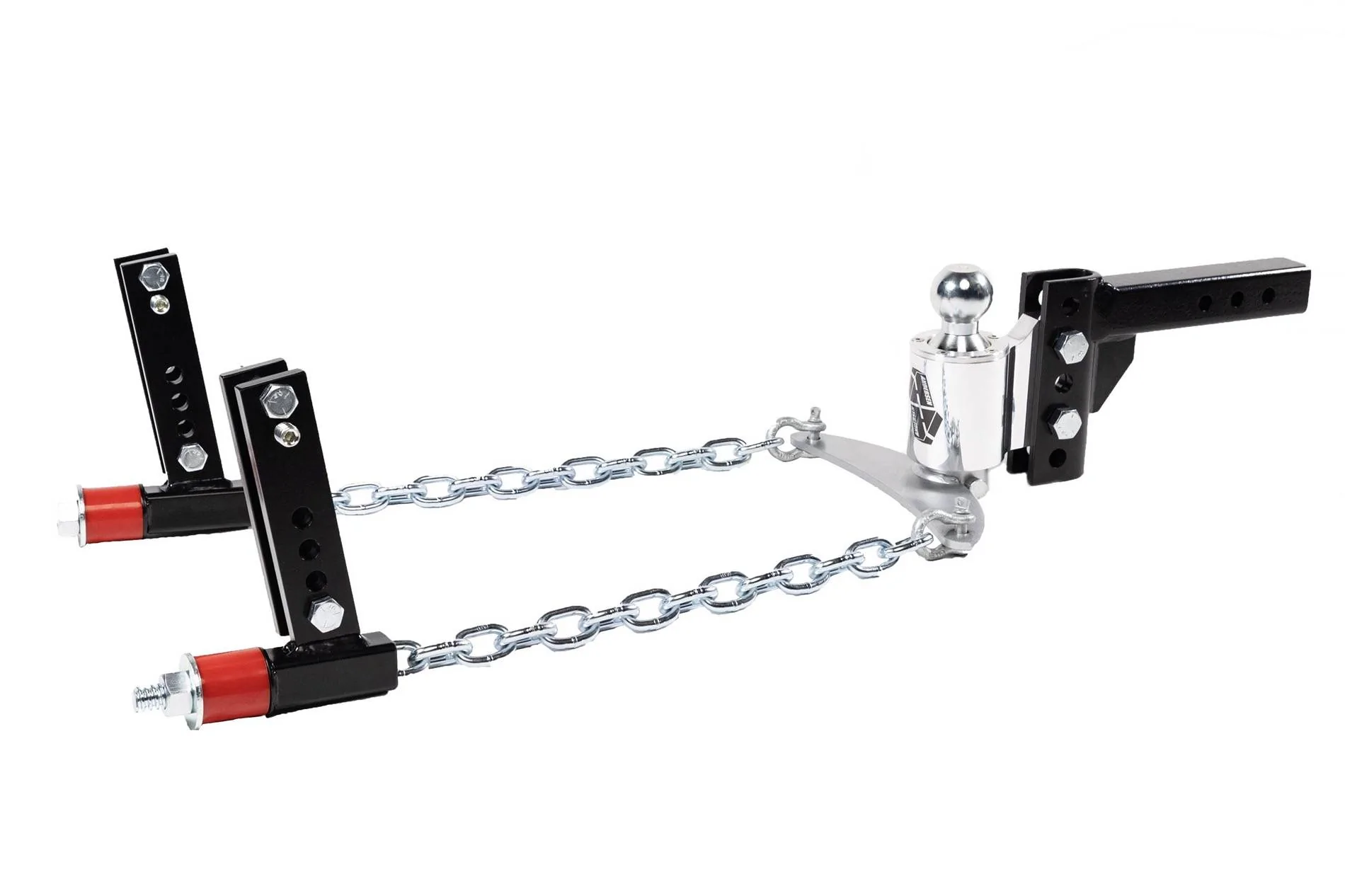

I towed a NuCamp Avia travel trailer from Louisville to Kansas City with a properly adjusted Anderson WDH and it was super smooth even over the crappy Indiana interstates. I'm guessing your hitch needs proper adjustment or your trailer brakes have an issue.

It's about 5,200 lbs dry so I was probably pulling 6,500 lbs. I can't say enough good things about those Anderson hitches. Super easy to use and adjust. I'll never use the snap up bars or chains again.

Sounds good but I tried the Andersen website and there were several pages that were 404. Did they get sued?
Also, there were several positive reviews on YT, but they were not for 5T trailers, and many said they wouldn't trust it. Has anyone seen one on my size trailer?

Back when I was researching, I saw bent plates with heavier trailers.
The other thing to note is that because you’re using chains you’re mostly controlling the up and down forces, not necessarily the forward back, side to side that some of the stiffer hitches do. This is the same going from a Wiegh Safe to a Pro Pride which allows movement.
