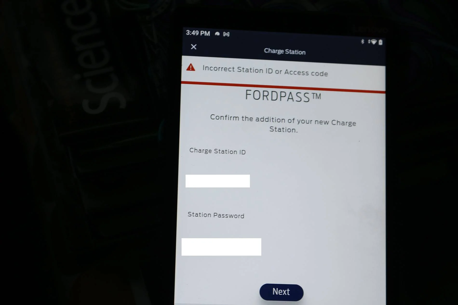

I had a MOCA wifi about 20 feet and 2 walls from the FCSP - didn't change anything except the main router that feeds the MOCA stations but last night it finally finished the setup.
Was getting two different errors at the last step, first this one until about November 2024:

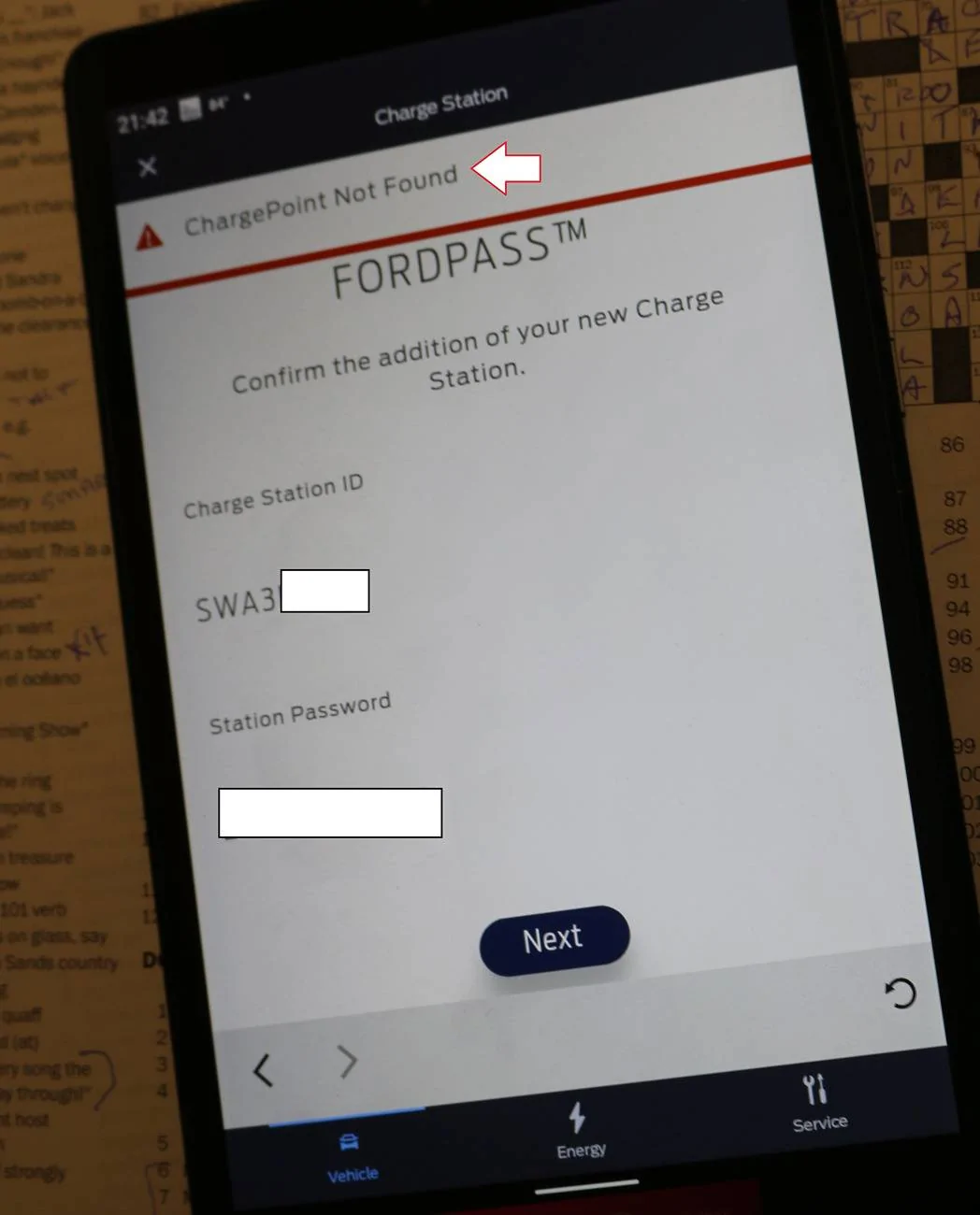

Then more recently this one:
Then for a couple months could not connect at all to the FCSP with the setup app.
Have to check and see what version my FCSP has now...ok...
OLD: FCSP Software version: 2.112.64:0.0:0.0:0.0:0.0
NOW: FCSP Software version: 2.112.125.3.15.3.15.3.15.3.15
So I got the software update somehow sometime after Nov. 2024.
