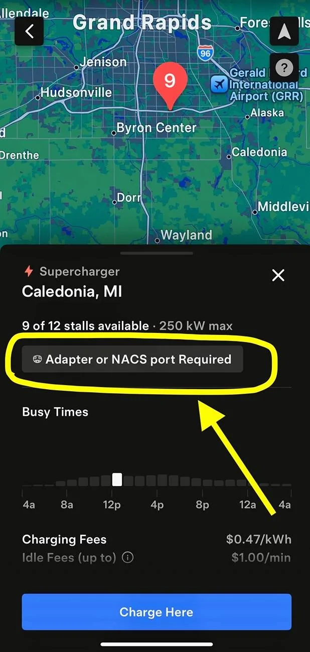

Last month I was able to use a new V4 Tesla Supercharger with the Ford adapter. I did not try to use the magic dock. In fact the app doesn't mention that magic dock is available.
Likely each location is set by Tesla on what charging method can be used. The app should state what is needed to charge up.
