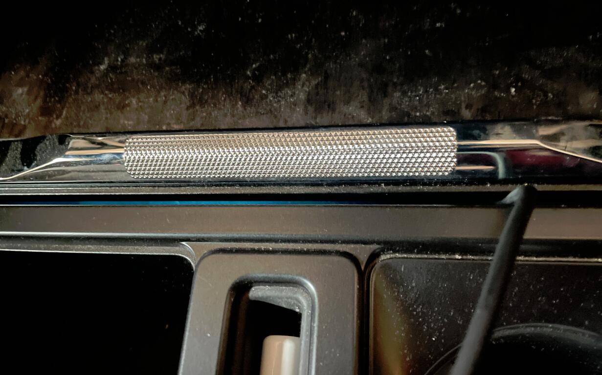

1. If I add the media light - does it shut off when the slider door is closed, or always illuminated when lights are on?
Always on. In fact the media lights up when you open the door and stays lit even after the cupholders goes out (w/o even starting the truck).
But it is very faint with the small crack you would have and I could only see the light if right over the crack. From the driver position the light is blocked by the weird notching of that cubby in relation to the slider.
