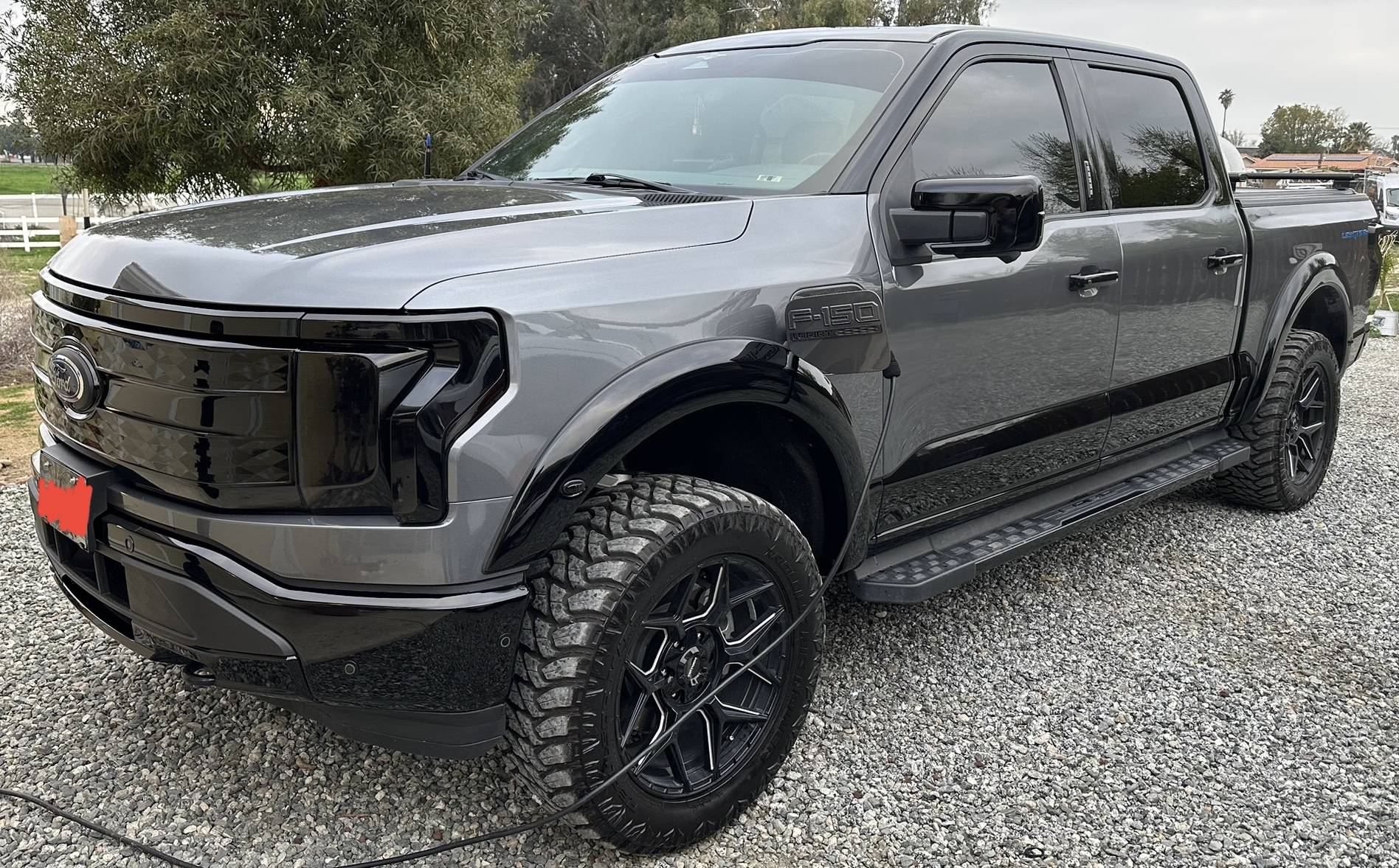

Any modification necessary, or direct bolt up? Ease of install?
Looks fantastic ?
Zap
They dont line up 100% on the body lines, but they line up much better than any aftermarket ones from what my body shop guy said. They are just a tad off, and none of the mounting holes line up so you just have to drill new holes. They have amber running lights that I have t connected yet. They come primed and delivered like 2-3 weeks from order date. The body shop painted them and installed. Also painted the bottom and top half/ and grill
