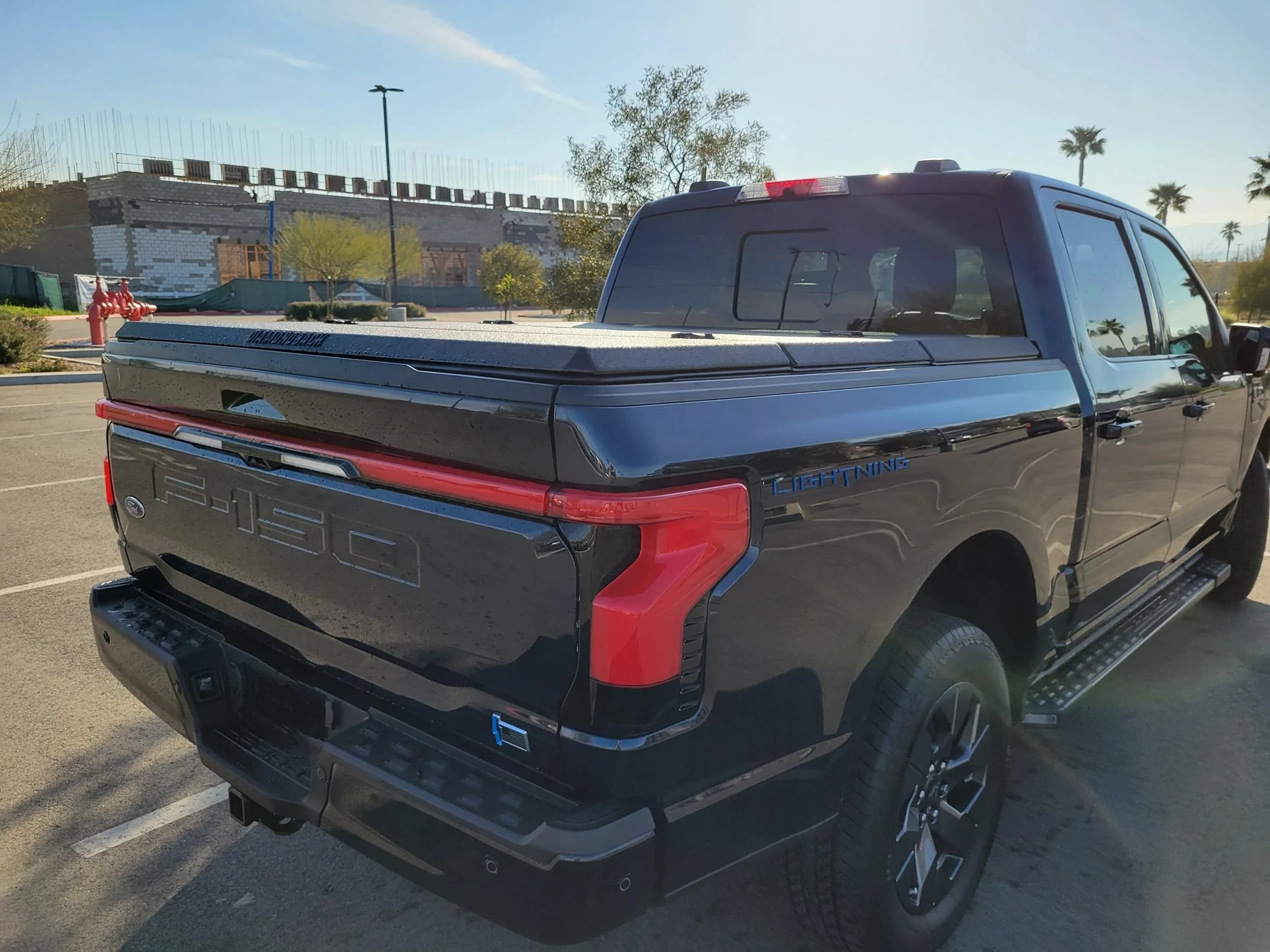

TLDR: Great tonneau cover but very expensive compared to other trifolds. Its heavy and needs 2 hands to open. The last panel doesn't fold against the bed. 99% waterproof and very rugged. The cover does interfere with the automatic tailgate.
After diving in the pool of endless tonneau covers, I ended up narrowing it down to the BakFlip X4S, Peragon and Diamondback Switchback. I ended going with the Diamondback Switchback. I liked the X4S, but could never get over how easily you can open it with a coat hanger. The Peragon had a lot of mixed reviews, mostly in the durability and water resistance areas, and the install time is between 3-4 hours.
The cover costs $1899, so roughly $700 to $800 more than other trifolds. Its made to order and shipped via freight shipping to you. Luckily the guy delivering it was willing to keep the pallet. I did rush shipping because I needed a cover faster, but from what I saw in other forums, it takes roughly 4-5 weeks before they ship it out to you.

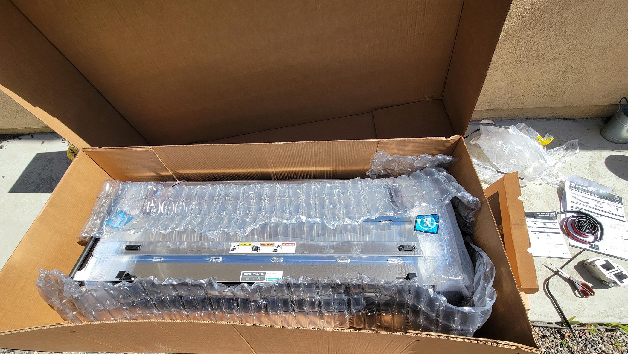

It was packed nicely in the box. The cover is roughly 80 pounds I believe, but I was able to slowly maneuver it into the truck without damaging anything.

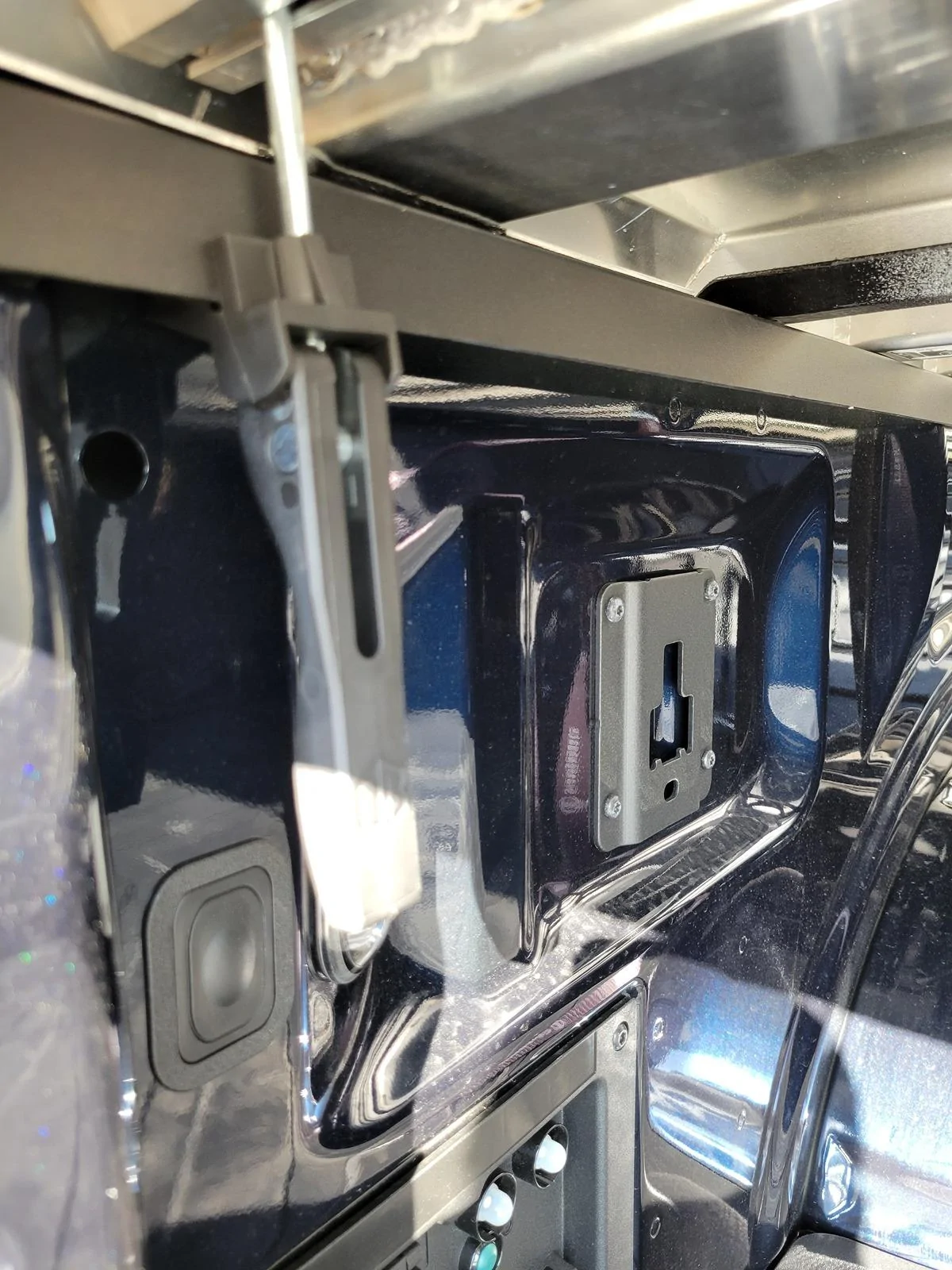

Installation wasn't too bad. I attached weather stripping to the back of the bed of the truck, and then placed the cover on top. You use 4 clamps using the existing rails to secure the last panel to the bed. So this means you do lose some bed space when its fully open. The back panel sits on top of the tailgate, and is secure enough that it makes the automatic tailgate non-functional. I have to pull it down and push it up myself. The cover is secured near the tailgate with 2 handle things that go into the rail. While no cover is 100% secure, this provides more security than a pull cord, but the downside is I have to release the handle on each side to fold the cover up.

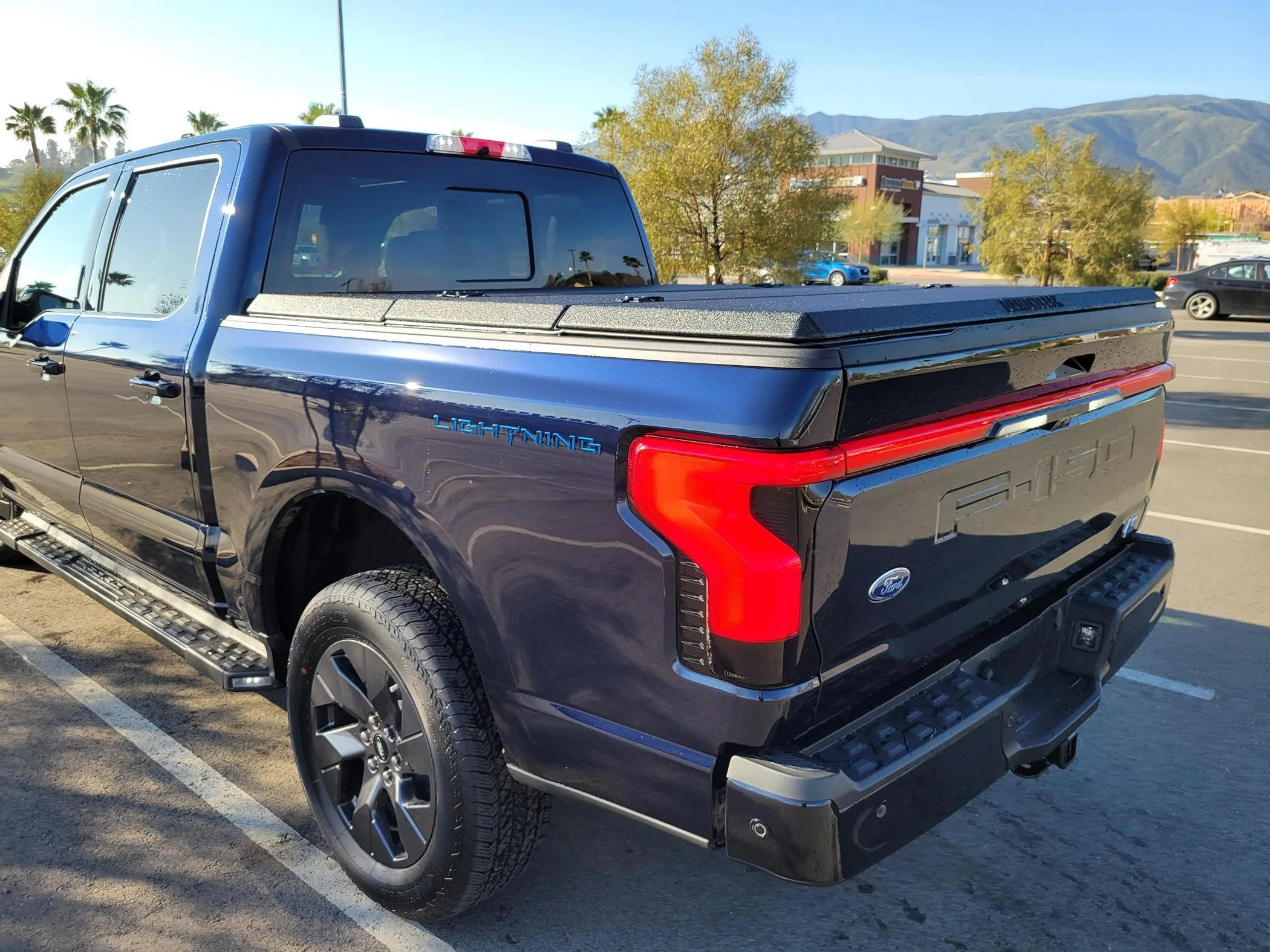

I took it through an automatic carwash today and was pretty impressed. There was a few drops of water near the front of the bed, which probably means I just need to adjust the weather stripping there, and a few by tailgate. The rest of the bed was bone dry.
