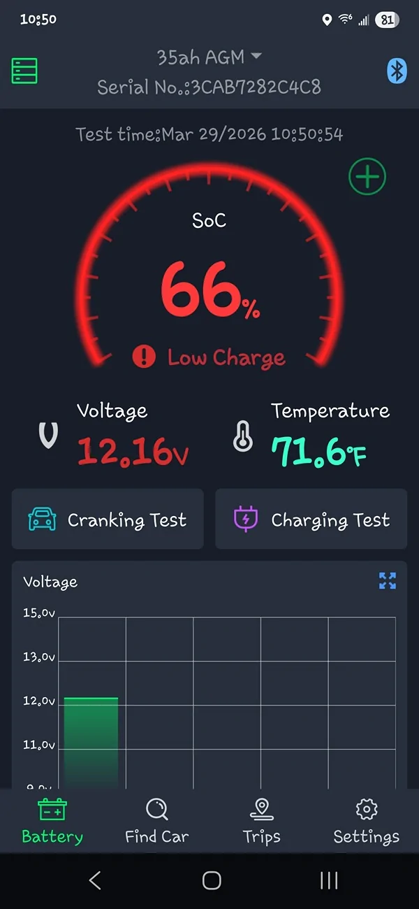

Yeah it still does on my truck. Apparently they changed a lot of things for the 25 year model.

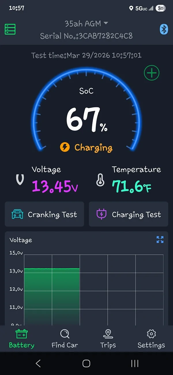

1st pic is vehicle off, 2nd is running.
Yes, the DCDC is on when the truck is on, so you'll see a higher voltage compared to when it's off.
13.4V is more of a "power supply" (float) mode, and isn't used for charging.
Bulk/absorption (ie. charging) is around 14.5V for an AGM.
