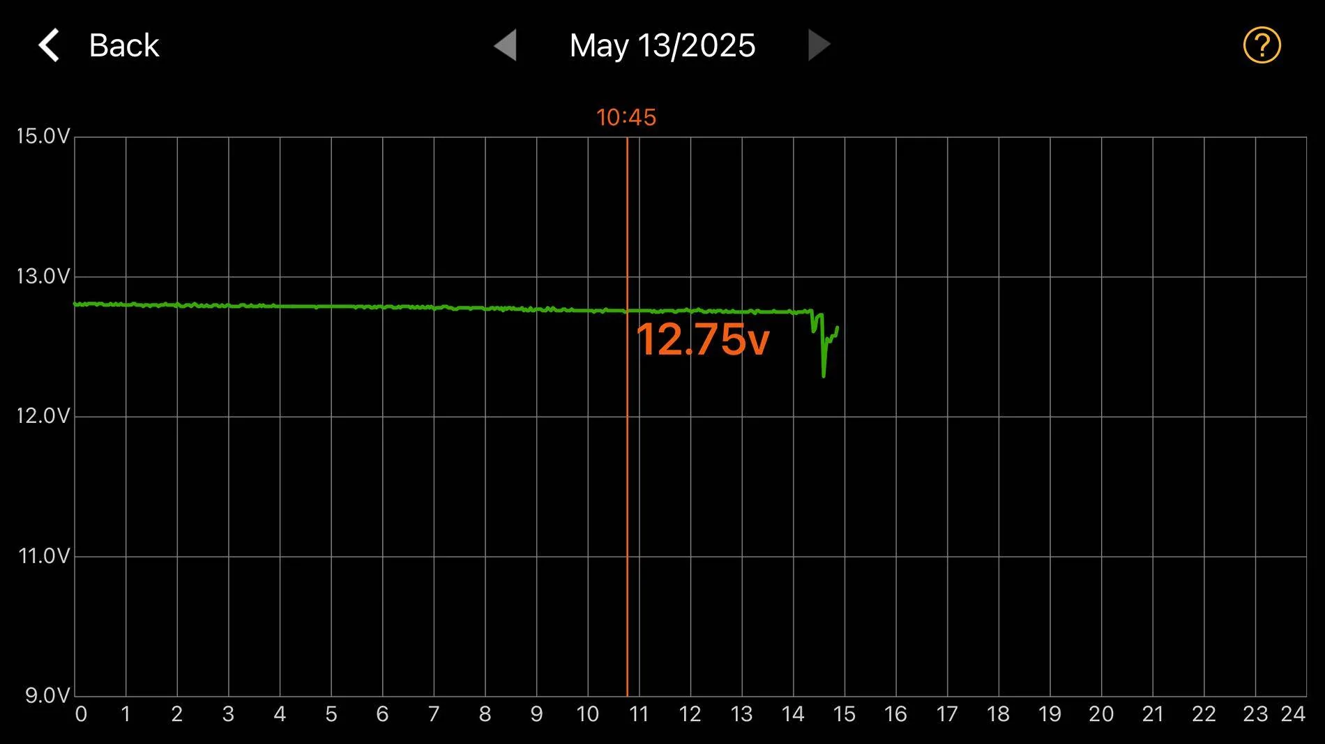

I installed an ANCEL battery monitor on my 24 Flash. It provides great information about the 12v battery SOC including while the truck is off. I haven’t driven today - the blip at the end of the graph is the voltage drop from using the keypad to unlock the truck.
