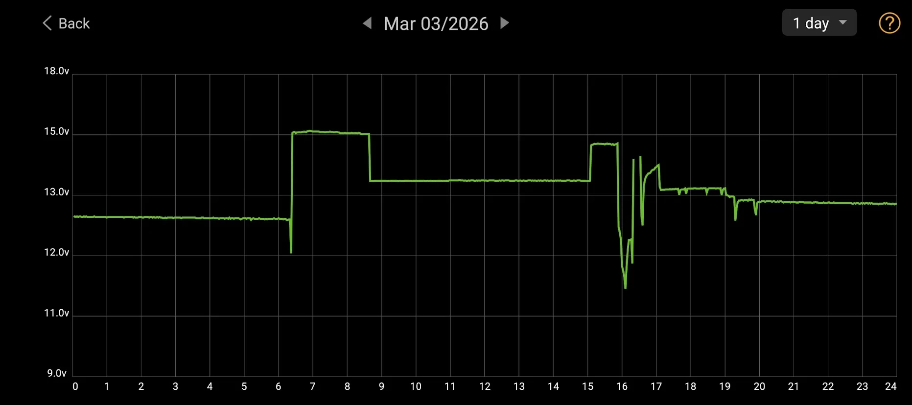

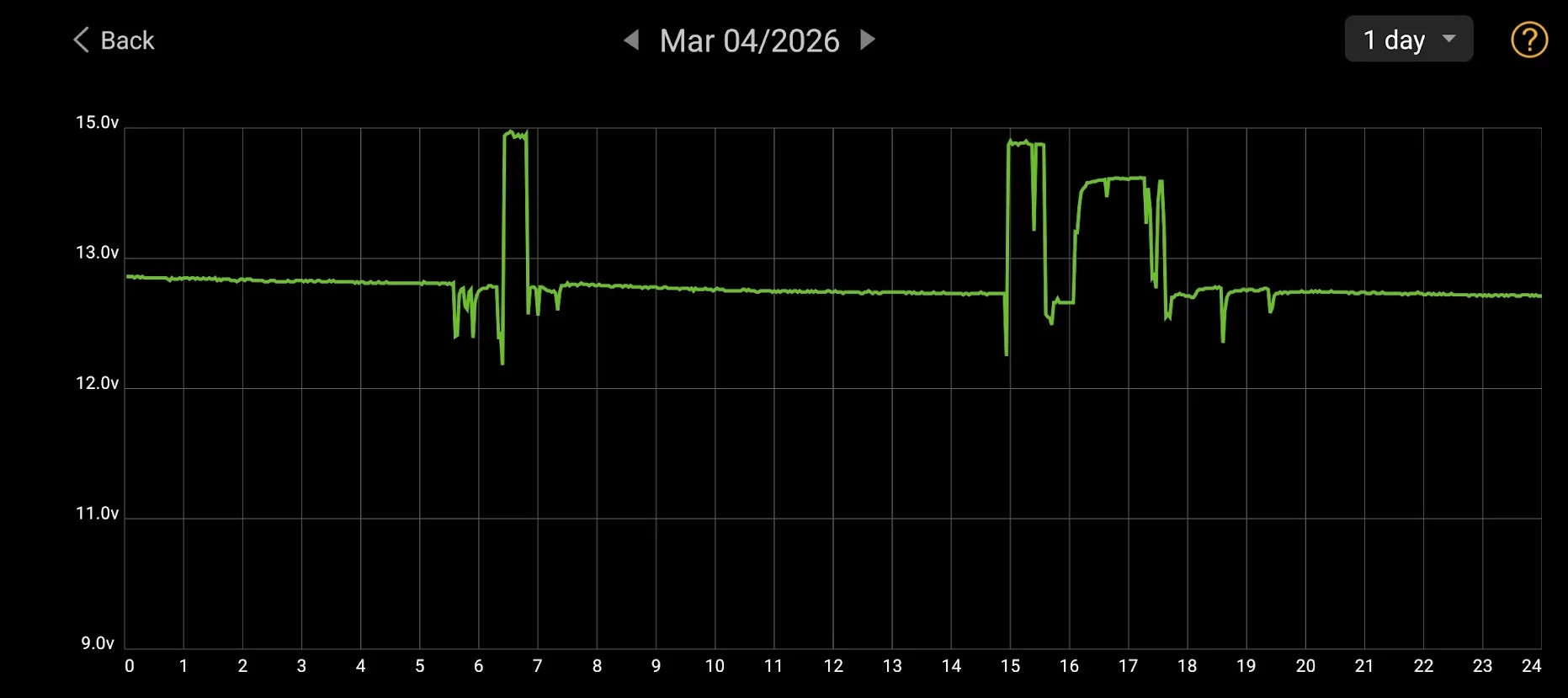

So answer me this: After I ran the repair procedure with the Noco 5 my battery measured 12.98 volts, yet the software update aborted due to inadequate battery charge.
Probably not good under load. The first image below was the drive to work, followed by 8 hours of level 2 charging and then the drive home. Truck prompted me for the PT### charge port update when I got home so kicked it off figuring the 12v said 98% in car scanner. You can see the big dip where it failed before it likely kicked the dc-dc inverter on to recharge. The next day I was, the Sirius XM update installed on the drive on and I was once again prompted to install the charge port update. This time I hooked up my power supply set at 14.1V like when I use FDRS and the update installed with no fuss. Took about 9 minutes.
