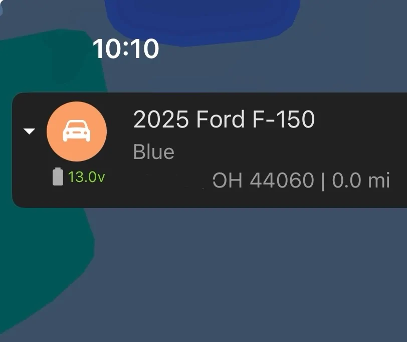

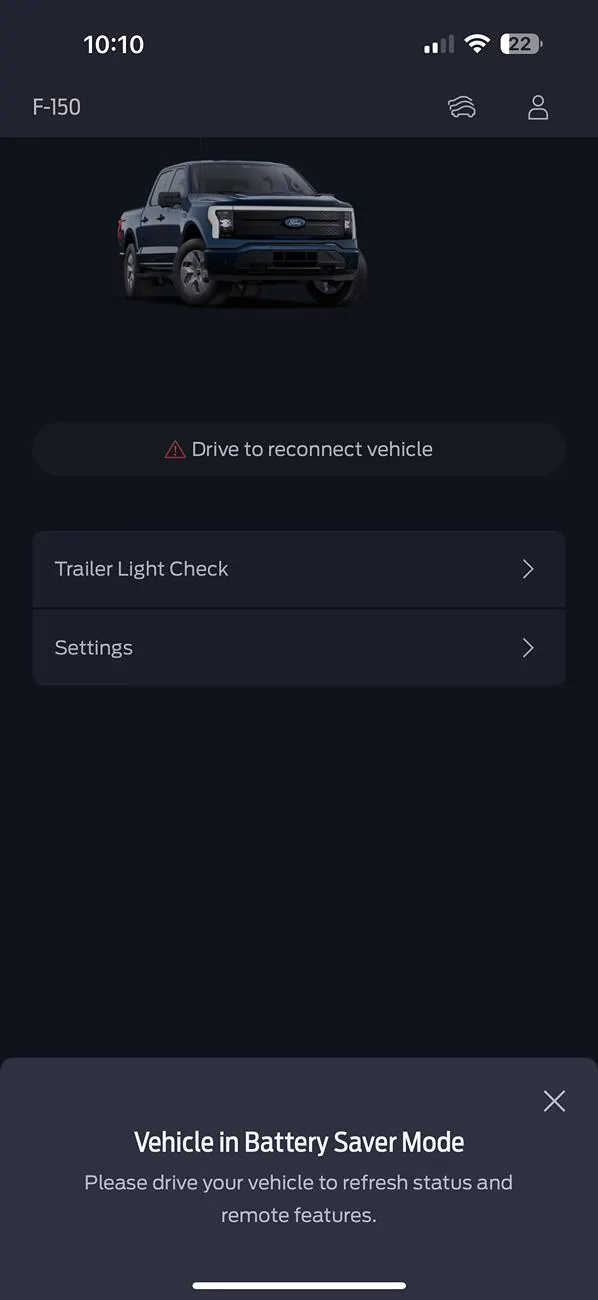

Yeah, my issue is now pretty frequent on the exterior switch. I’m wondering if it’s causing a short as my truck has gone into “sleep” mode twice this week. Yet the battery is at 13V right this moment…..
That does seem a likely scenario -strange reaction for pushing the Frunk button, so wires crossed/shorted somewhere seems likely to me.
Are you using Home Assistant to check 12V in that screenshot? If so and you poll too often, that keeps the truck more awake and might drain 12V.
ClevelandBeemer
ClevelandBeemer
May 10, 2025
93
98
2025 F150 Lightning Flash 131kWh
This is from LowJack.
