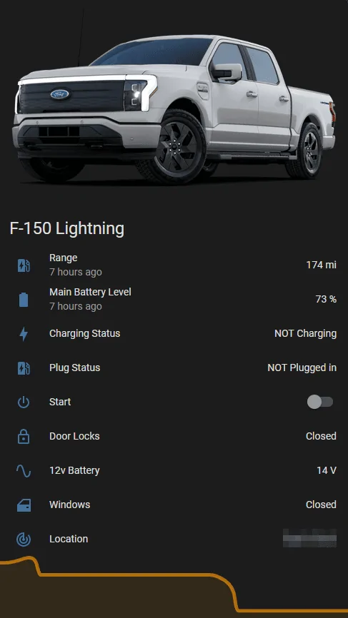

After several days of research and my attempt to gather information from Ford, I discovered the fordpass-ha integration for HomeAssistant (https://github.com/itchannel/fordpass-ha).
To use the API, I created a secondary account and set up a widget for my F-150 Lightning.
Ford F-150 Lightning Downloading Charge Logs lightning_hassCard
