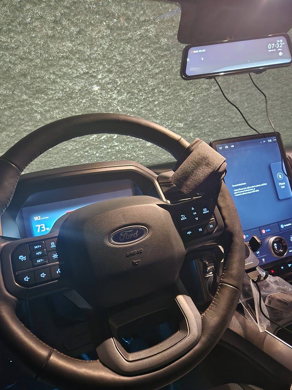

if it does not turn the cluster blue and have a steering wheel with “hands free” in it then it’s not going into BC. BC is hands free and once it’s in you really don’t have to touch the wheel. What you were experiencing was lane centering which is similar but requires a touch of the wheel every 15sec or so unless you hang a small weight like something that’s about a pound or so then you don’t have to touch the wheel.
Stuck one of these on. Little bulky but got rid of the constant nag on straightaways when using regular hands-on.
https://www.amazon.com/dp/B09KZQR7GQ
