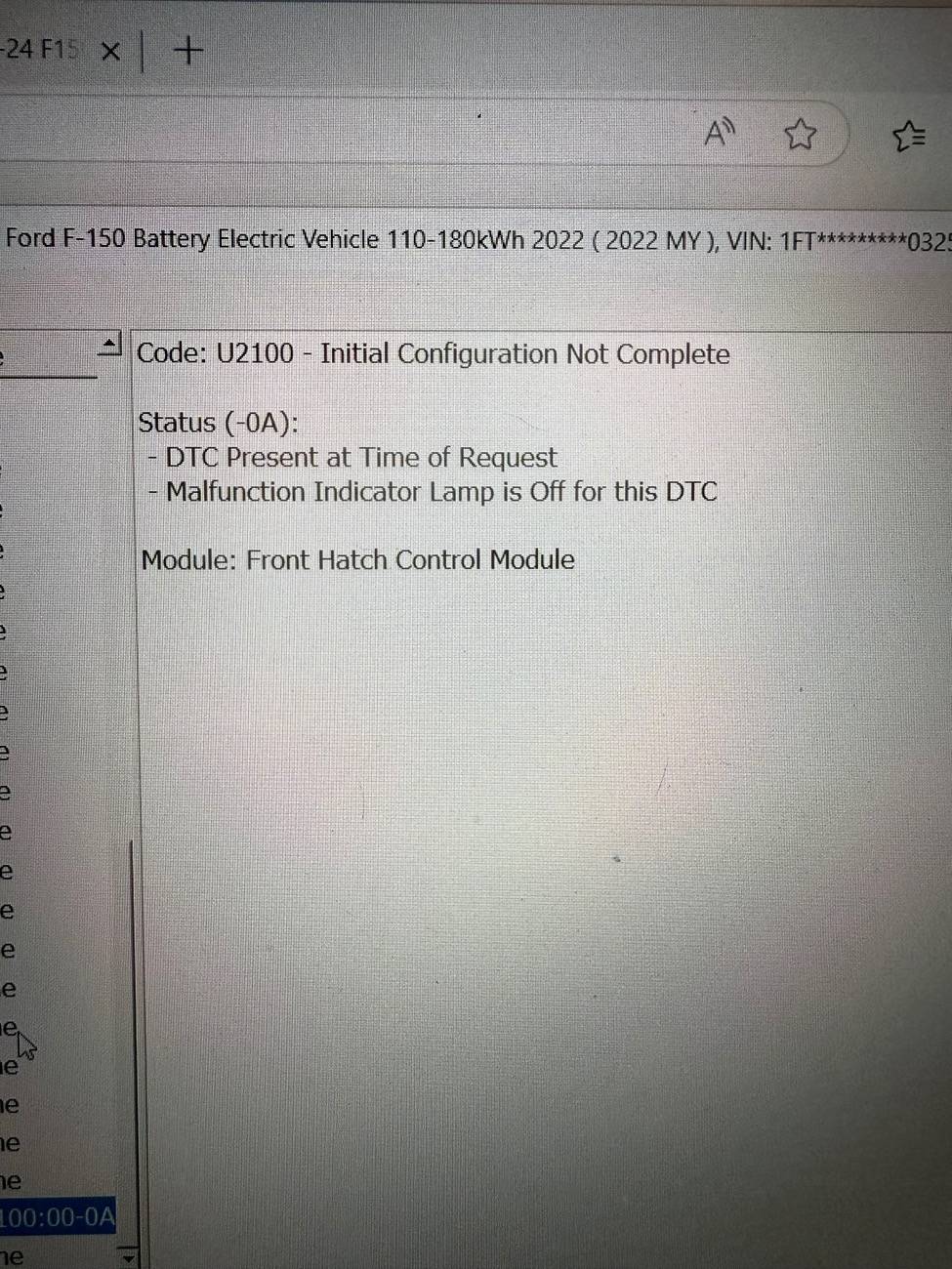

I made some Forscan changes to my truck this week. When I fired it up I had a fair number of DTC's that had previously been set, so I cleared them. However I've got one that won't clear, U2100 for the Front Hatch. U2100 is "Initial Config not complete", so it is a bit interesting. Any insights?

Thanks for the input. Everything is working fine and I haven't made any Forscan changes in about a year. I've had all of the Ford OTA updates (except BC 1.4) including FHCM-24.AC.AD and BCM-24.5.1 which both list Frunk improvements in their description.
This code was present when I started Forscan a few nights back. I check and clear codes before I begin making any changes. All others codes cleared.
I opened and closed the Frunk a couple of times and it operates normally. I don't recall if there is a PMI for that module. I can look and try a reboot to see if that helps.

Send me your vin. 2100 is initial config not completed. Which would be fixed by a write all in forscan
THe other possibility is the module was not programmed with the correct files. If you have to wrong file or it wasnt flashed that can cause a 2100. New modules that were not flashed will throw a 2100
2101 Incompatible config would be caused by a forscan change

Many thanks to @Jesse-Infotainment for his knowledge and help. I'm sharing with his permission in case others have the problem
With his knowledge, he could see the DTC was set on the day I got SW release FHCM-24.AC.AD. It appears the update didn't write the new As Built config. So it's not related to any Forscan updates I did, but using Forscan I was able to fix it.
My module data did not match this on two different lines. It's a small module, so just compare all lines IF YOU"VE RECEIVED FHCM-24.AC.AD and then Write All.
