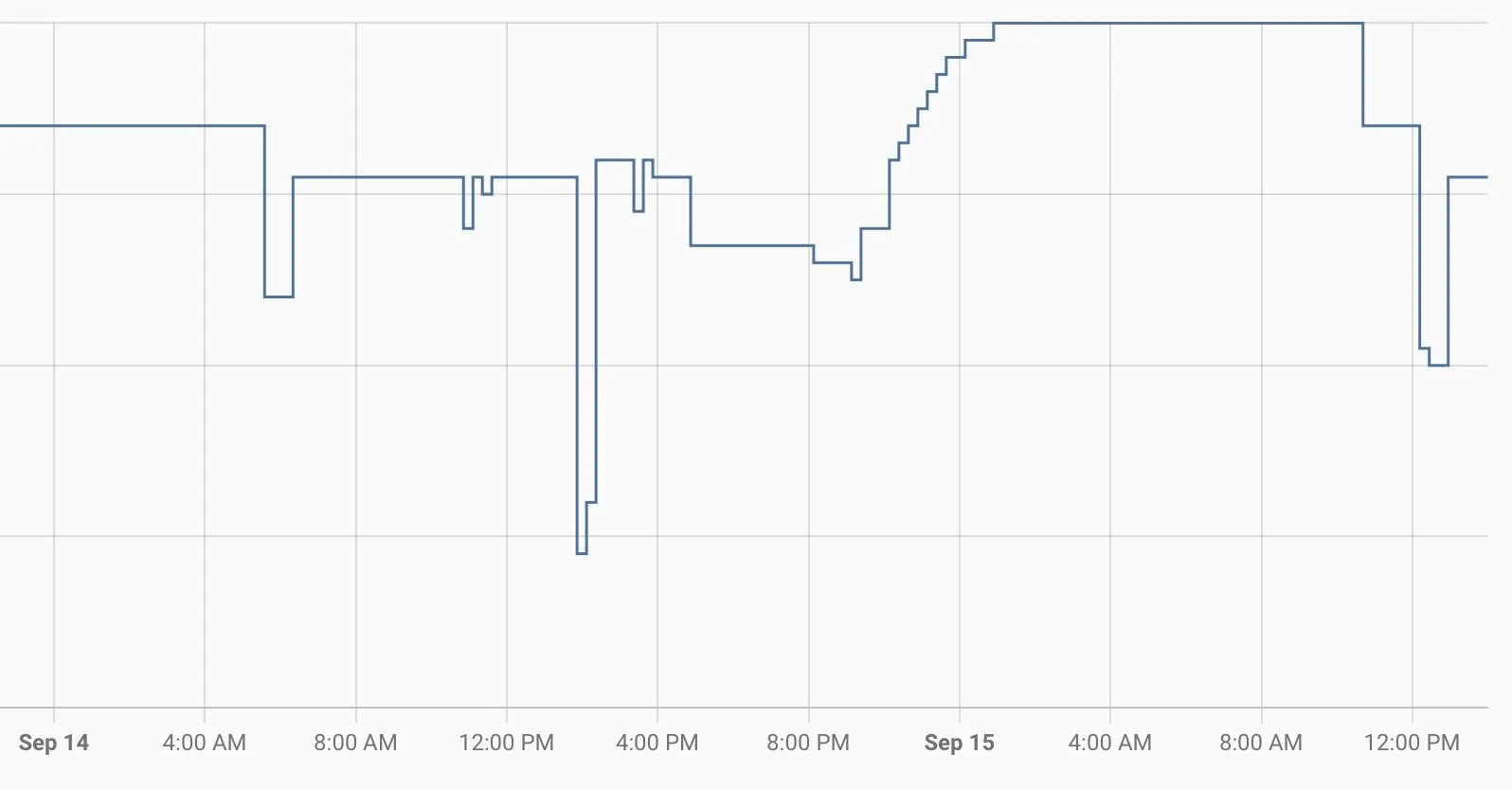

Had the dealer do 23B70, 24B56, 24P24 and my 12v battery is still not holding enough charge to get updates (says OTA Team), they say it's at 81%.
Can I request a new v12 under warranty or will they be able to tell after diagnostics?
The battery would have to fail the Rotunda battery test in order for warranty to cover it.
