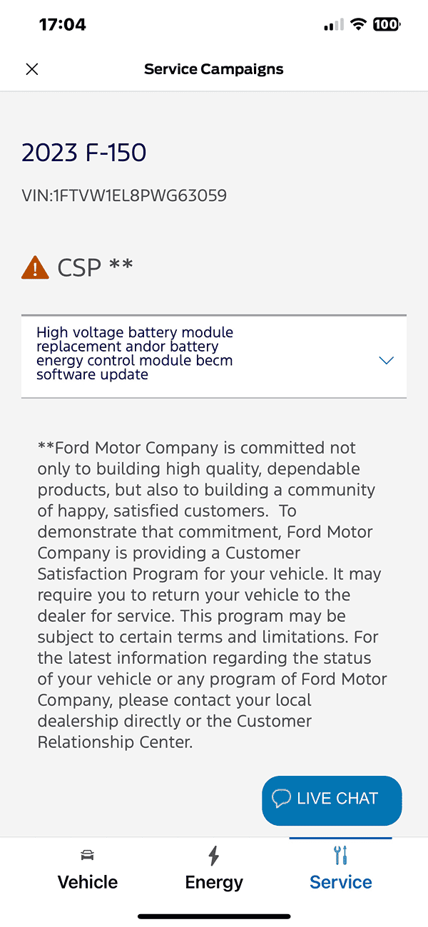

I will post an update after next saturday’s appointment, the service advisor at Ford of Clermont here in FL was very confident they could do the diagnostics and apply the appropriate repairs called for. he wasn’t 100% on parts availability on that saturday however if it needed replacement battery modules themselves.

I was on the phone yesterday with Ford BEV Engineering Support concerning getting CSP 23B57 installed on my 2023 Lightning and they told me that the ECG-24.2.4.10 update just distributed changes the packet size of the updates being sent to avoid errors on the previously used larger packet sizes over the cellular network used to communicate with the trucks.
They also told me they stopped distributing CSP 23B57 Over The Air because of its size causing these issues that ECG-24.2.4.10 is supposed to address. Where the trucks were left in a disabled performance state until you went to the dealer. You currently can ONLY get CSP 23B57 installed at a dealer after they run a diagnostic on your BMS and installed batteries. I am scheduled for Saturday Aug 24th to have this done.
Everyone should check on the FordPass APP to see if you are eligible for CSP 23B57.

I took my 23 Lightning into Ford last weekend for the CSP 23B57 and they said OK but then called me an hour or so later and said Ford wouldn't let them apply the update. So all that BS for nothing. They couldn't find out why it was being held up but Ford said another few months before they release it again. The tech suspected something major was coming as far as battery testing which is the big part of this BSP.
