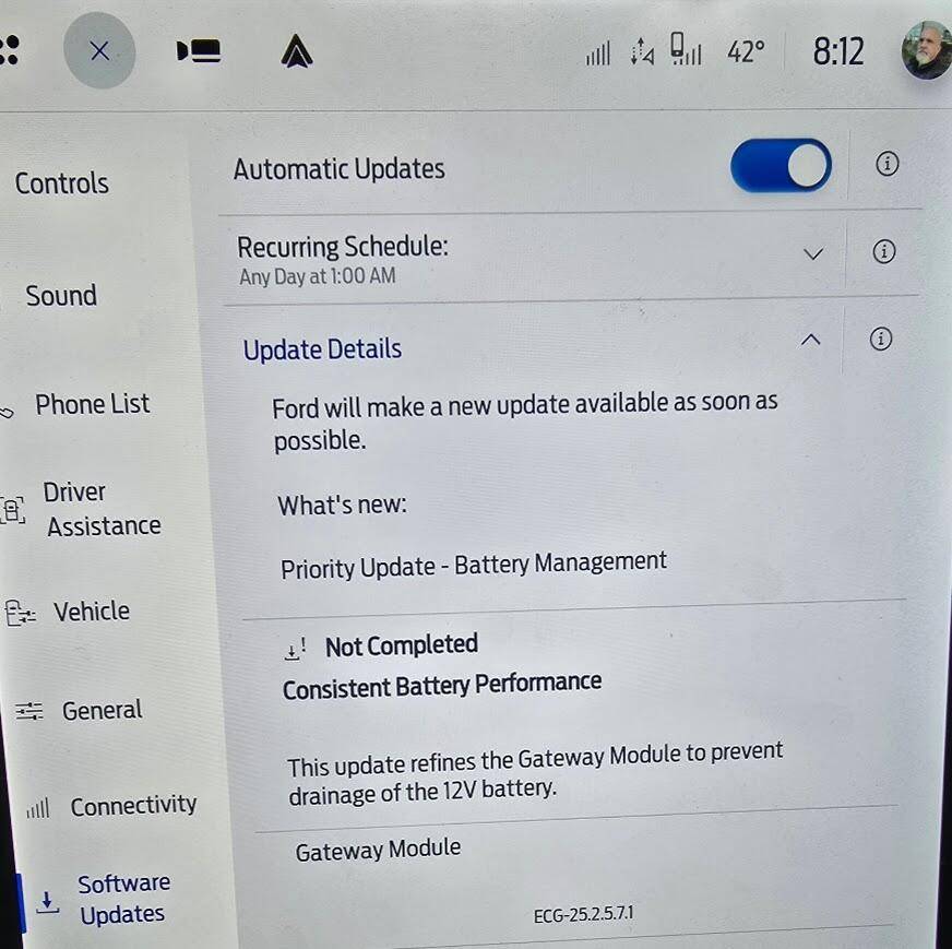

Reached the coffee stop a little after 8, checked my updates status as I do every morning seen this alert, the download wasn't complete yet:
Ford F-150 Lightning ECG-25.2.5.7.1 - Consistent Battery (LVB) Performance 1742477017829-1

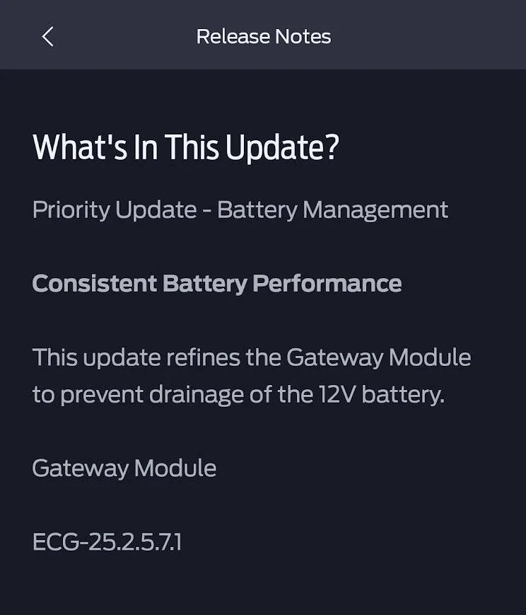

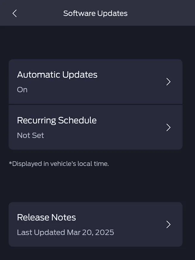

I left the truck running with the 30 minute timer switched off, lights off an blower motor set to 5 to allow the LVB some time to charge up while we had breakfast & coffee. Returned home, parked the truck, powered off, powered on, off, on and finally off. Went inside the house and within 5 minutes got this alert on Fordpass.
Ford F-150 Lightning ECG-25.2.5.7.1 - Consistent Battery (LVB) Performance 1742477194275-kl
Ford F-150 Lightning ECG-25.2.5.7.1 - Consistent Battery (LVB) Performance 1742477172593-u8
