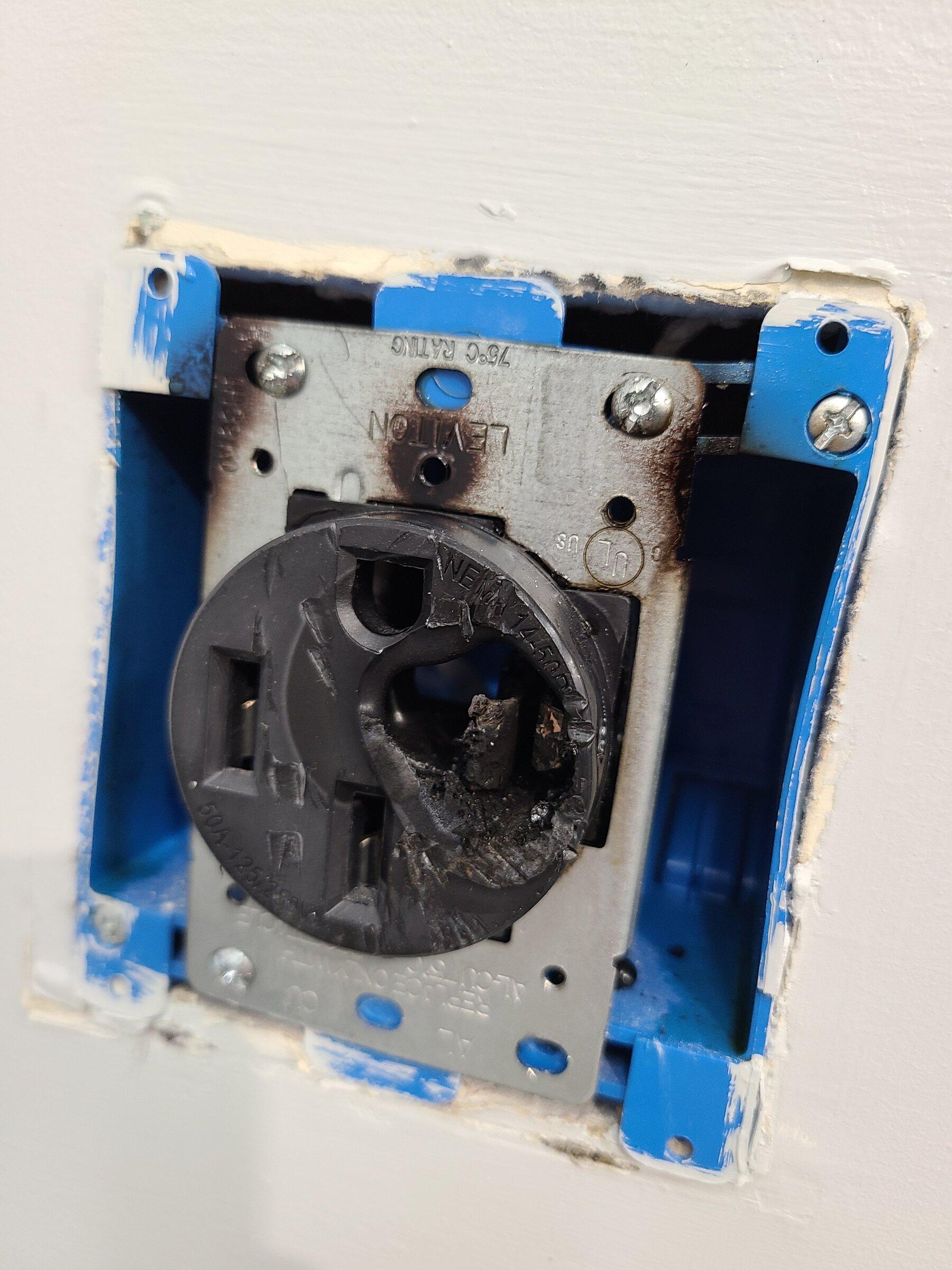

You’re correct. I note again that I never said it drew 50 amps. It is max rated for 50. There are reports of idiots “Tesla model 3 forum”running a 60 Amp breaker to 14-50 and the destroying the Tesla mobile connector.
Wha? How's that? The gen2 Tesla UMC is also only rated for 32A. Gen1 was rated for 40A and has melted a few cheap Leviton receptacles though since there was no temperature sensor in the plug on the gen1...
Ford F-150 Lightning Extension Cord “Charge Kit” 20220302_211915
Do you mean some people blew up their gen1 UMC because someone installed a 40A breaker on their 14-50 circuit? That's apparently possible and legal due to an exception in the NEC, though I still think it's weird.
