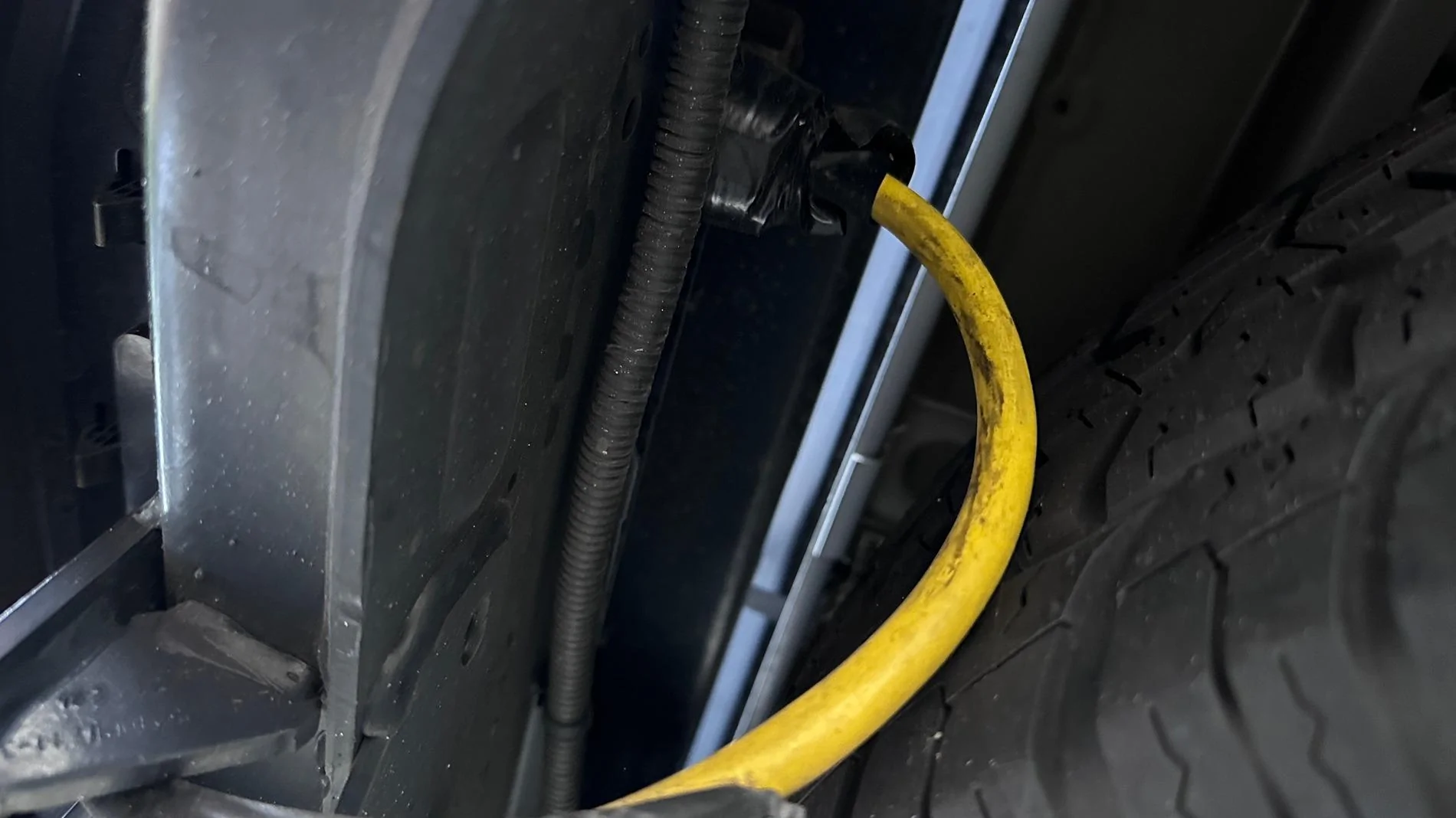

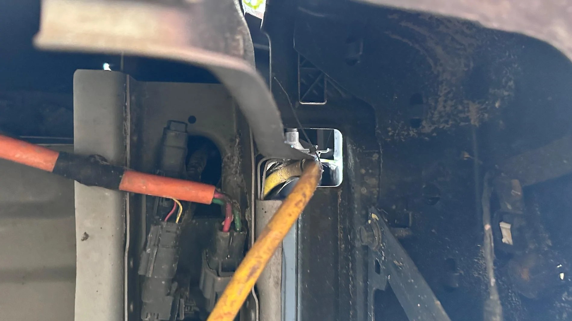

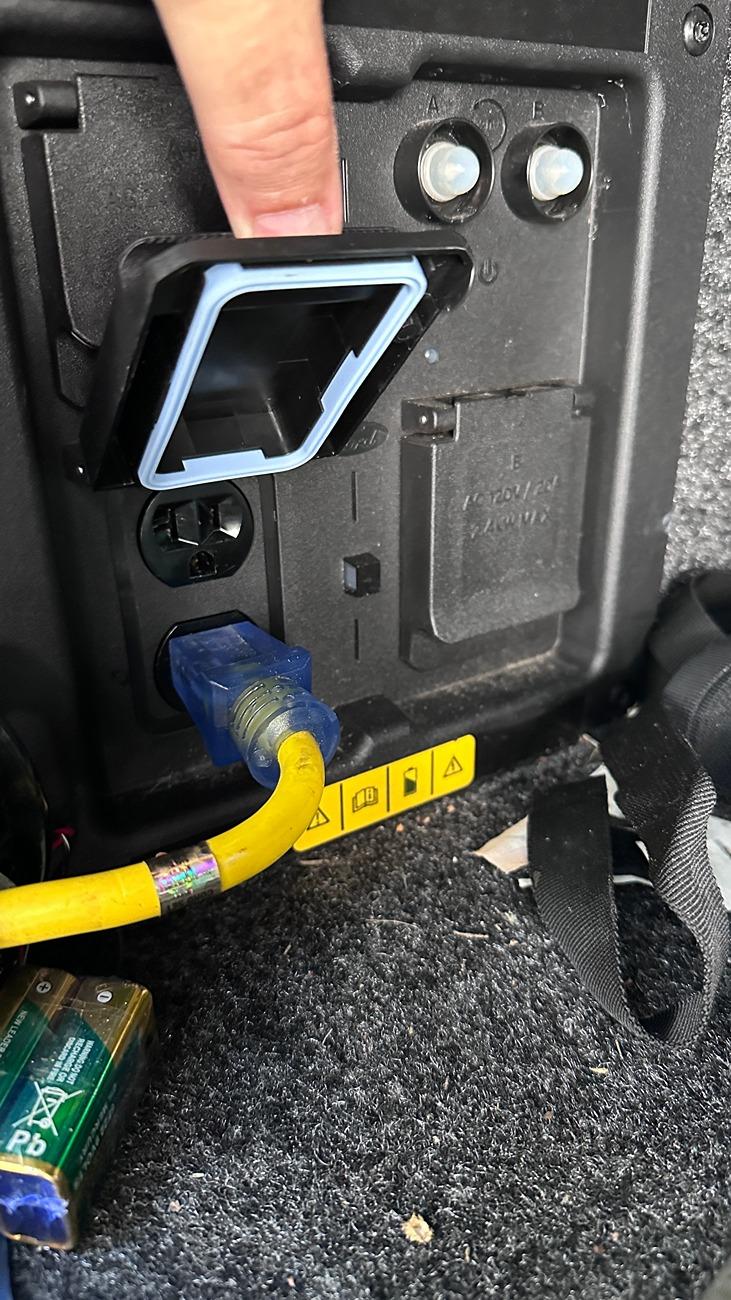

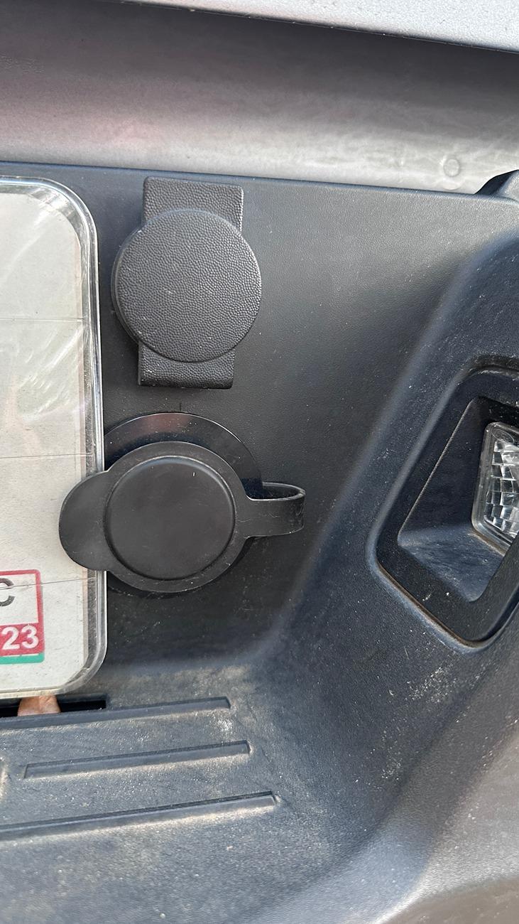

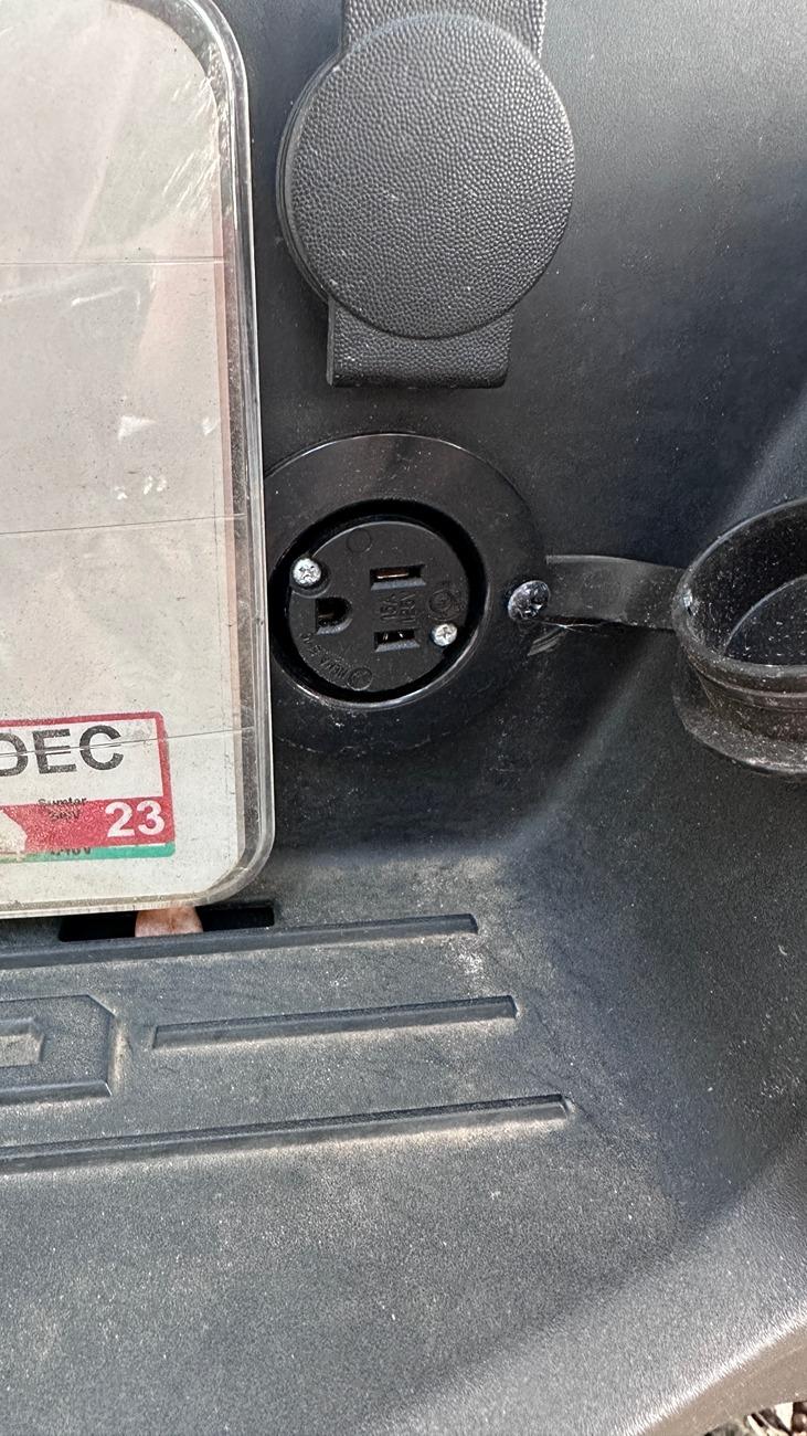

I've done something similar, for towing our 20' single-axle camper, over 20,000 miles, but simpler:
I use one of the bed's 20amp outlets, which actually provide each a 30amp 120v Output... PLENTY for anything while towing, and, actually, PLENTY even when camping... we even power the roof air conditioner WHILE TOWING, if needed...
so... here's what I did to make it the easiest and simplest method for providing 'while towing' power to the trailer/camper, etc...
A) I used a simple 20amp 10' 'construction grade' extension cord, plugged into one of the bed's outlets.(shown below)
B) I snaked the extension cord down thru the tailgate edge, to underneath the tailgate, into the bumper area, around and thru some bumper mounting hardware, and...(shown below)
C) cut off the other end of that same extension cord and wired it into a 'thru wall' 20amp OUTLET(shown below)... which is mounted thru the 'tag plate' area just under the spare tire access cover. It matches perfectly.
Now, you have CONSTANT power to anything you want to 'plug in' to your 'bumper...
D) for us, the object of providing power while towing becomes a question of 'slack' in the connection between the truck, the extension cord, and the trailer/camper... this is accomplished by using ANOTHER similar extension cord, which plugs into the new bumper outlet of the truck bumper, and then snakes back over the hitch, and into whatever 'method' you want to use to get power to the trailer:
E) since our small camper has a 30amp 120v shore cord, but one that exits out the driver side, near the rear, we used the 'extension' cord from the truck, snaked under and thru the trailer's framing(which had nice large holes almost perfect for this application), and up to the shore cord, where an adapter was used to connect the two.
Works great.

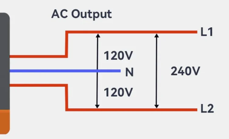

now, if you are asking about my previous comment that these outlets provide 30amp output, it is true: Ford uses a 240v Inverter for this whole 'box' of outlets, including, of course, the 240v 30amp twist-lock outlet. These 4) '20amp' household type outlets get power from that SAME inverter, and therefore are actually tested and confirmed to have up to 30amps of 120v output, each, although 30amps, at 240v, in TOTAL for all output(that's actually 60amps at 120v).
Now, does this mean you will ever NEED 30amps from this type of outlet? Probably not, but you certainly can see that if you have a trailer/camper plugged in, either while traveling, or even while OFF-GRID camping, you can actually be comfortable with running a roof air conditioner, if needed.
I'd be cautious about pulling 30A on '20amp' household type outlets" which could be damaged by doing that. I wonder if the 20A circuits are using heavy enough wire for 30A as well.
I am surprised that, from what you seem to be saying, the 120v outlets are not on a separate 20A circuit breaker that would trip if over-current (30A) is detected.
I haven't seen any detailed wiring schematic of the ProPower system, but I assume that the 7.2kW inverter runs all the bed outlets, and the 120v are wired from the two halves of a 240v split phase inverter output (as in the image).
If that is the case, I can see how they could theoretically be capable of 30A, which is the current rating of the 240v inverter output, but I would have thought there would be a separate circuit breaker for the 120v outlets.
Ford F-150 Lightning External / Outside Access to 30A Truck Bed Receptacle split phase inverter
Is there a source link for the wiring of the ProPower 7.2kW system, I'd be interested in seeing how that works?
It would seem prudent to use the 80% rule and not pull more that 16A from a 20A circuit or 24A from a 30A circuit for continuous loads.
