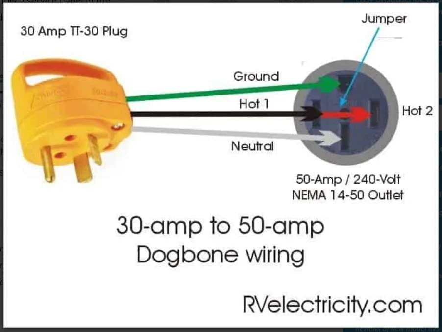

True, you CAN use a dogbone adapter on the 30A 120v campground outlet
there's no reason not to charge your Lightning from your RV's own 120v exterior outlet if you are going to go thru the motions of trying to adapter your EVSE to a 120v 30amp campground outlet - the results are the same: 8-12 amps, at most, of 120v charging, which will take forever, but is feasible if that's what you wish.
In my camping experience, I would use the 50 amp 240v outlet for the LIGHTNING, and use an adapter for the RV to the 30amp 120v outlet, as the RV uses MUCH LESS power than the LIGHTNING, for sure... most ANY camper or RV can survive very easily on 'only' 30 amps, and most campgrounds ONLY have 30 amps.

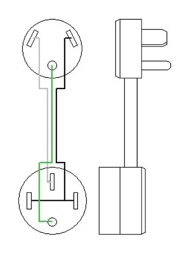

Yes, you CAN plug a 50A trailer/camper into a 30A campground out let IF:
1) you don't have any 240v requirements inside the camper/RV and
2) you won't exceed the 30A limit, i.e., you don;t need the full 50A of the other outlet
Ford F-150 Lightning Using the truck bed 240v outlet to power an RV 14-50 to tt-30
This is what the wiring is (att-30 plug at top to 14-50 receptacle at the bottom).
As you can see, you only 120v not 240v.
Ford F-150 Lightning Using the truck bed 240v outlet to power an RV tt-30 to14-50 wiring
See: https://www.rvtravel.com/hooking-up-50-amp-trailer-to-30-amp-service-at-campground/

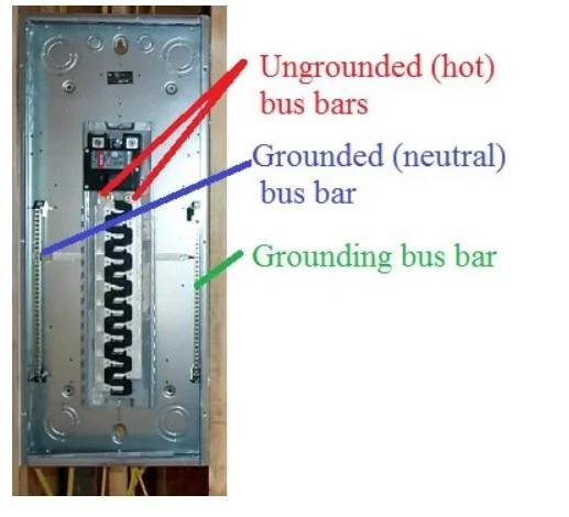

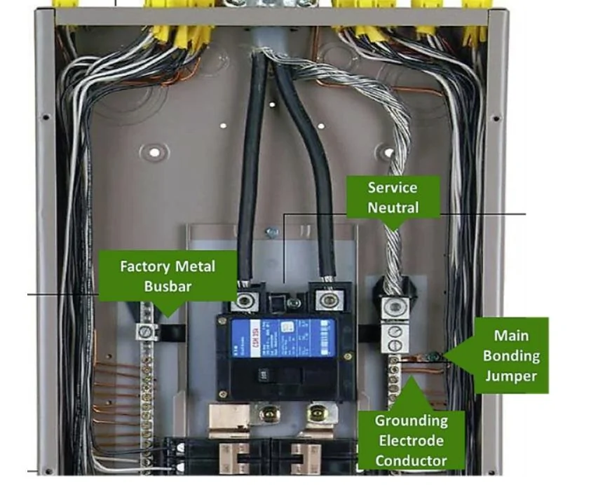

You might see two bus bars/terminal bars, one for ground wires (usually green or bare) and one for neutrals (usually white) and a metal piece that connects the neutral bus to the frame of the panel. That is the bonding piece.
If you are going to unbond the panel neutrals, ONLY do that BEFORE you will be powering it by the Lightning or other bonded generator. Do not do it, bond or unbond the neutral bar, while the panel is powered - risk of accidental shock.
If inside the panel the white (neutral) wires and the green/bare (ground) wires are connected to the same bus bar/terminal bar, then you will have to rewire it so they are on separate bars, and then unbond the bar with the whites - usually only one bus/terminal bar can be unbonded.
Definitely seek guidance from the manufacturer and/or a licensed electrician.
Here is an image of an panel before wiring or breakers have been put in showing a typicaal split phase arrangement:
Ford F-150 Lightning Using the truck bed 240v outlet to power an RV Unwired panel
The next pic shows the neutral bus bonding jumper - you'd have to remove that to unbond the neutrals in the panel, the put it back to bond the neutrals in the panel.
Ford F-150 Lightning Using the truck bed 240v outlet to power an RV panel bonded neutral
Some times, it may not be possible to unbond the neutrals. In that case, the solution is a transfer switch as mentioned before.

PS:
You would never UNBOND your home main service panel! The above main service panel is only for illustration. Just like you should never unbond the Lightning ProPower generator output receptacle neutrals.
You should however unbond the neutrals permanently a sub-panel to which the main panel is wired in an unattached building for example, per the NEC.
Your RV panel may not be wired as neatly as the above, alas. So getting to the neutral bonding jumper could be difficult, it may be obscured/blocked by wires.
You want to put a warning somewhere on the panel that is has been unbonded when you do that.

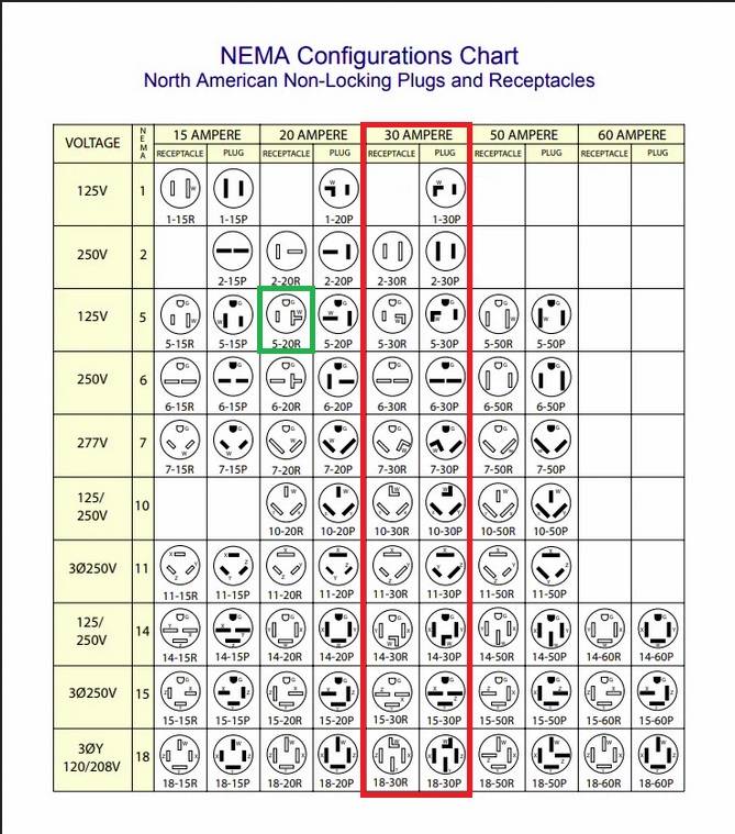

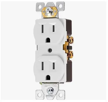

Yes, they do provide up to 30amps of output, regardless of the 'size' of these outlets, because the 240v inverter is a 30amp type. Ford using what is normally considered '20amp' outlets does not change this, or somehow make it 'unsafe'. The outlet does not care, and almost no one would ever use this amount of power from one of these outlets for very long, regardless.
I have to respectfully disagree with that proposition.
Putting a 30A load on a receptacle designed for 20A would be a bad idea and could result in a fire or at least damage to the receptacle and/or the wiring if the breaker didn't trip fast enough.
Electrical codes would prohibit using a 20A outlet to carry a 30A load, and I imagine Ford would follow the codes.
Outlet types are made differently intentionally to AVOID plugging in loads that would result in an over-current situation. Because 20A outlets would overheat IF they were carrying 30A, they are configured differently from 30A receptacles.
A 30A rated outlets do NOT look the same as a 15A or 20A rated outlet. See the NEMA chart.

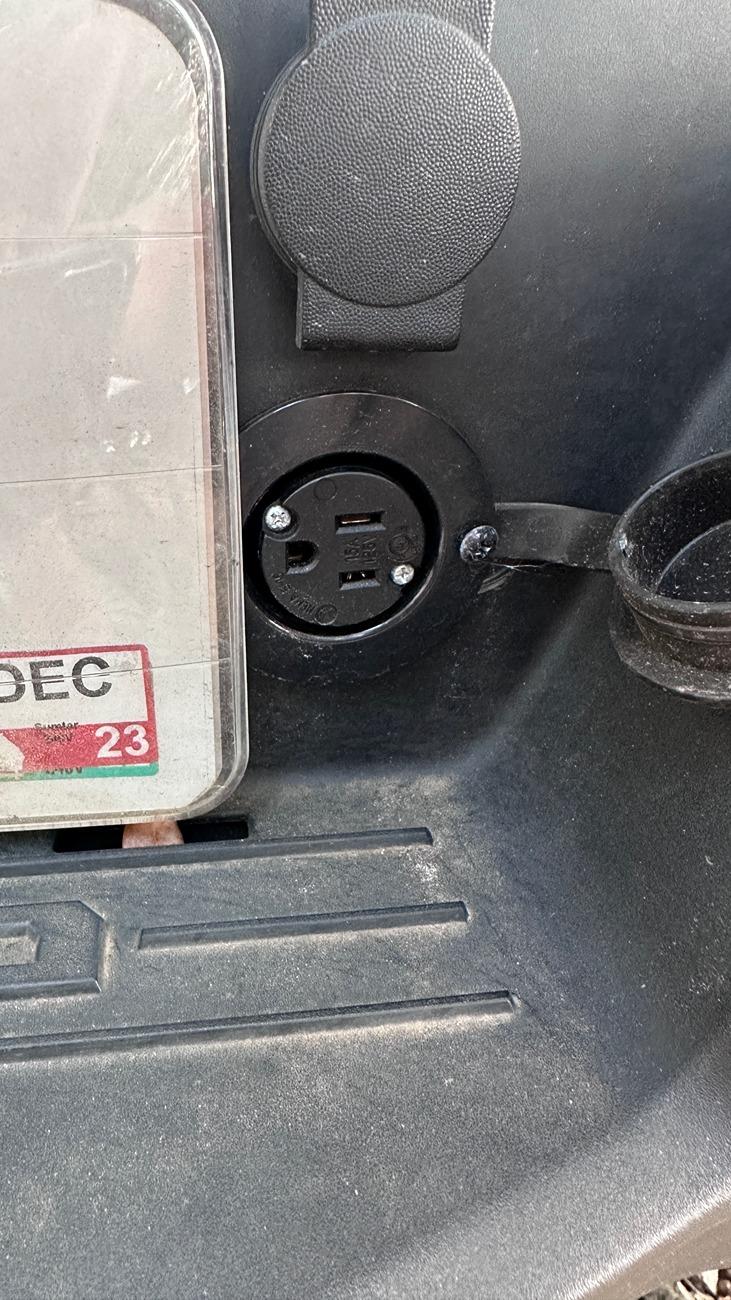

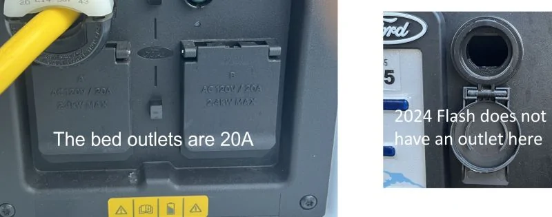

Ford F-150 Lightning Using the truck bed 240v outlet to power an RV NEMA receptacle chart
The outlets in question are clearly 5-20R duplex (2 in one box) receptacles (green outline in chart) - note the left-side pin hole in the image below has a horizontal slot in the middle which differentiates it from a 15A receptacle which does not.
Ford F-150 Lightning Using the truck bed 240v outlet to power an RV 20A receptacle in lightning bed
Ford F-150 Lightning Using the truck bed 240v outlet to power an RV typical 15A receptacl
Bed 20A duplex receptacle vs typical 15A receptacle
Also, the wire used has to be sized correctly for a load. If it were 30A, #10 CU (or #8AL) would be used. If it were 20A, #12CU (or #10AL). Like receptacles, wire is also rated by maximum load amps. Overloading wire is also a fire hazard.
Any breakers associated with the 20A outlets have to be sized accordingly - the ones in the Lightning trip at a hair above 20A from some accounts.
If they were carrying a 30A load, hopefully the breaker would trip BEFORE any damage was done to the 20A wiring or 20A outlets.
So, just suppose the receptacles really COULD carry 120V 30A each. 4 x 30A x 120V = 14.4kW power, and we know the bed DC-AC inverter is rated at a max of 7.2kW.
So, for the above reasons, I think the proposition that the 20A receptacles can carry or were designed to carry 30A must be wrong. It would be bad (dangerous) design and non-compliant with electrical codes to configure an system where 20A receptacles could carry 30A.

The code for generators with bonded vs unbonded neutrals, and the grounding requirements is a bit hard for non-electricians or engineers to read through and comprehend, but I think it can be understood and summarized pretty well from this video:
The safest solution where your source is bonded like the Lightning is to use a neutral switching transfer switch, and any bonded source should also be grounded to earth.
Removing the equipment gound connection wire to avoid the nuisance tripping is generally a bad idea.
If you want to use both a bonded source (generator or Lightning) and an unbonded source (standby generator) with a neutral switching transfer switch you can simply use a bonding plug with the unbonded generator source:
https://www.microair.net/products/generator-bonding-plug
The only thing I believe they got wrong in the bonding plug text is that bonded sources/generators should also be earth-grounded to compy with code and they suggest otherwise .
Scenario C at minute 1:45 of the video where the is a neutral switching transfer switch and a bonded generator show that the generator needs to be earth-grounded so that the bonded neutral is also earth-grounded at the source in case there is an equipment ground disconnection somewhere downstream of the source (the way your utility supply neutral is grounded at the pole for example).

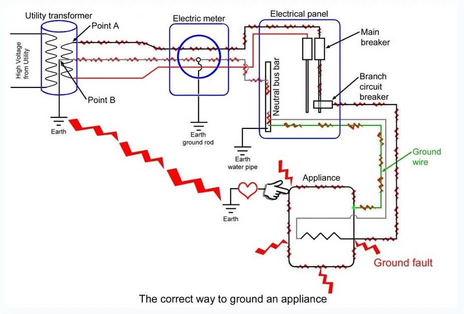

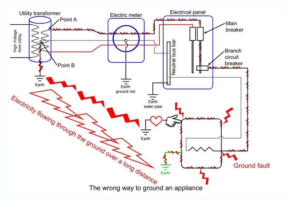

Ford F-150 Lightning Using the truck bed 240v outlet to power an RV neutral grounded at the pole and service panel
https://nationshomeinspections.com/electrical-grounding/
With no ground wire, like your old house scneario, it's a problem:
Ford F-150 Lightning Using the truck bed 240v outlet to power an RV No ground wire - neutral grounded at the pole and service panel

SOLVED: but, with a catch...
A) REMOVED the GROUND wire from the extension cord between the truck's 120v bed outlet and the camper's shore cord.
I realize now that removing the ground pin MAY NOT be required for ProPower to successfully power my CAMPER, while towing it...
a little history, though, first:
A) the reason I ran into the 'ground fault' problem with ProPower was initially thought to be a 'GFCI'-like ground problem with the oversensitive ProPower system... and,
B) therefore, I removed the ground pin from my extension cord to the Camper, and yes, Voila, it seemed to work just fine... although,
C) I started to run into 'ground fault' issues with ProPower from time to time, for seemingly no apparent reason. Sometimes at initial plug in, and sometimes just 'as we were traveling'...
D) sometimes resetting ProPower several times would overcome the issue, sometimes, especially lately, it would not...
Today, though, after researching the issue more, another fellow online 'camper' owner came to the rescue. They had a problem simply plugging their camper into their home's outside GFCI outlet, without the outlet constantly 'tripping'. Using a 'standard' outlet was no problem, but any GFCI outlet would not work.
They realized, too, that they had recently burnt-out their onboard electric water heater ELEMENT.
ahhhhh.... this is the moment of realization.
My camper also had a burnt-out water heater ELEMENT, since the day I bought it.
so, the ultimate 'answer' to why the GFCI issue can into view was simply because the water heater ELEMENT, while burnt-out and failed, was STILL wired to the electrical system, and, even with it's breaker OFF, it continued to present 'leakage' symptoms, and therefore the GFCI issue.
I removed the wires from our burnt-out element, and, VOILA.... NO More GFCI issues when plugging into the house, and NO MORE 'Ground Fault' errors with the truck's ProPower! AND< no need to remove the 'ground pin' from the camper's extension cord to the truck, either!

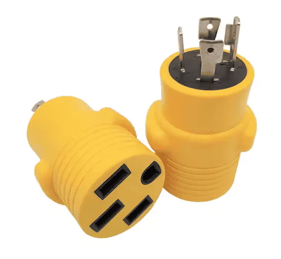

while my SOLUTION worked perfectly the whole trip to, and from, the beach, during VERY hot weather, and with the roof air conditioner, which is 15,000btu, running, as needed, the whole time, it's amazing how a simple little wire, in a non-working water heater, with it's breaker OFF, could, otherwise, create such issues...
now, having said that, some camper owners will likely want to know 'how' to power the camper, WHILE towing... it's certainly, and easily, doable... it's not so much about 'which' of the truck's bed outlets you choose to use, either 240v 30amp, or either of the '20amp' outlets, but more of how you get your camper's SHORE CORD to this outlet...
without going thru all my own processes, mine has worked out to be a simple and easy option.
you could also just run it up and over the tailgate, or, I've even run it around the edge of the tailgate, thru a small opening, into the bed area...
if you choose to use the 240v option, that will require more work, but, also probably not needed while traveling- some of us have already realized that the other bed outlets are actually 30amps, themselves(120v, of course)... and few campers or RVs are actually even capable of using 240v power, so the 'normal' outlets work just fine. It's really about the same power as you'd be getting from the typical campground 30amp outlet - that outlet, though, is a different 3-prong design.
even with my 15,000btu roof air conditioner blasting, and since it has an optional 'soft start', my ProPower showed that the max wattage, at start up, and while running, was about 1700watts, max, even with other fans and stuff working - that's only about 15 amps, with everything. The battery charger is included in that. All that was running from one of the simple household '20amp' outlets in the bed. I would also doubt that you'd ever get close to 2,400 watts, unless you put the microwave in the mix, or the coffee maker, or the toaster, at the same time..... maybe.
mine was the coffee maker : which caused the truck's outlet FUSE to trip(we call these breakers, but they have a 'fuse reset' type button)... when you reset that, it goes back to working just fine.
