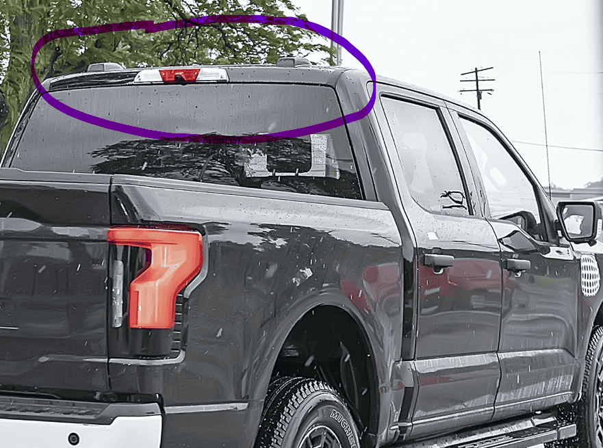

Spoiler on the cab, you say?
This truck was spotted near a Lightning that was charging at an EA station (black F-150 at left of picture is a charging Lightning).
Looks like something aero going on at the rear of the cab to me.

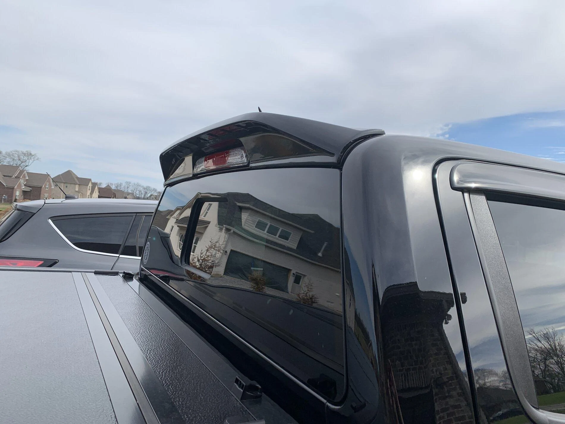

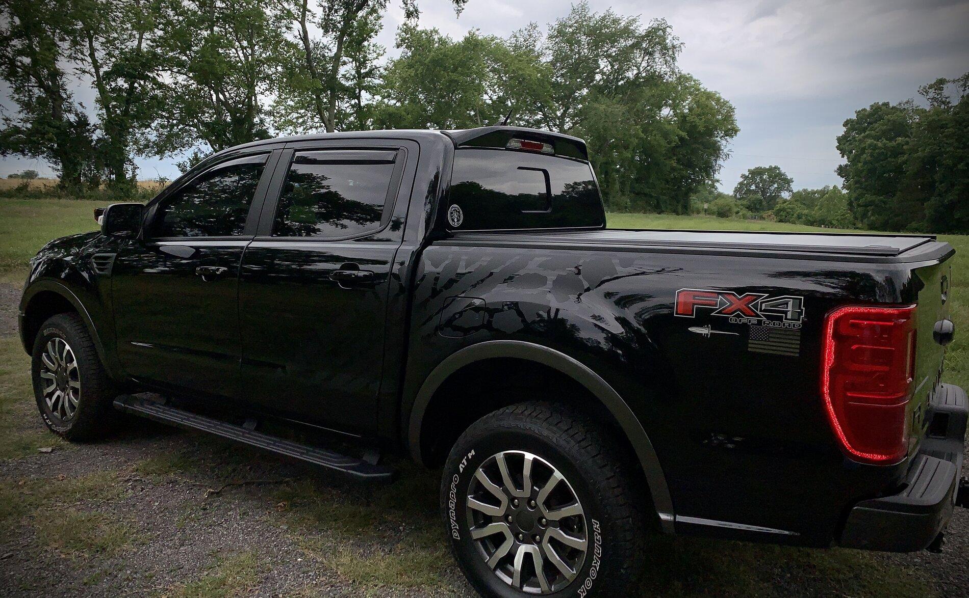

Not new. I put one on my '19 Ranger Lariat...
The test mules for this current gen had that same lip on the rear of the cab, but never made it into production. Could be a fake-out or maybe they will.
When you added the cab spoiler/wing and hard tonneau cover - did you see a difference in your highway mpg?
As far as aerodynamics go, depending on the cab spoiler/wing geometry (combined with a hard tonneau cover) it should almost be as good as a sloped/fastback bed cap.
Yeah, it may not be a meaningful difference on the gas version, but perhaps in the EV it is. For instance, if it improves range by 4%, but that takes it from 288 to 300 miles, then it's probably worth it to add $150/truck, cost.
Honestly don't remember. I always got good mpg with it.
IF you are going to put one on, it's easy. But if you have the Flipbak cover, that's a prob. To open them fully, the must lean against the back of cab. This will not enable that and can ruin the spoiler.
I did it for looks as I was building an Overland truck. I ended up getting rid of it and put a retract style cover on. Lesson learned the hard way. ;)

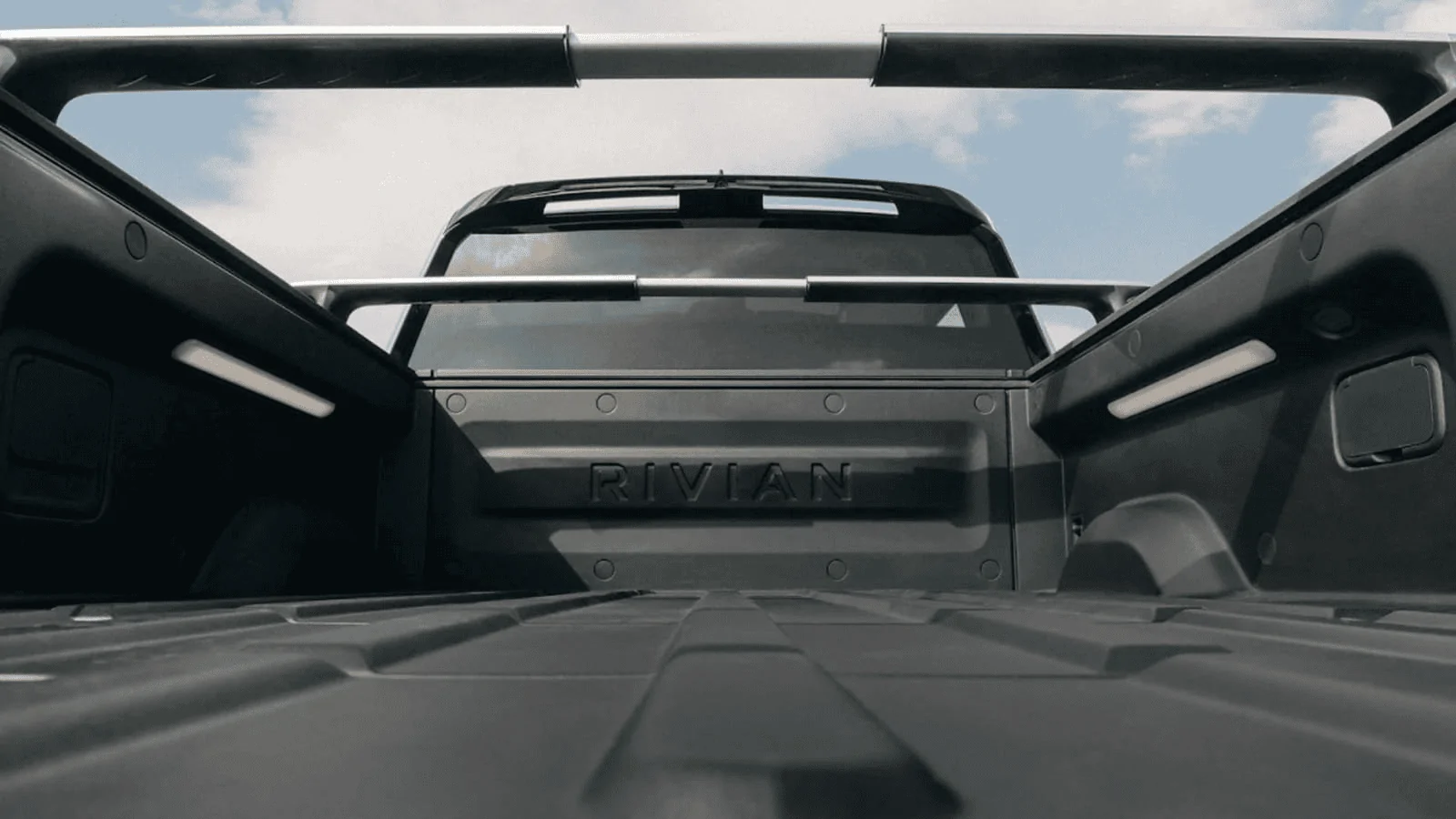

Interesting never saw that before.
Not sure if that's really a meaningful difference, all spoilers intended for aerodynamics I see have a pass-thru for air:
R1T

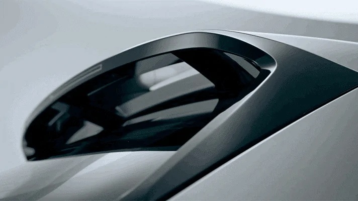

Ioniq5
Ford F-150 Lightning F-150 aerodynamics modeling 1633544211053
Here's Hyundai's reason for the spoiler:
The rear spoiler is a key component in a vehicle's aerodynamic design. When the car is running, air flows all the way to the left and right, and up and down the car body. At this time, the rear spoiler reduces the force that lifts the car due to the air under the car body. At the same time, it improves driving stability by minimizing the eddy currents (vortex) that the air that has passed over the vehicle body and formed at the rear of the vehicle. The technology to reduce the lift is often applied to high-performance cars or race cars running at high speed, and the rear spoiler of a general passenger car is mostly to increase driving stability and fuel economy by adjusting the vortex of the air. For this reason, fine tuning such as the shape and angle of the rear spoiler is required based on the concept of the car.
