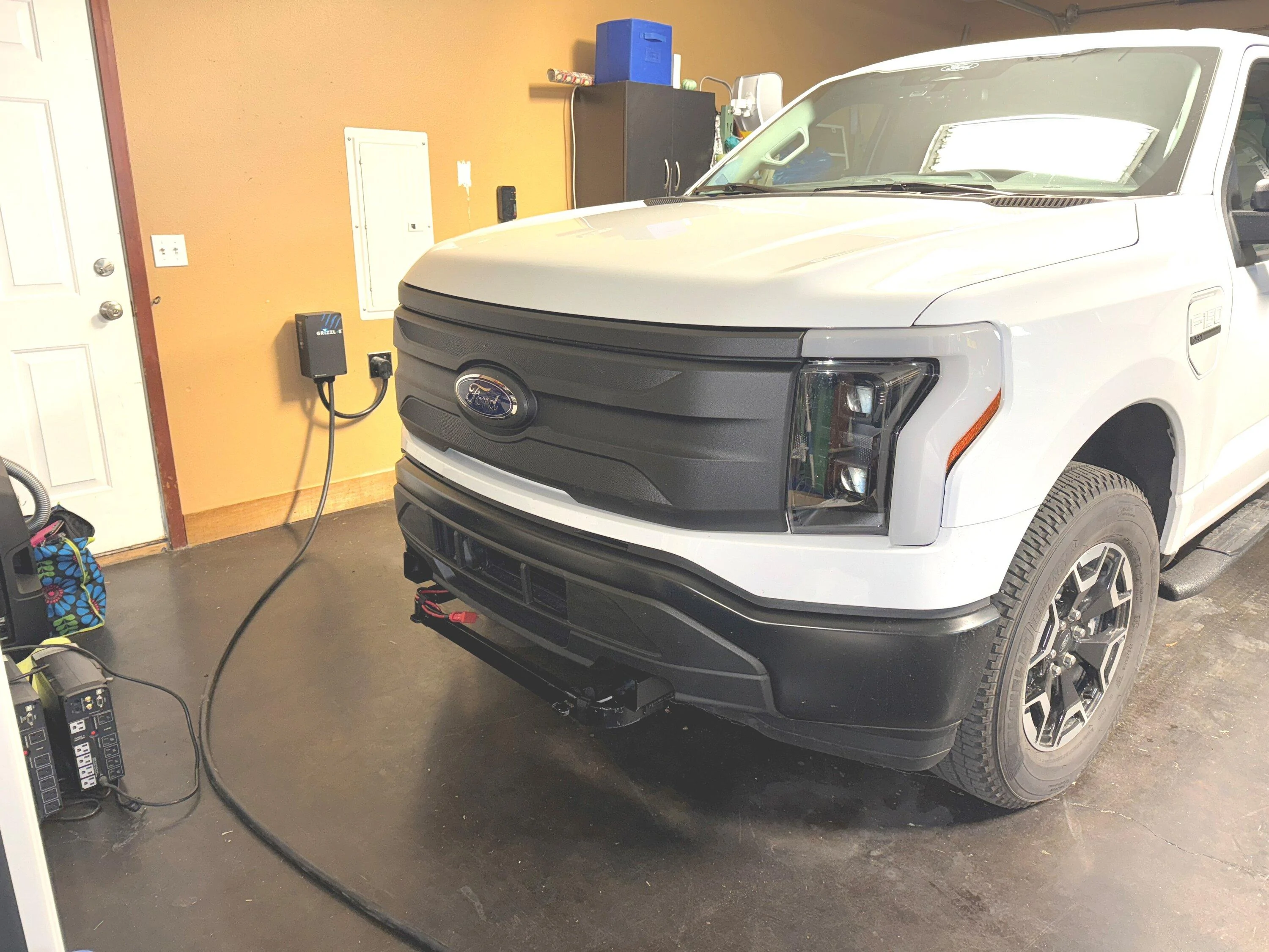

Any chance you can add a picture of the front of the truck with the mount on and the plow off? Trying to gauge the wife acceptance factor :)

Here's a pic as it sits now, with the mount on, but plow off. If you wanted to hide the cables, there are plenty of places to hide it behind the bumper.
