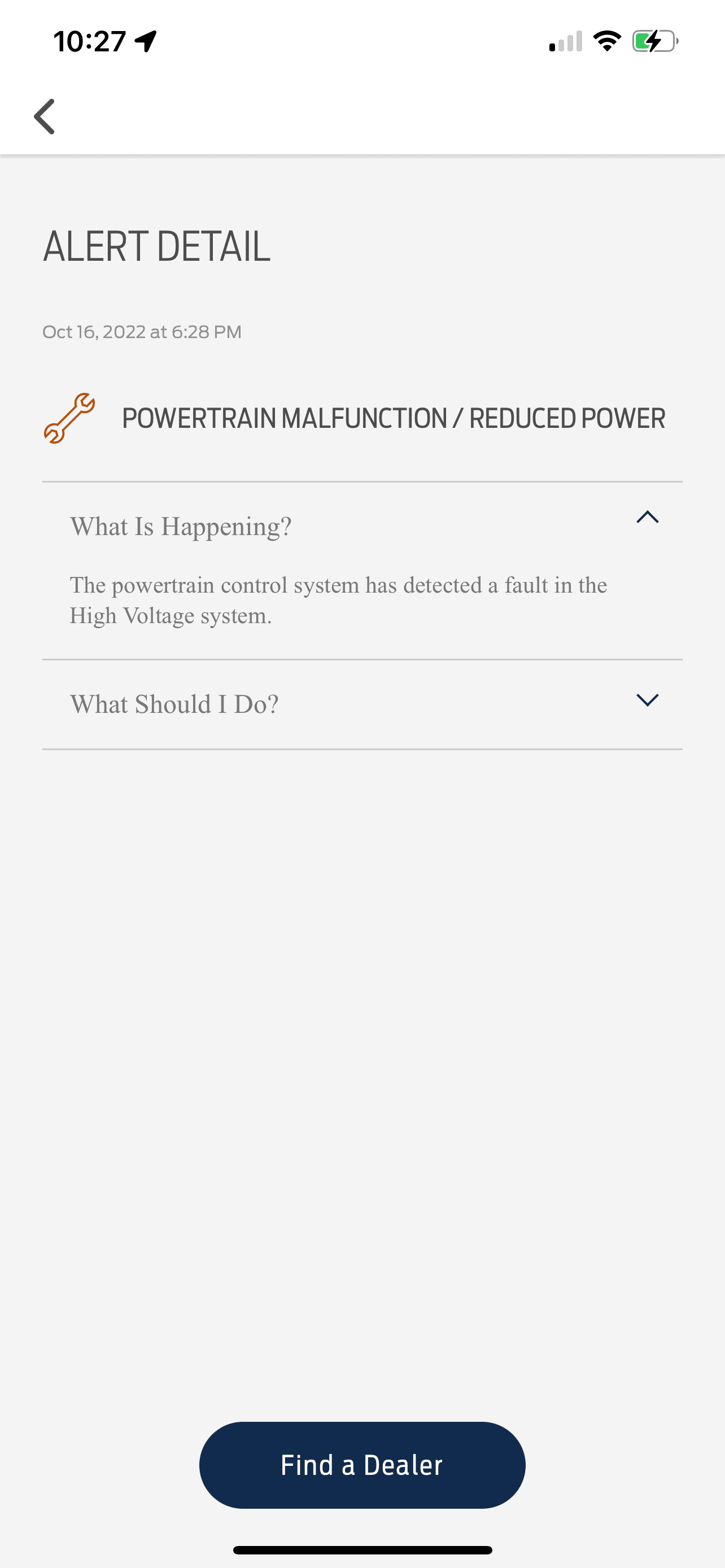

So the truck has been at the dealer for a little over 2 weeks now for the powertrain malfunction/reduced power alert awaiting a part. I received a phone call Tuesday 11/15 from the BEV team that the part was in and I would hear from the service dept at the dealer soon that the truck will be ready. Today I opened the Fordpass app and saw a new alert? The app shows shows battery charged at 100% with only 120 miles on an extended range?! And now a High-Voltage battery warning?! I am afraid now. I will visit the dealer for an update
@kWfart I think yours is the only other Powertrain issue that also has the high-voltage battery issue. Did the BEV team just reach out or did you contact them some how? I need to grab @TaxmanHog build sheet and see if our build weeks are close @Ford Motor Company may know. Just went and check both were in same month.
I contacted the BEV team to start a case and it was resolved with a cell being replaced. Since I picked up, I have not had the issue repeated. I was a little nervous to drive it from Fallbrook to Palo Alto a few weeks ago but no issues occurred!
