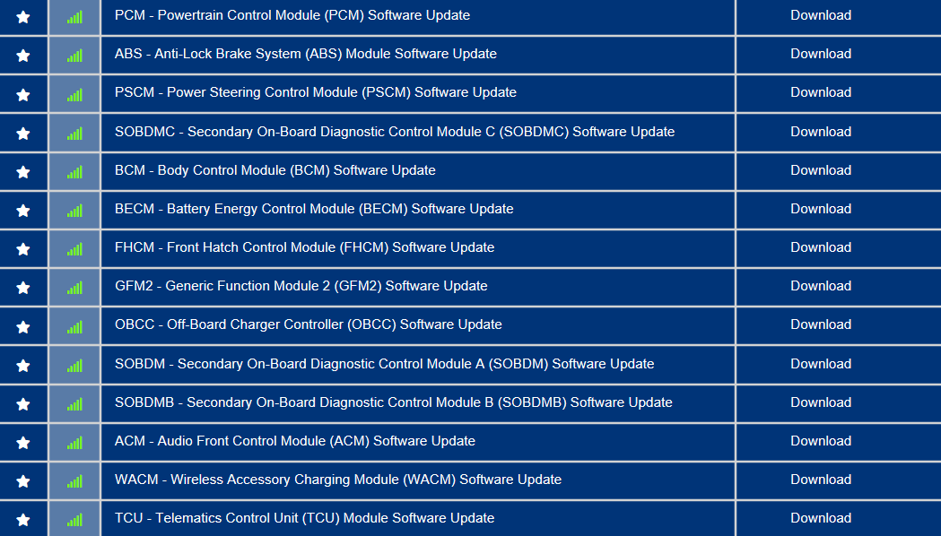

You are right @rugedraw ! They were not help and advised that I work with my service manager. I guess I just wait...but definitely concerned that the new APIM came with the latest software, but my OTA updates are still not working. I have not gotten anything since it was installed.
4,419
5,933
One thing to note - if they attempted to update the APIM and it failed, the thing will brick itself (I think in 20 days) as a security measure.
rugedraw
Javier
Dec 14, 2021
1,915
2,346
Miami
Auto Sales
It's not that black and white. They would have needed to try to run certain config programs several times and gotten several failures before the APIM locks it self out. Even then, the word "brick" is a bit strong. The APIM will still work, but it lock itself out from being updated in the future should that have been the case.
In his case, all they did to the new APIM was run the PMI and they seem to have done it right. My only concern is that his Sync version is 23159 which is VERY new and if it is TOO new based on the software state of his other modules, there could be some underlying config issues there that may cause problems with updates in the future. However, it goes well beyond my scope of knowledge to see if that is the case.
If you don't mind, I would like to share your VIN privately with one other person. I would like a second opinion on your truck to make sure you don't have any configuration issues that would prevent you from getting successful updates in the future.

I just got my first OTA update since March. It looks like an old one (23-PU0503-CON-FX), but I am thinking maybe it updated the components. Can you check again and see if I am more up to date?
rugedraw
Javier
Dec 14, 2021
1,915
2,346
Miami
Auto Sales
That is a GWM update, the the GWM is now gone from the list of pending updates:
Ford F-150 Lightning FDRS subscription 1695945956965
I am still waiting to hear back from Jesse in regards to your truck, but you getting updates go through succesfully is agood sign.
