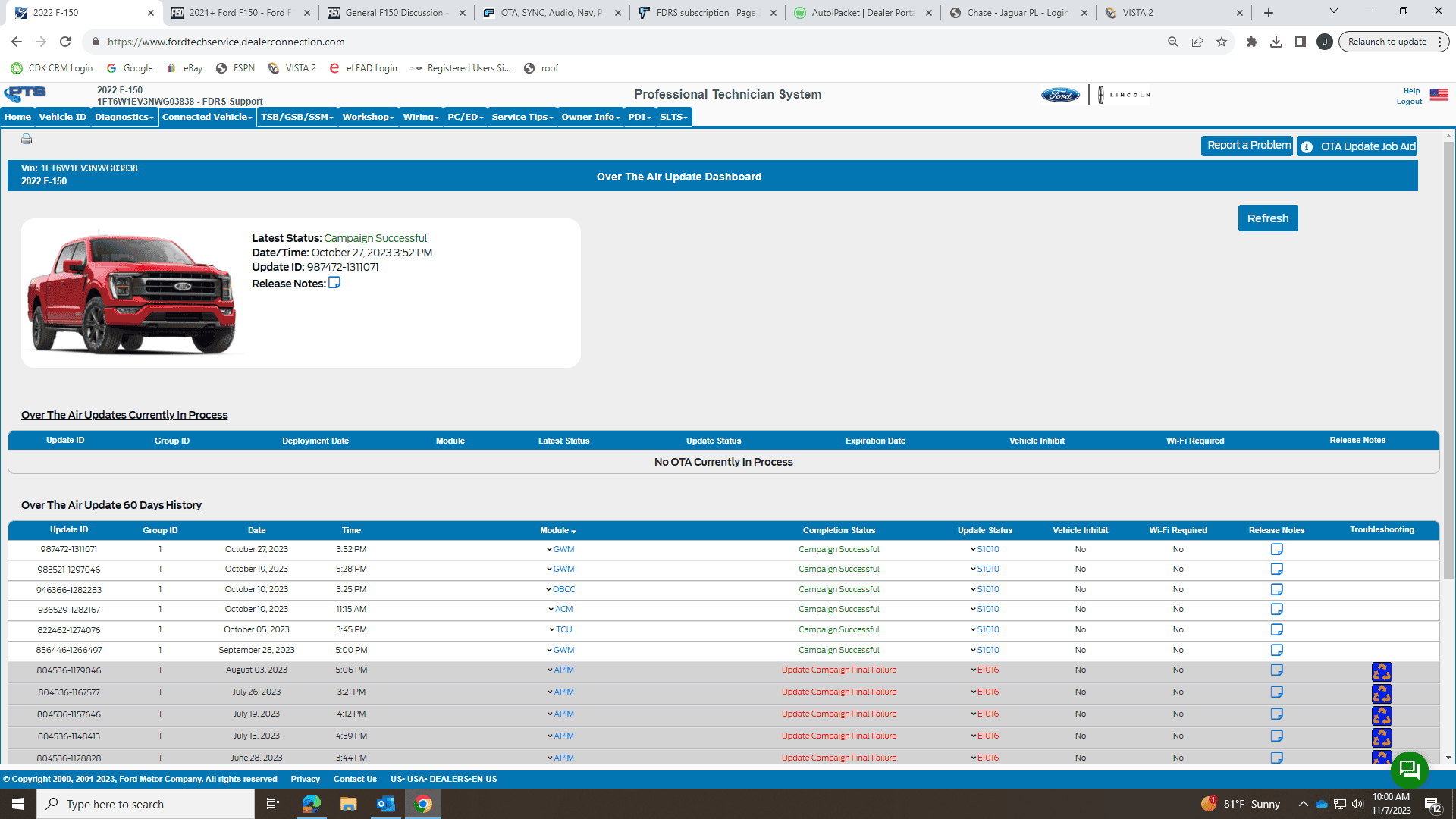

Hi @rugedraw. Would you mind running the check on my VIN again to see where i stand.
That is a GWM update, the the GWM is now gone from the list of pending updates:
I am still waiting to hear back from Jesse in regards to your truck, but you getting updates go through succesfully is agood sign.
Hi @rugedraw Would you mind running this again for my VIN? I got a lot of updates, but they stopped now.
I can check FDRS for you later when I get home. I see the updates you got sent in PTS and you still have not been sent the APIM update that failed over and over for you before. The screenshot below shows which modules were updated with the OTA's you got. You can cross those off of the list I sent you before and the rest of the pending updates will still be there.

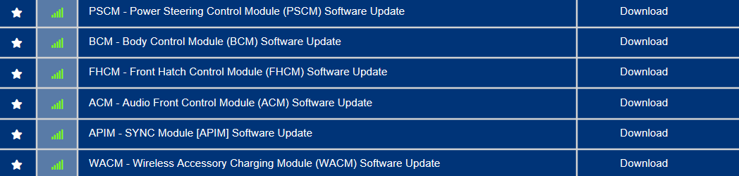

Thank you! Getting there…but still a lot of updates. Wonder how long before I am actually current.
The WACM is not available via the OTA process. Next time you take the truck to a dealer, tell them your phone gets hot while in the wireless charger and they'll update it for you.
Thank you for that tip. It does get overheated on the wireless.
