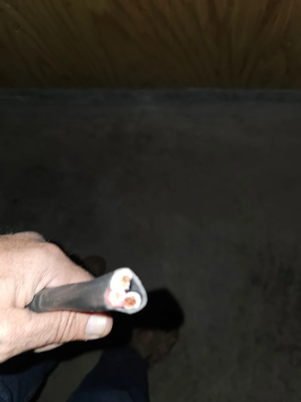

It wasn’t my house. I was advising my friend with a new EV who was having HIS new house built. He was acting as his own general contractor and the electrician was a sub contractor he hired.
When he called me and told me that the wire had been run I asked his to verify it was not NM-B Romex and it was actually SE CU cable. He took the picture below and sent it to me. It was NM-B Romex. The drywall wasn’t even up yet.
I told him to have the electrician to rerun it with proper 60 amp wiring, either SEU Copper or THHN in proper conduit while the drywall was still not up. He didn’t want to confrontation so he let it go. He told me later that he was concerned that the electrician would charge him to redo it. A GC wouldn’t have let it go. He’s just a wuss. His standard line is “ I’m not worried about it, it’s good enough”.

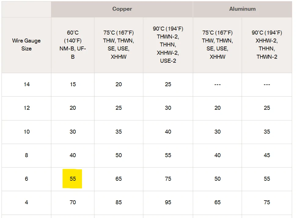

You can 100% use 6/2 romex. Its rated at 65A. If they planned on running through wall, I dont see the issue?
You're supposed to use the 60C column for romex. Seems some jurisdictions do allow 6/2 romex for a 48amp EVSE though. There's a guy on youtube somewhere in I think NJ and his apparently allows it. Granted I doubt it's going to burn the house down either way. I'd be much more concerned with people using el cheapo nema 14-50's.
Interesting! Yeah youre correct, if its typical NM cable its in the 60C column. All Ive ever run is THHN CU in EMT. Not worth risking it.
