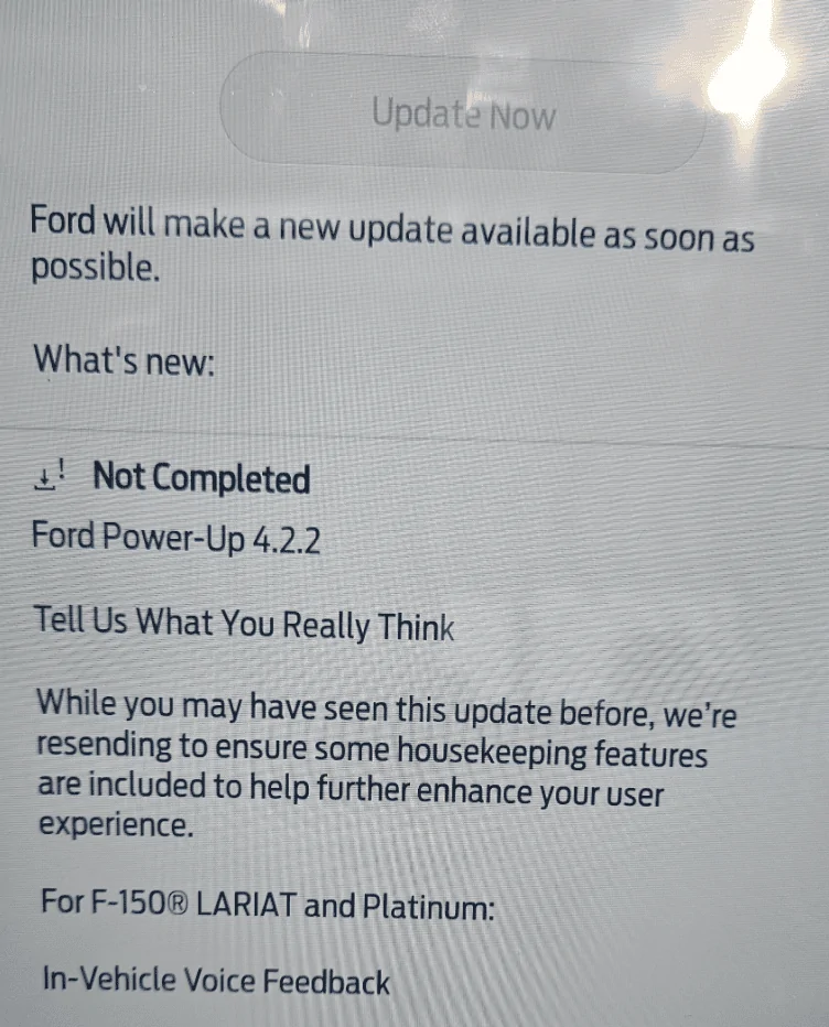

After not getting any updates since January 22, my 22' PRO mannequin finally updated to 4.2.3 on 5/12/23.
Back in April I started manually resetting the scheduled update time every day for 15 minutes after I parked at work and 15 minutes again after arriving home from work. I drive 18 miles each way to work every day.
That seemed to have helped push the updates through for me.
4/18/23 - 3.5.4
5/05/23 - 4.2.2
5/12/23 - 4.2.3
