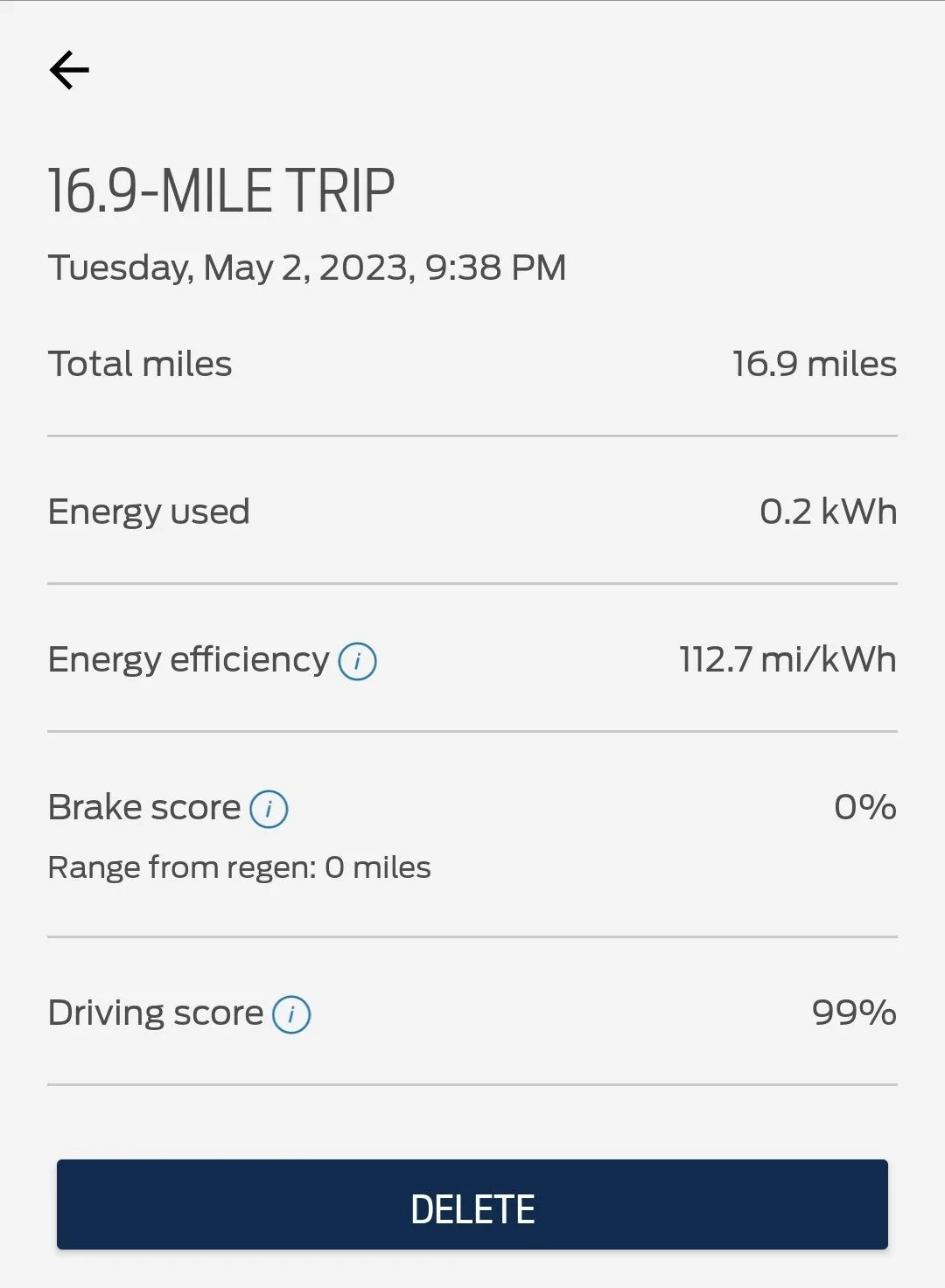

Anyone else seeing unrealistic efficiency numbers in their Ford App? Believe it is way overcounting miles traveled for some reason, leading the the bogus efficiency numbers.

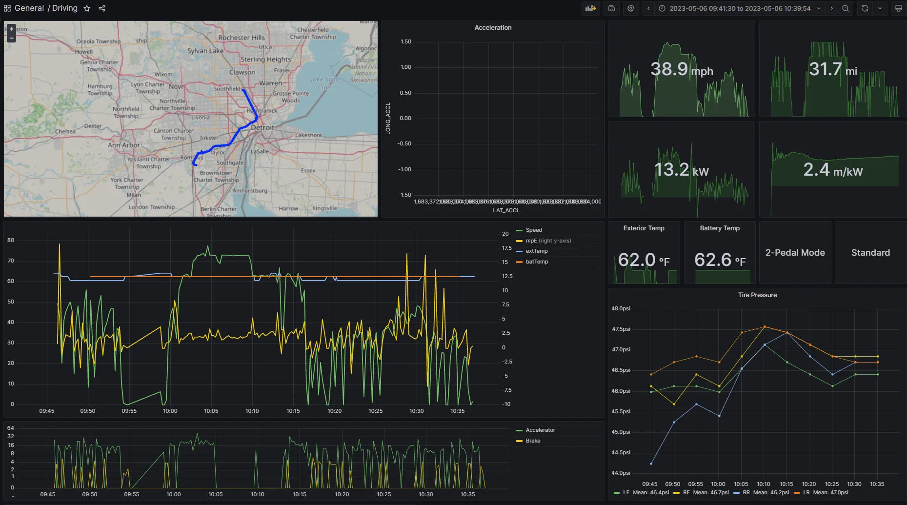

If the data is timestamped in the CSV, it would be trivial to write a script for trip logs. Definitely looking for that OBD adapter this weekend!
mr.Magoo
May 27, 2022
1,126
1,429
2022 Lariat ER, AMB
Correct me if I am wrong, but you can't simply use an OBD adapter, and Car Scanner, and pull up stored data showing that, correct?
You can't pull up the data for a trip from a week before you connected your box, right?
Well, yes and no.
You're right, there's nothing saved in the vehicle that you can access (that I know of anyway) after the fact.
But as long as you have Car Scanner connected/running, it can log anything you want and write that to a timestamped file that can be exported to graphs in the app or to a CSV file (example below).
This file can then later be used in Excel.
There's no good way of logging "real-time" energy use (that I know of), plus the speed of the interface wouldn't allow you to get the granularity to get accurate enough readings, so the easiest way is to look at "mpE" is the estimated amount of energy (energy, not SoC) left in the battery and simply divide distance witt that energy.
I do it this way in my black box and the result matches what the car/ford pass says when they get it "right".
[EDIT] And before someone corrects me...
Yes, theoretically you can look at the volt/amp on the battery pack and the LVB and figure out the usage and potentially convert torque/rpm readings on the motors to kW, but you're only logging so fast and each log value will be a snapshot in time vs. accumulated change since the last time so for this to work properly/be accurate you'd have to log every 50ms (millisecond) or so (which OBD isn't designed to do / handle) instead of every minute or in my case 15s.

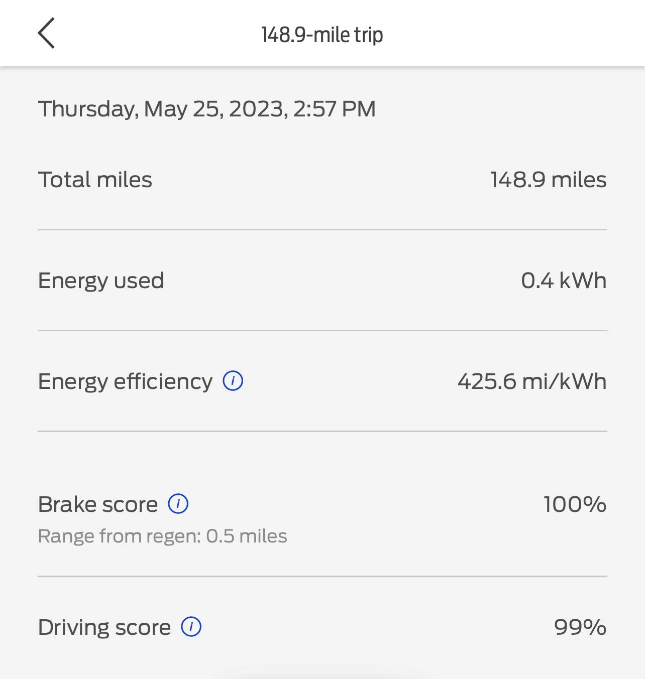

Here''s a screenshot from last week. I'm pretty sure in this case that I didn't turn off the truck at a fast charger, but rather moved it away from the charger and parked before I shut down. So FordPass only looked at the state of charge when I started up, the state of charge when I shut down, and concluded that I had somehow driven nearly 150 miles on a half a kilowatt-hour.
Ford F-150 Lightning Ford App overestimating Efficiency IMG_3892
114
7,206
9,869
No, it just didn't reset the mileage. And it used the 0.4kWh that you used to drive the less than a mile. Happens all the time.

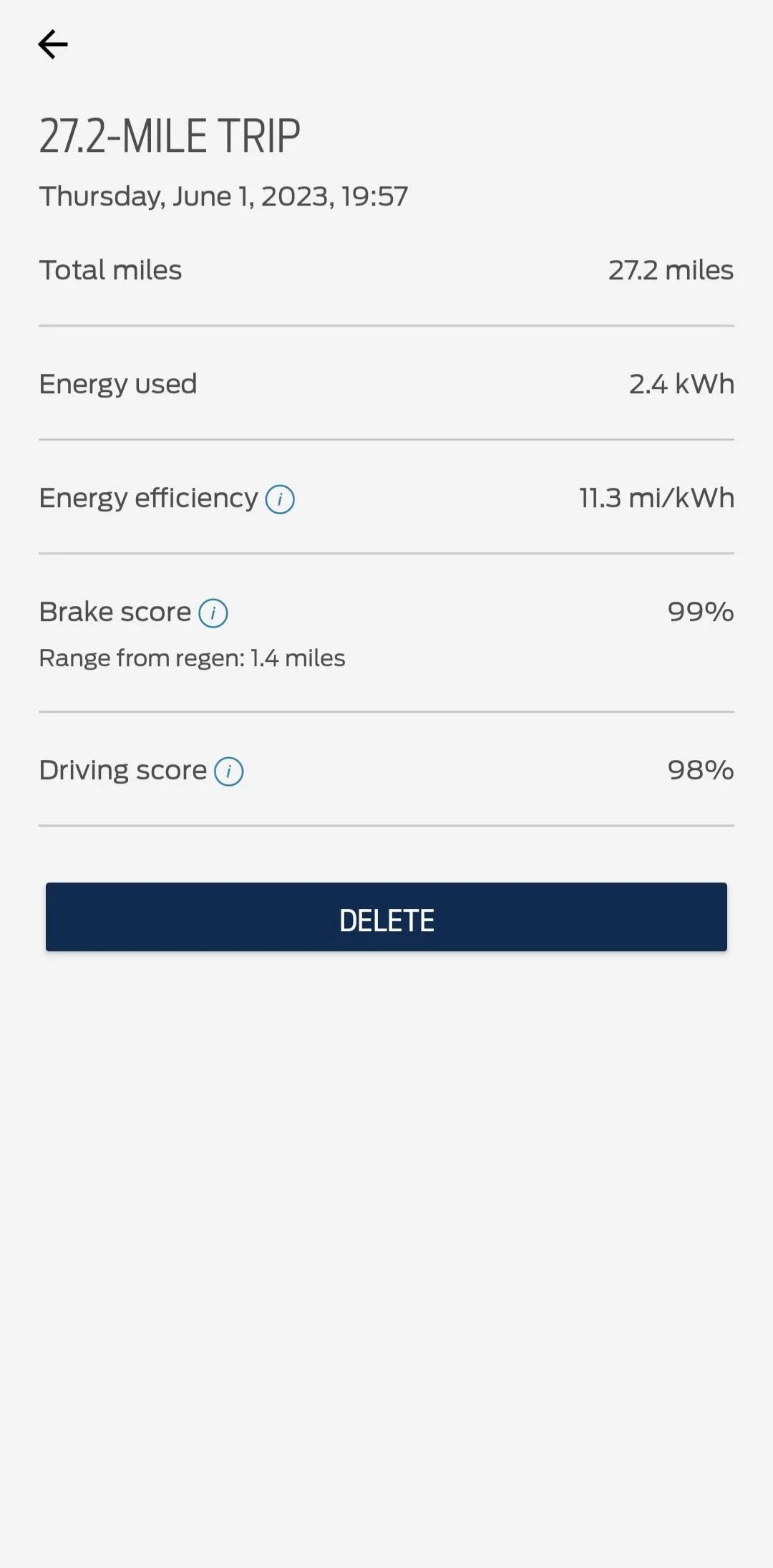

and here's my trip report from pulling into the garage (it used the mileage from the previous trip and energy use from pulling into the garage).
