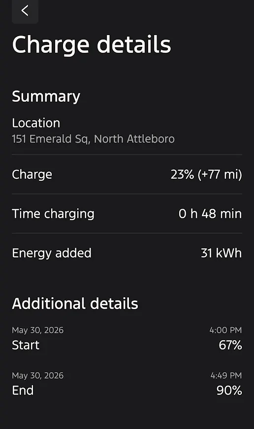

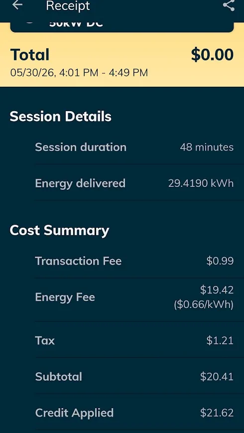

I don't live close to an Ionna DCFC but was curious how data reporting accuracy is with other systems, so I took advantage of the EvGo memorial day free credits this afternoon, at a 50KW terminal at the local mall in North Attleboro, Mass.
The EvGo sales report shows 29.419 kWh delivered, while the final charge record in Ford App showed 31 kWh, funny that it's slightly more than the provider says they sent, ironic.
Ford F-150 Lightning efficiency losses 1780182232313-9q
Ford F-150 Lightning efficiency losses 1780182356808-xs

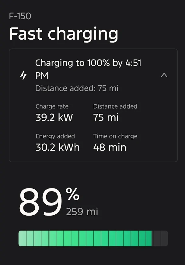

This was a snap shot of the in process session screen from Ford App at 89% only 30 seconds or so later went to 90%

All of the heat generated in the battery during charging is resistive heating (watts of power dissipated into heat) and then the cooling system has to expend energy to remove that heat. One reason the Lightning throttles charging over 80% state of charge is that heat generation (battery resistance) increases greatly over 80%. Keeping your DC charging below 80% will vastly reduce the difference between stored and delivered kWh and save you money. đź’°
I was at a memorial day memorial service that was just down the road. I left the truck on the charger until it was at 96%. That last 16 percent must've been the extra loss.
